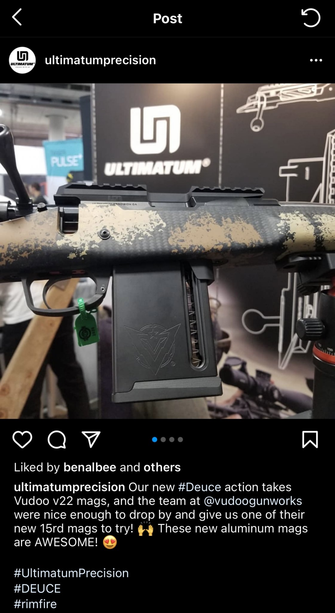

Aren’t they compatible with Vudoo mags? That’s one of the selling points for me - if not, I may need to reconsider and go with a Vudoo or RimX instead.
I wonder if the changed it since first release... this has me seriously reconsidering the Deuce.
Part of the reason I was initially interested in the deuce was to use existing vudoo mags I already owned and be common among multiple rifles, instead now I’m stuck buying mags at $140 each that take three months to get so be aware
Idk what happened between that video and now but none of the 20 or more vudoo mags I own or tested will feed, they all have the same problem, round sitting too low in relation to the chamber causing misalignment and when the bolt comes forward the nose of the round is pushed into the conical area just below the chamber causing it to jam and deform the projectile
The issue being the feed lips on the mags will not go in deep enough to the action to align the round vertically with the chamber
The deuce mags fix this by using a two stage adjustable magazine

What kind of chassis are you using? My Bergara in my MPA chassis had the similar issues. MPA makes an adjustable mag release which allowed me to adjust the magazine to be held higher into the chassis - no issues after that. Is it worth exploring?

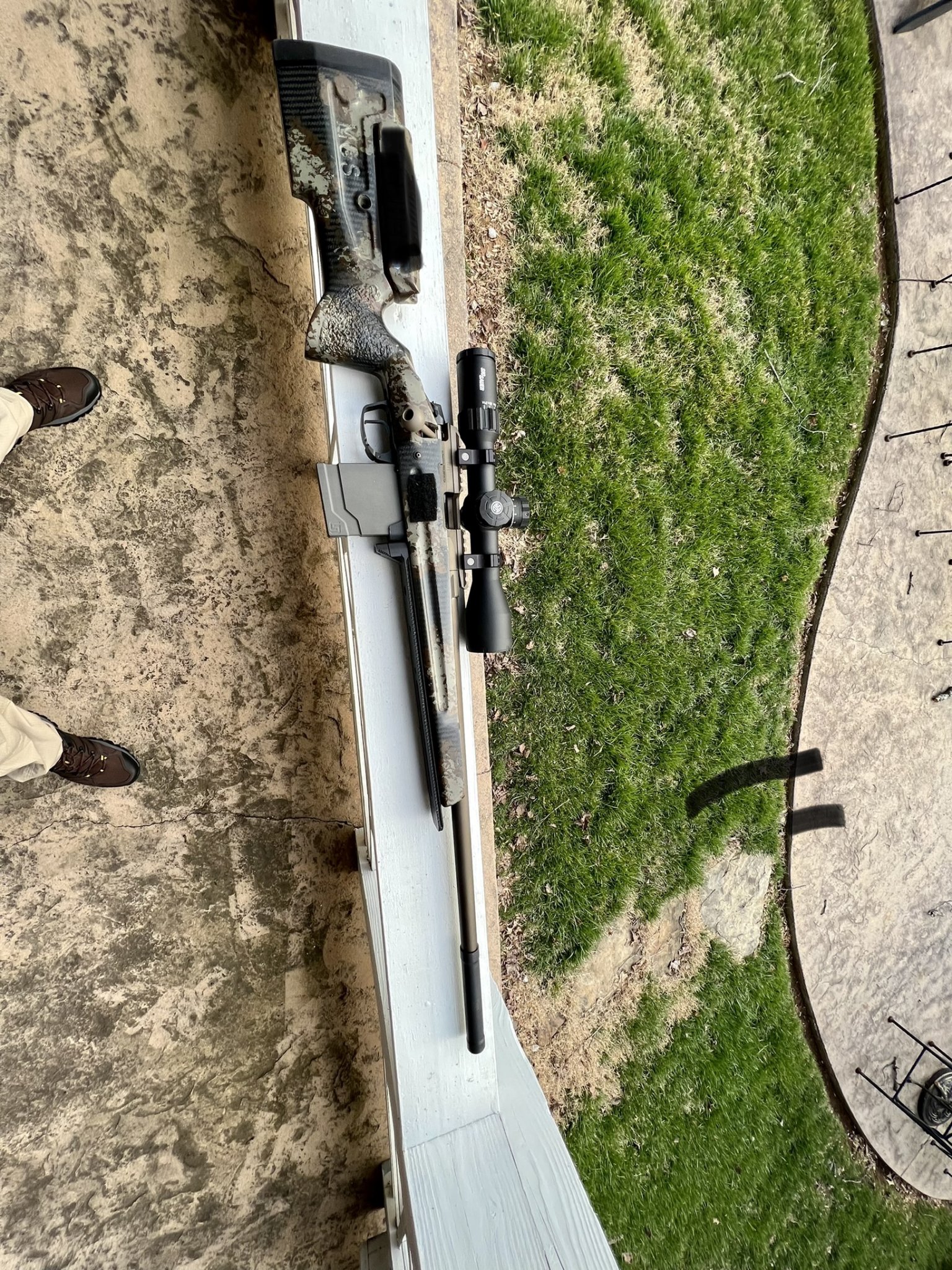

If you file the back left edge of the Vudoo aluminum mags, it will fit in the Deuce correctly. If you look at the Deuce magazine, you'll notice the back left edge is basically sanded off for their mechanical ejector system I believe. So if you want to modify the Vudoo magazine to sit higher you can.
I got the Deuce because my 360 was taking forever... then of course my 360 shows up the week after my Deuce, so now my Deuce is just a backup rifle that I never use. I do have to say I have zero feeding, extraction, ejection, or mag loading issues with the Deuce.

I thought the whole point of buying a rifle that is advertised as using vudoo mags was to not bastardize the mags to make them usable
Had the deuce action in a few different chassis to try out, then when the feeding issue was noticed I tried each again more carefully and it was a no go in all, same issue
Started with testing on ACC, for fun in the AXSR, and it’s real home is a TCS
