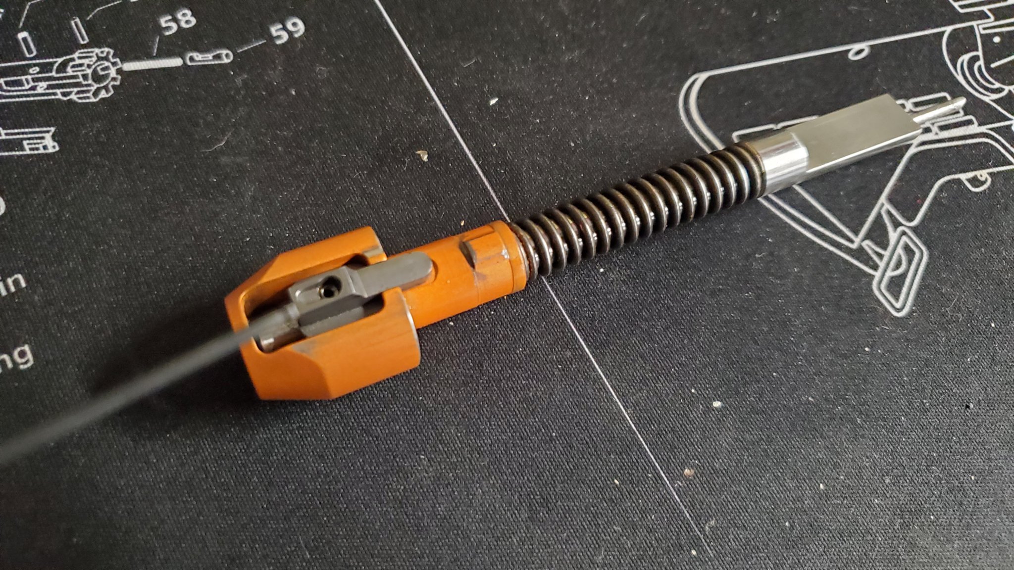

    I received a new firing pin spring from Vudoo.
    What size Allen key I need to remove this set screw in the bolt nose?
    I cannot for the life of me figure it out. I watched every video on the Vudoo site and I don't recall seeing it anywhere. Maybe I missed it.
    Please help.
    I know for sure it is nothing that a normal person would have fro. anything else that we'd all use for our triggers or other small bits. (i.e. it's not 1.5mm or 1/16)
    Please help.

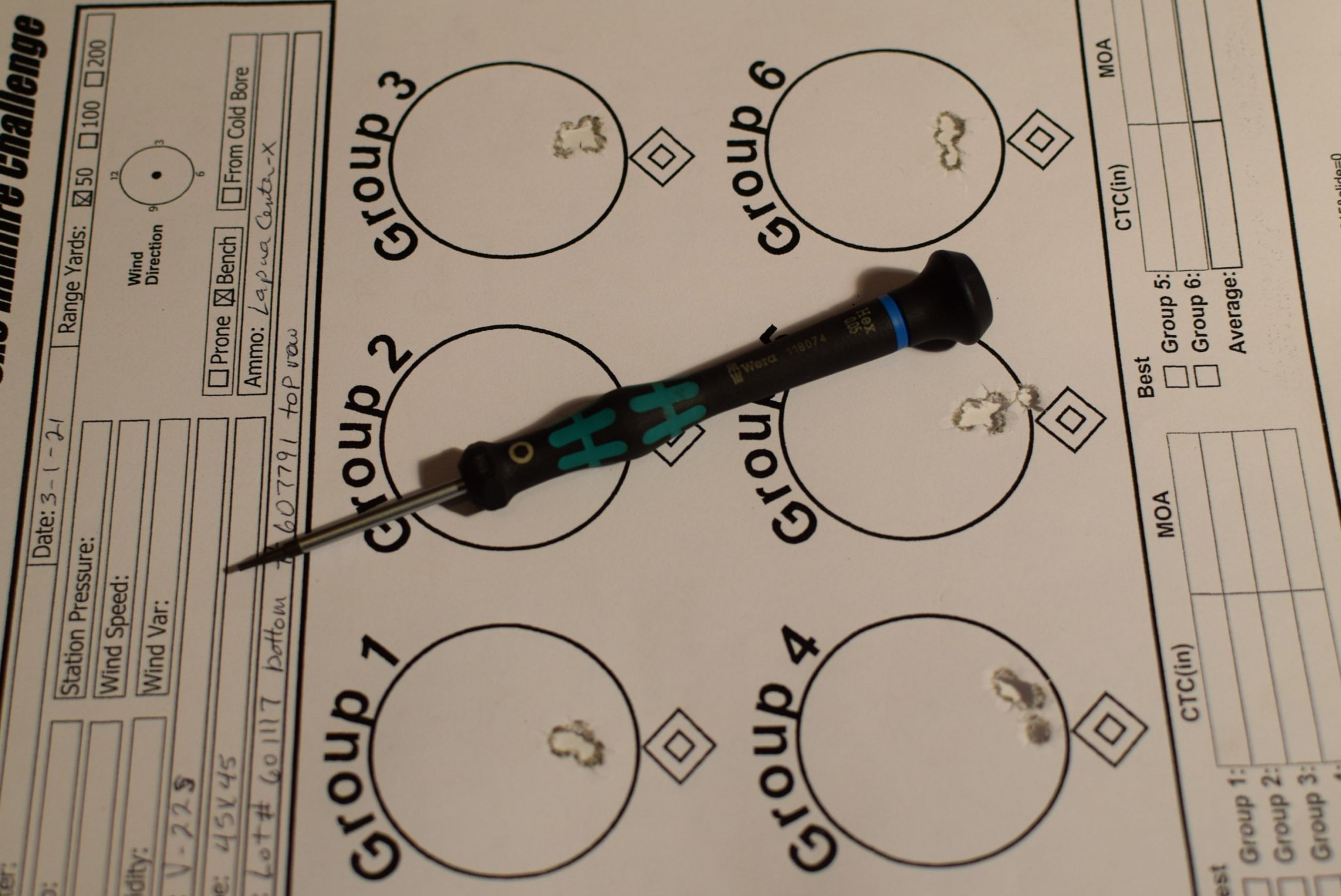

    I posted photo of the hex driver I use on my 360 & V22S actions' firing pins. It's a Wera brand in .05mm, #118074 - I bought two of them from MSC, the supplier I use for many of my machine tool parts (carbide insterts, tools, etc), stuff you won't find in your local hardware store. I've bought some Wera T10 torx drivers, and have never had one twist or strip like several of T10 drivers I've bought at auto parts stores - they're good stuff. I've used these drivers a lot while dinking around with the five different striker springs that come with the V22S single shot actions, and haven't had any issues with either the drivers nor the tiny little hex screws that hold the striker assembly together.
    Here's a photo again -

    I would just like to clarify, for myself and any one else who might need this information.
    I looked up the Wera 118074 and it appears to me to be ,05 inches, not .05 mm. What say ye? @flatland1
    My bad - and I knew better. The Wera drivers aren't marked either inch or mm, they just say 0.05, not sure why I wrote mm... And that size was mentioned in the video on changing out springs on the Vudoo website. The one I'm referencing is with Mike Bush, and I don't think it's still on the Vudoo site. However, there's another one on how to reset your bolt without tools that also mentions the 0.05 allan wrench.
