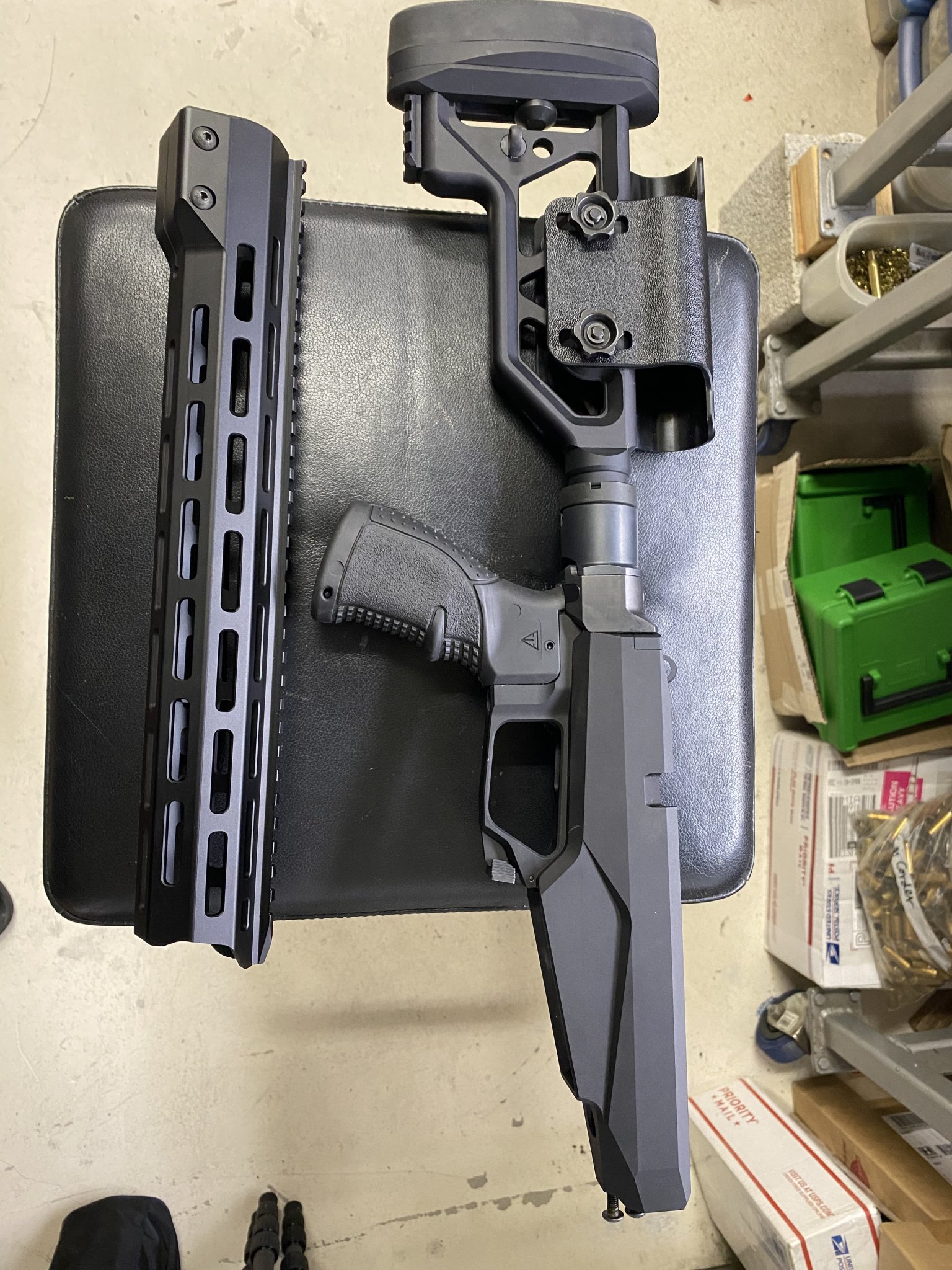

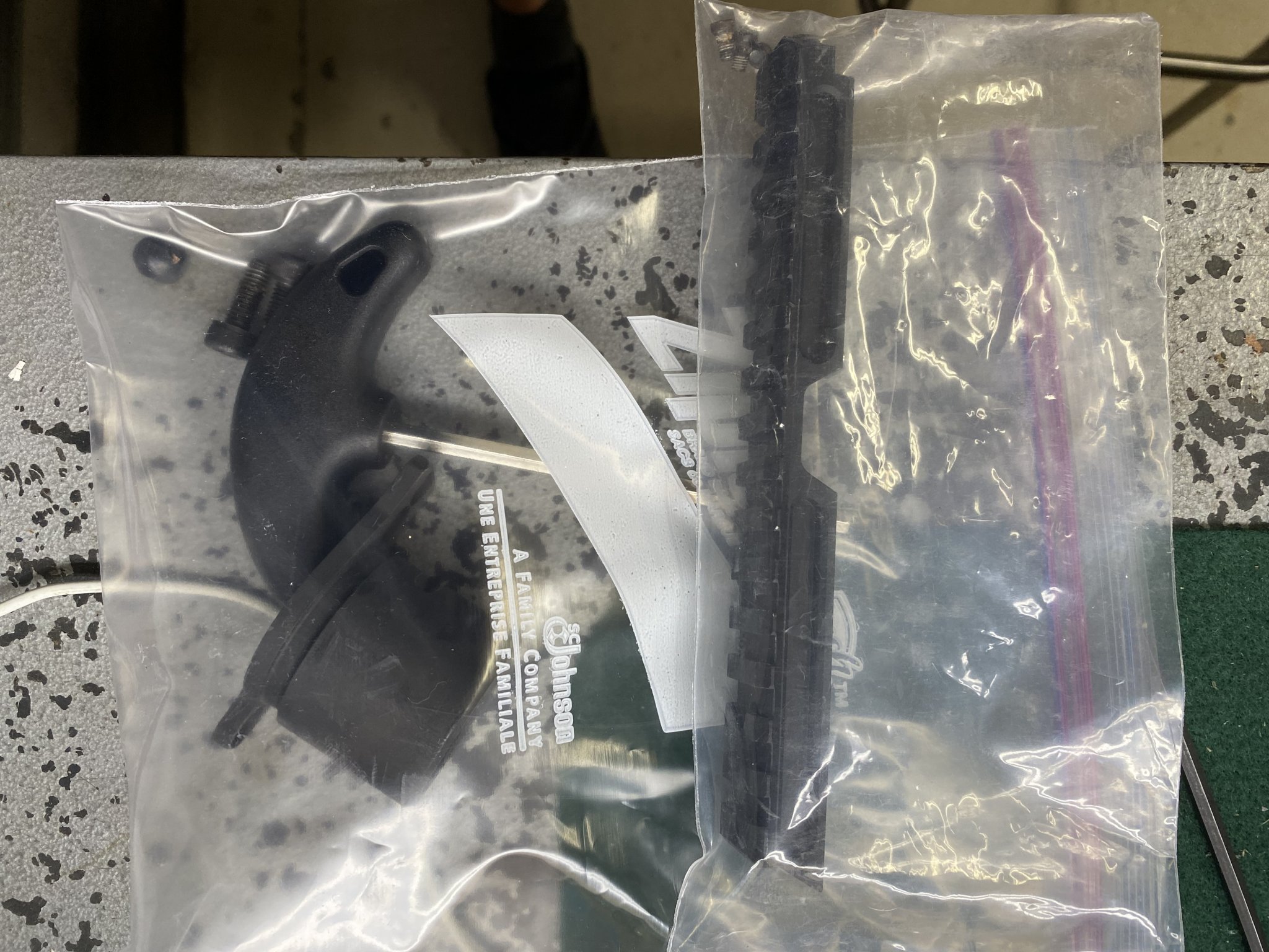

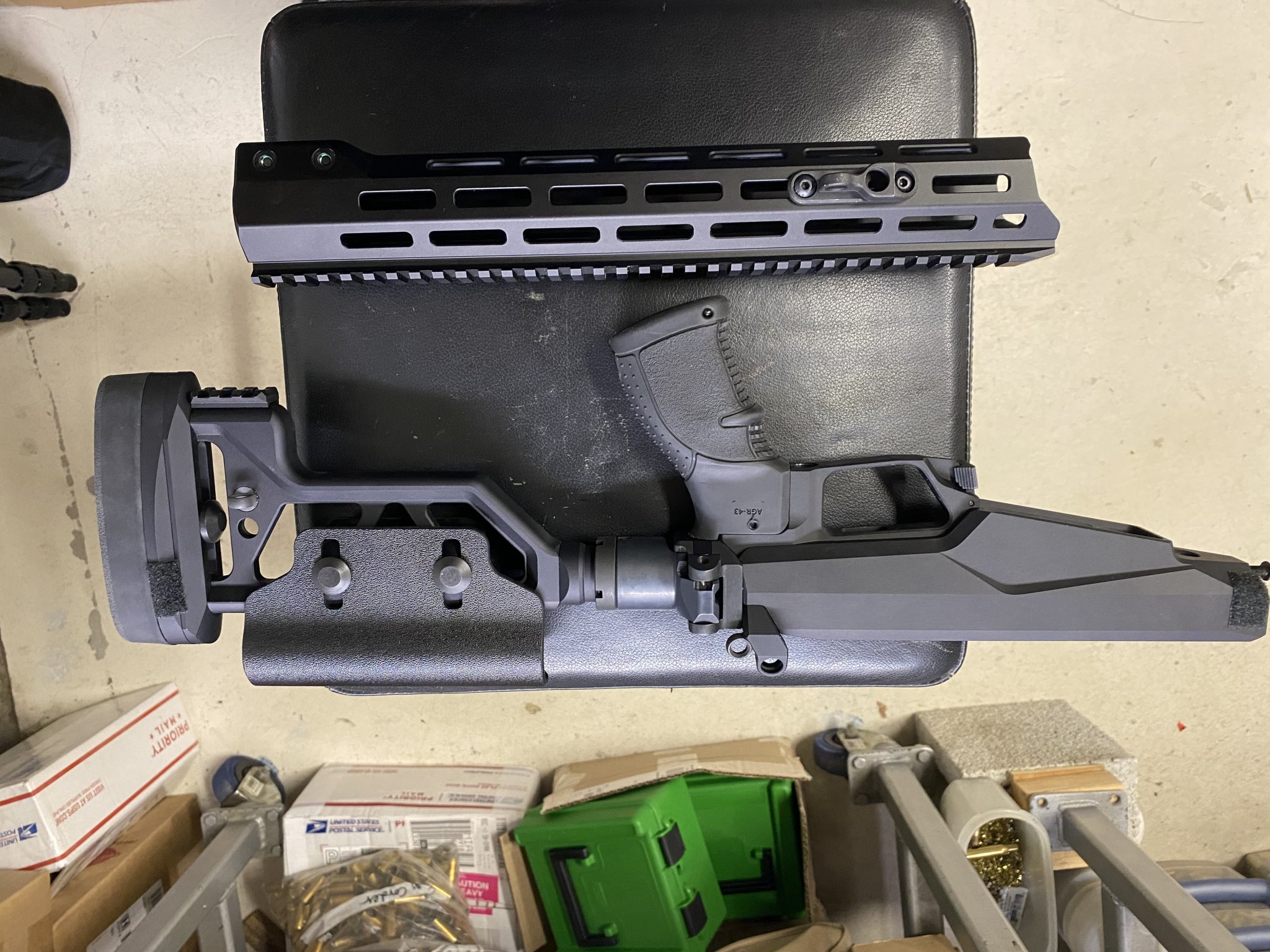

Hello,
I have a factory Tikka T3X TAC A1 chassis for sale. Complete chassis with scope rail, no magazines.
Nothing wrong with it just switching things up.
$550 shipped and insured, discrete pp f&f
4AA689F1-57C5-47E3-9D9E-4976705B63A7.jpeg31760EDF-50B0-4FFC-BC6B-53B85931C9AF.jpeg8A1B0EF5-0A61-4B2F-A942-32F1E303F70A.jpeg

So, in order to use the TAC A1 stock, you also have to have the T3X TAC A1 pic rail. The forearm is attached using a bolt that attaches to the pic rail, and another to the stock hosing.
Nope. It’s likely the same. More than likely, he would have to have swapped out his rail as well to properly use any other chassis for the T3X.
Reactions: Trent A
Is that different from the scope rail that the OP mentioned would be included?
actually, that being said, I would make sure I got new bolts when I put it on the receiver. (new Picatinny rail bolts) I would also install them with some blue Loctite. in fact, I would use blue Loctite on all the bolts as you’re putting them back in to the new chassis.
