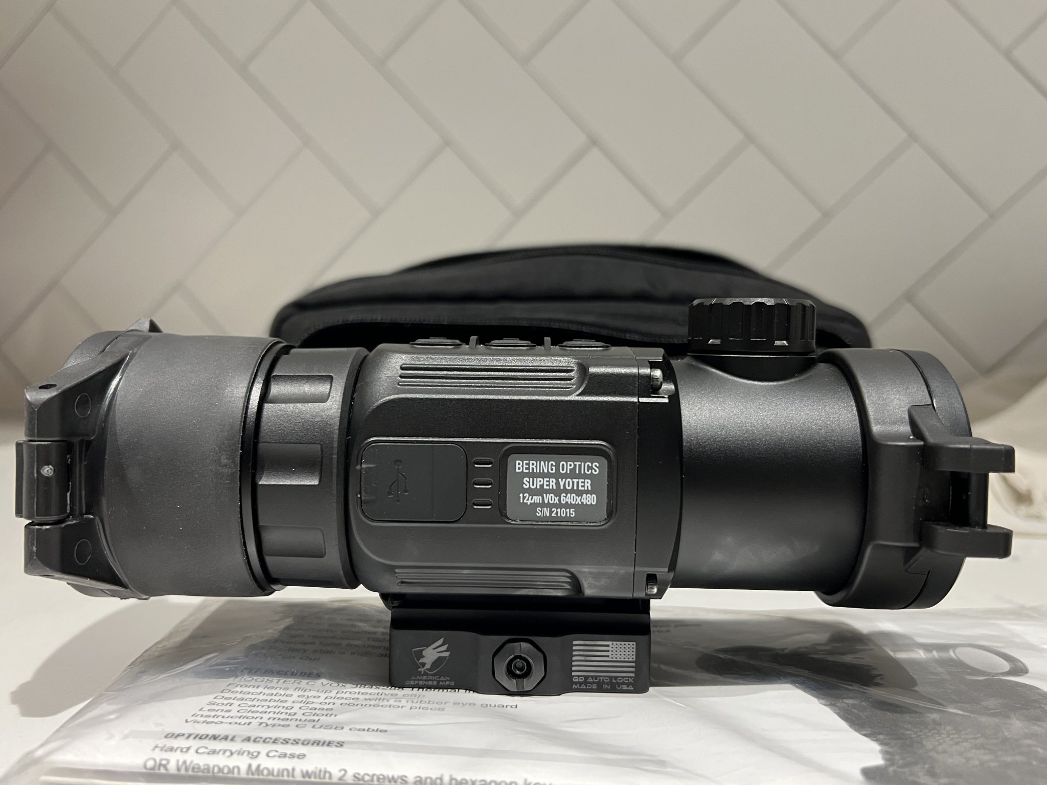

WTS/WTT Super Yoter-C w/ ADM QD mount and Vortex lens cover $4200/shipped & insured. Will trade for Thermion XG50 or similarly spec’d thermal (Halo LR, RH50, etc) + cash on my end if need be. PayPal FF, Venmo, or wire transfer.
640x480
12um
ADM gives 1.5” optical center. RTZ is excellent. I haven’t had it shift.
Image is superb. Can’t beat it unless you want to spend $12K-$16K.

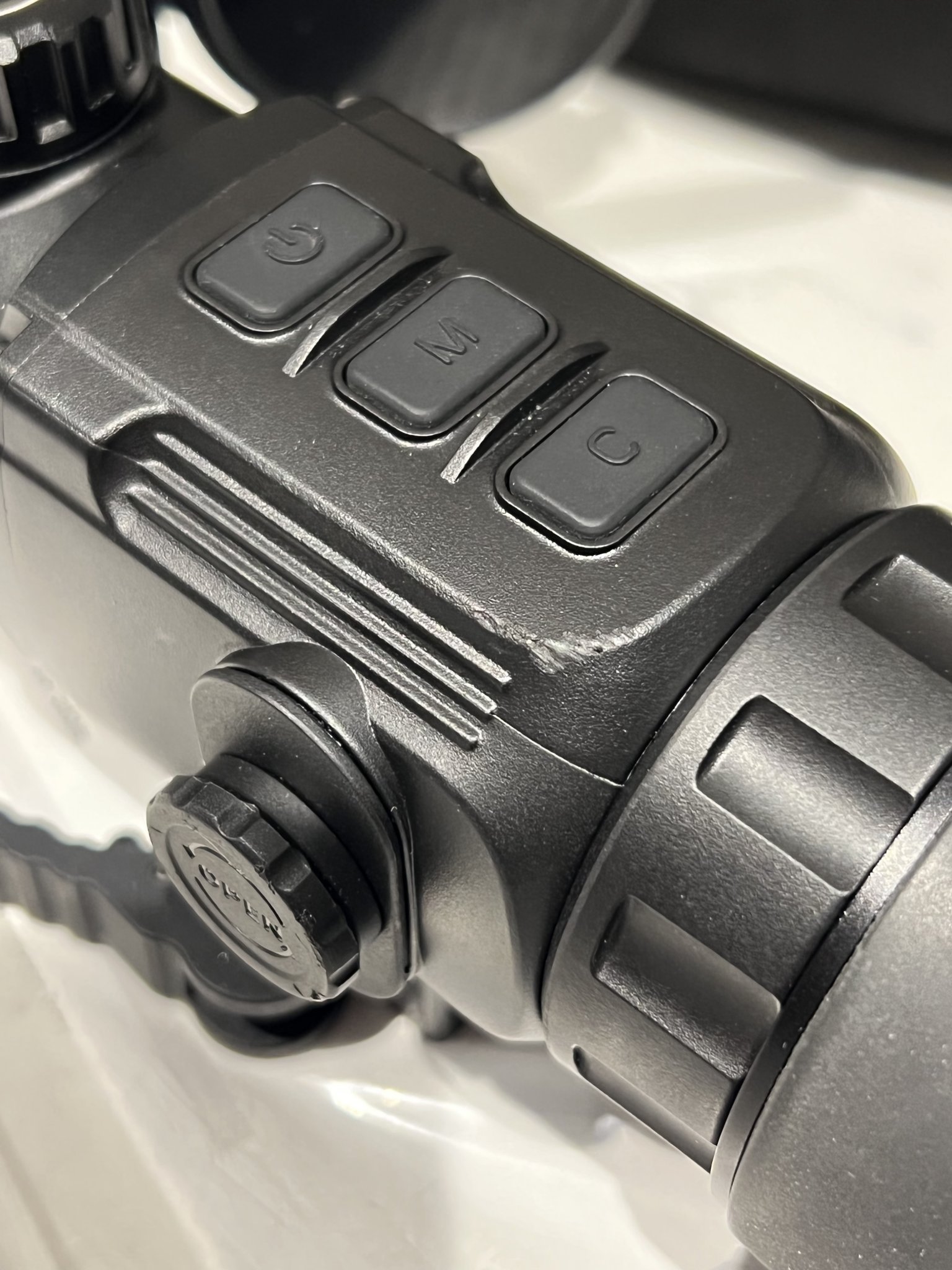

Has small rub mark on the housing as pictured. Otherwise it’s like new.
I purchased it in September. Only reason I am selling is because I’m wanting to try a dedicated thermal weapon sight.
Make me an offer.
Thanks,
Chase
