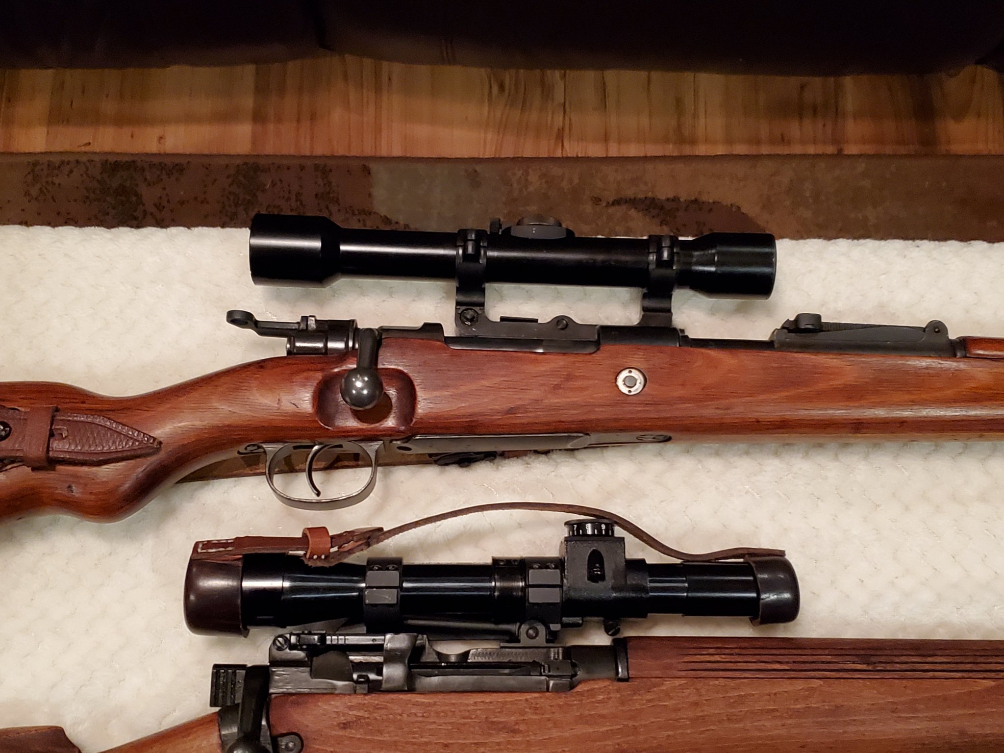

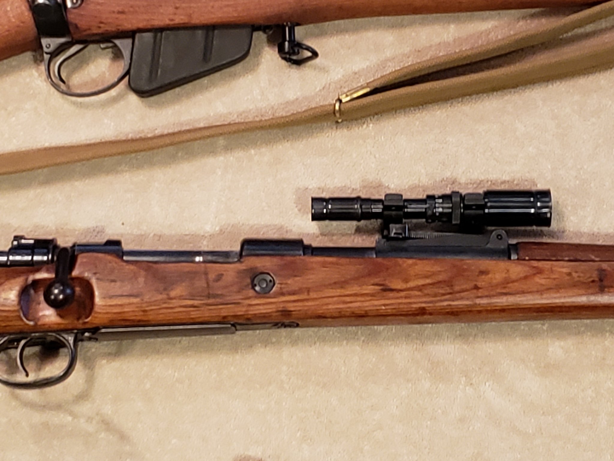

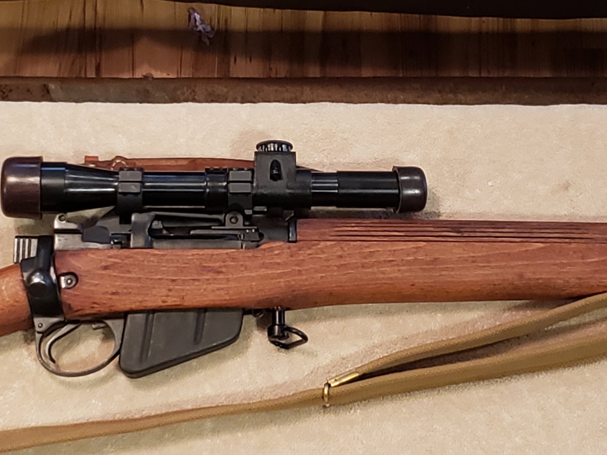

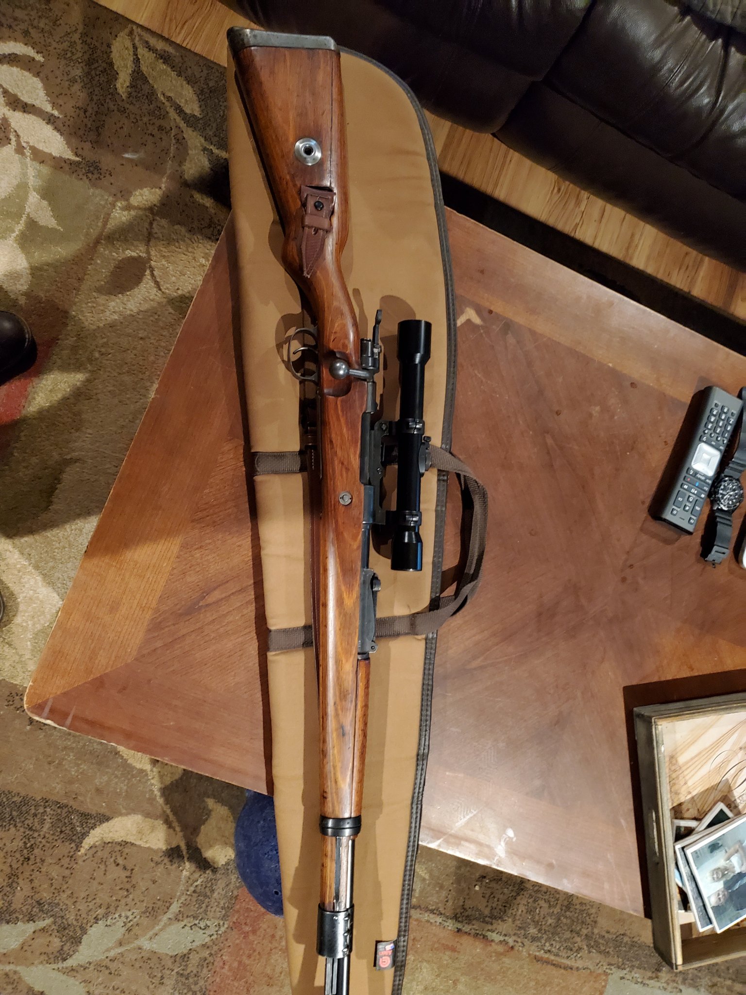

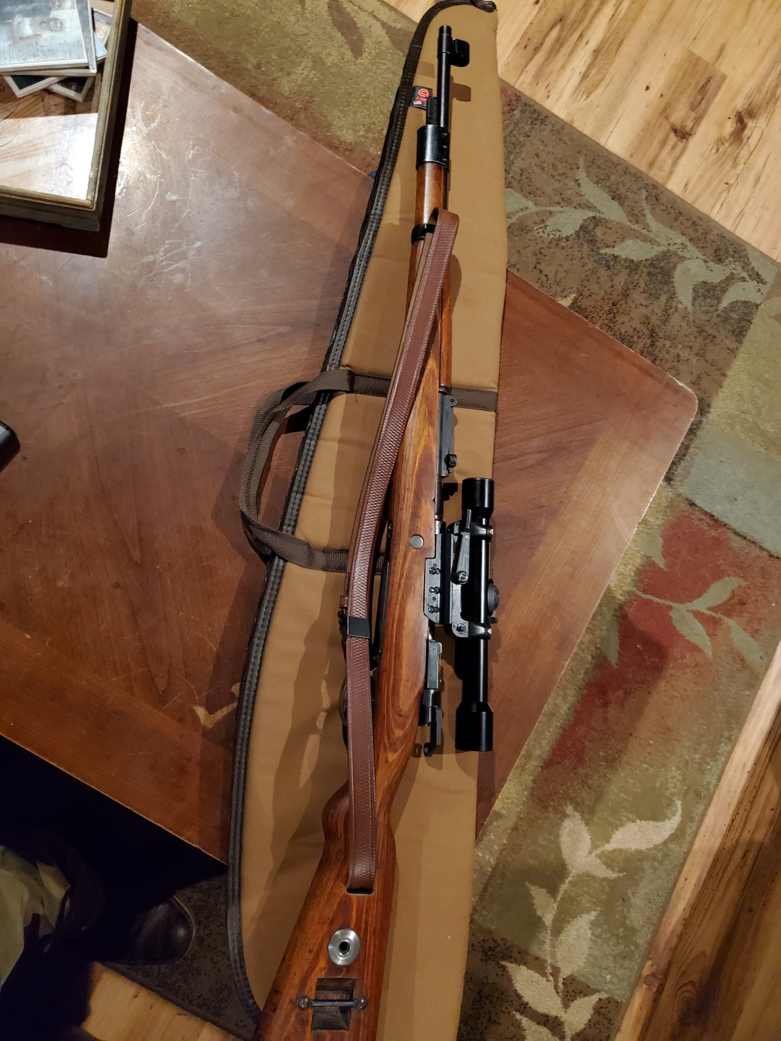

I got the vintage sniper bug last summer. Just finished my k98 lssr zf39 this week.

Wow.
Very well done.
I really enjoy time at the range with WWII era rifles. My father in law has a Mauser and I have a Mosin and both are still great shooters. Neither is in the condition of yours!!!!
Even with all my firearms edumacation... I am not sure if its perfect or lacking or close.... Others here can attest to the accuracy.
But none of that matters. Because perfect or not that is an amazing collection... well done! Outstanding and thanks for posting!
Great collection and I am seriously jealous of the kit you have put together! And that is saying something. Well done!

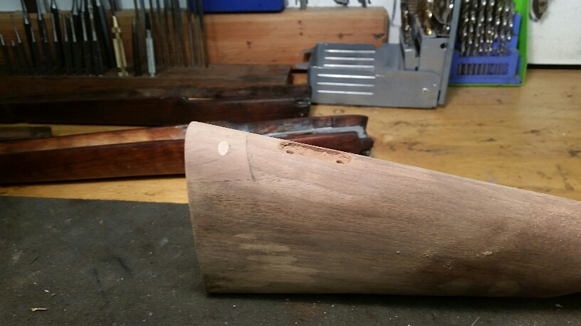

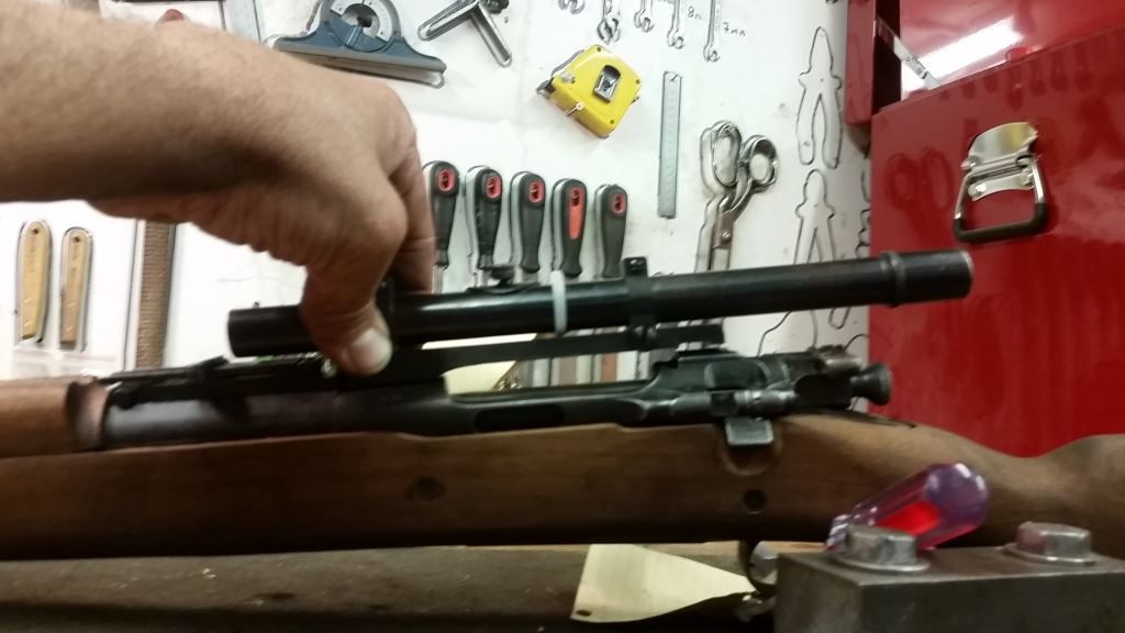

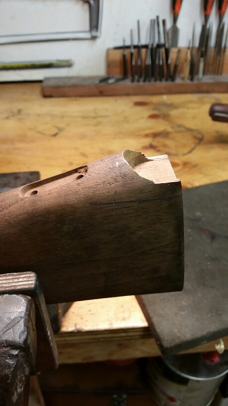

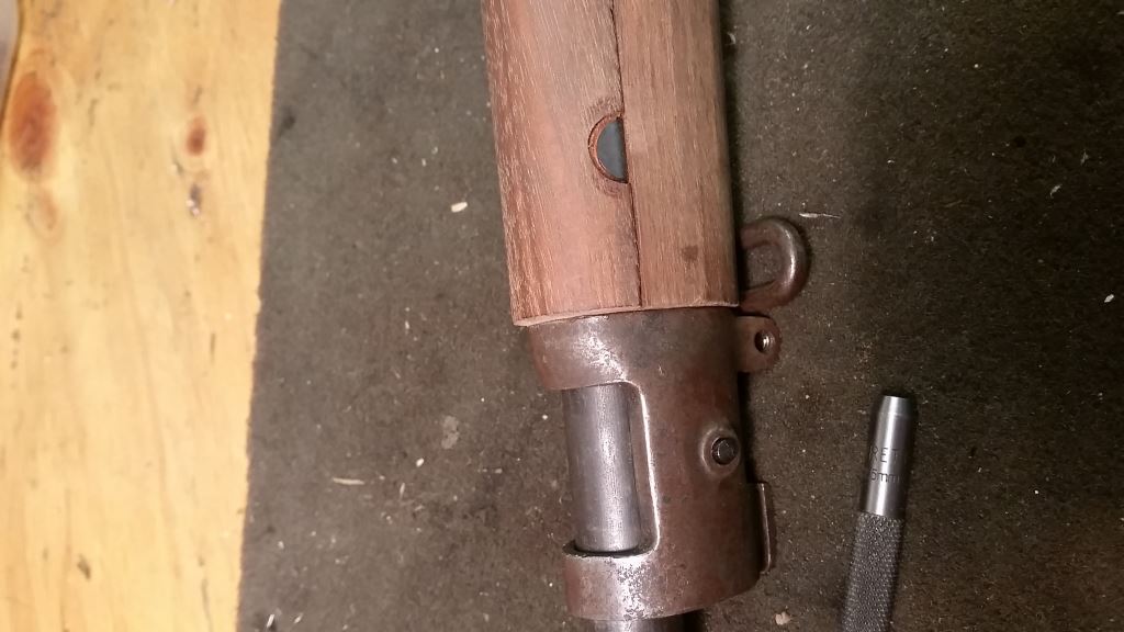

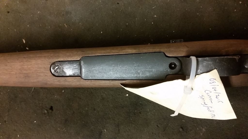

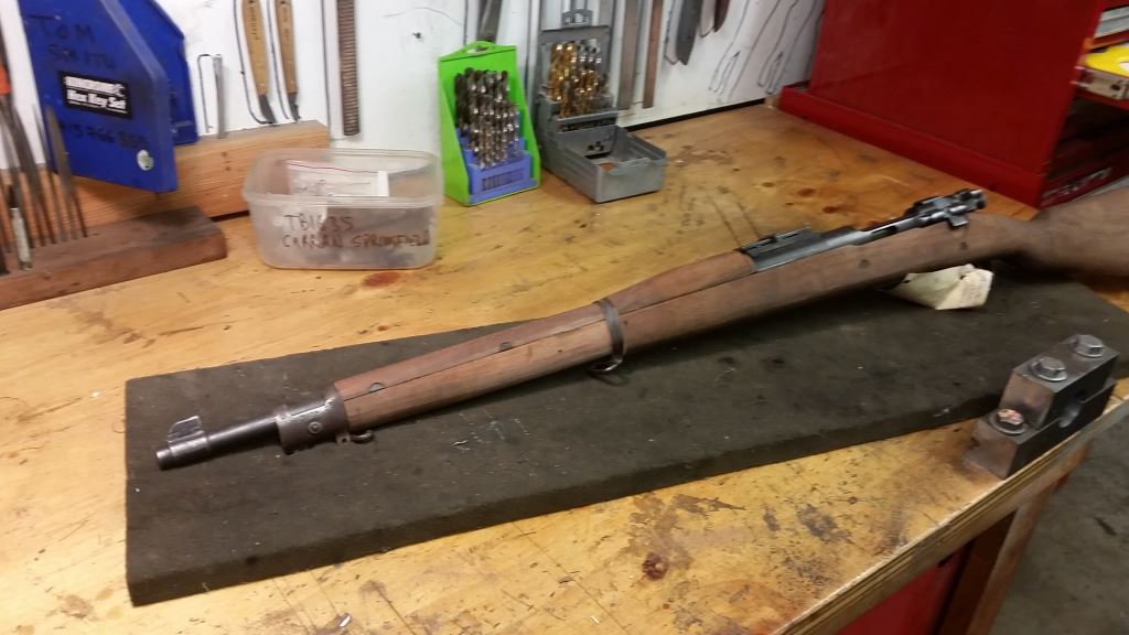

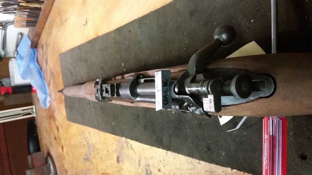

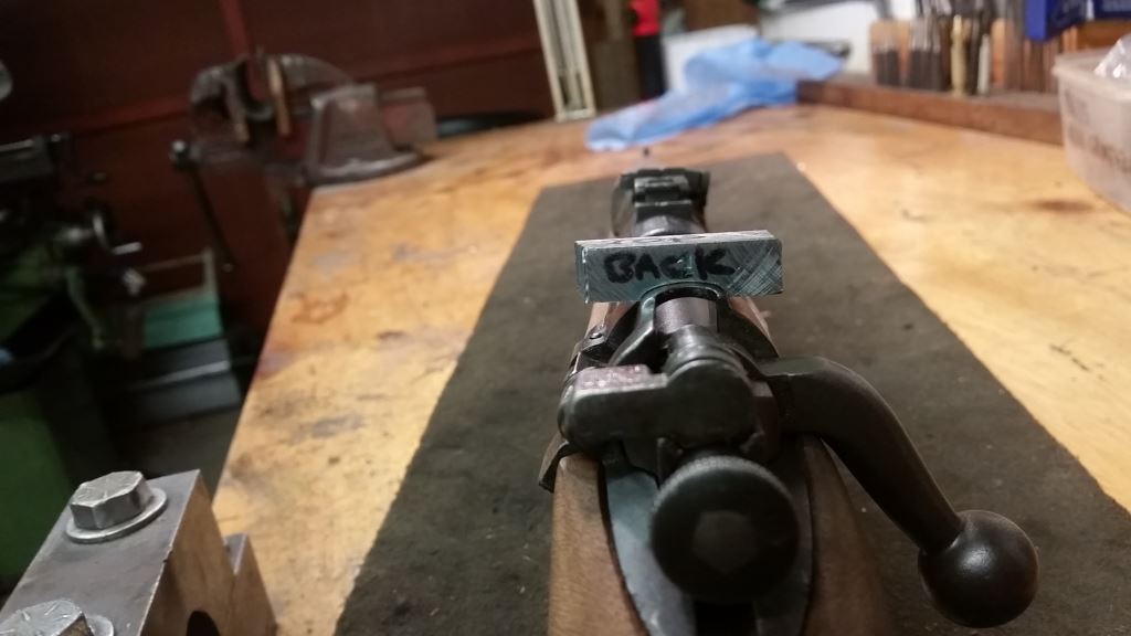

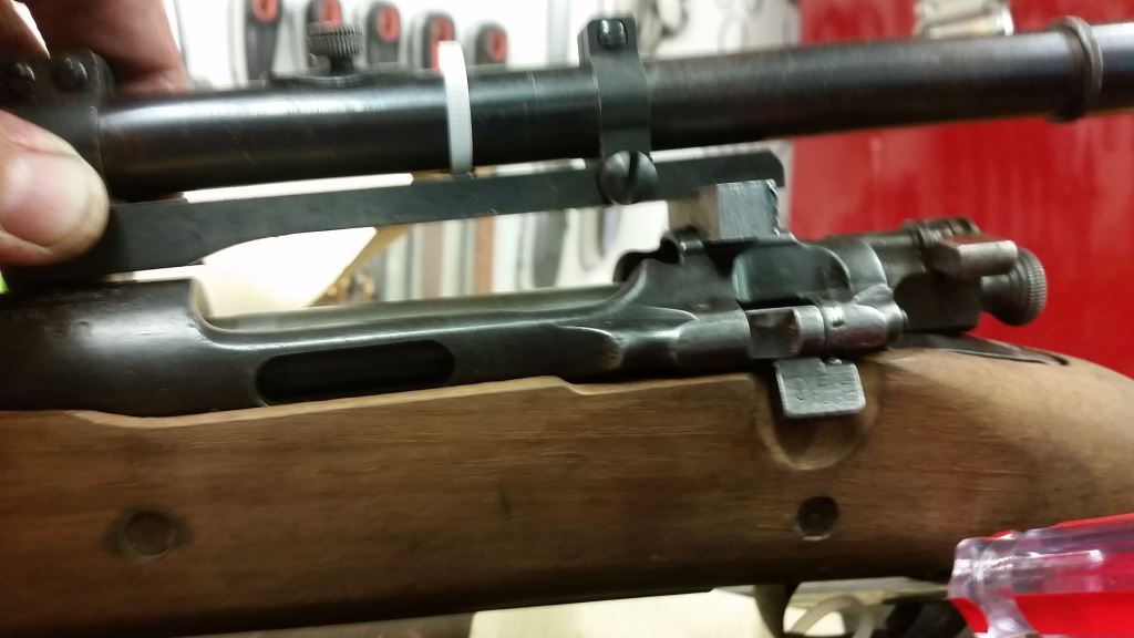

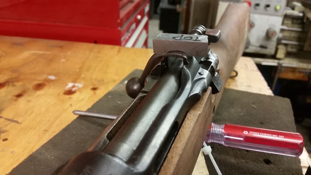

Here are progressive photos of my Springfield M1903 with more to come as maxed out at 10. It was an original length sporterised rifle with pretty good bore and a Timney adjustable trigger fitted. I bought the stock from Numrich via eBay which was NOS but needed a repair at the heel. The scope mount was adapted from an aftermarket A4 and the scope is a J2.5 Weaver 7/8". The handguards are NOS from Holland via eBay. The butt plate is milsurp checkered. Barrel bands are milsurp. All screws are from a NOS replacement set from eBay. Shoots 2" groups at 100yds with American Eagle ammo but I have 500 once fired Federal brass to hopefully improve that figure.

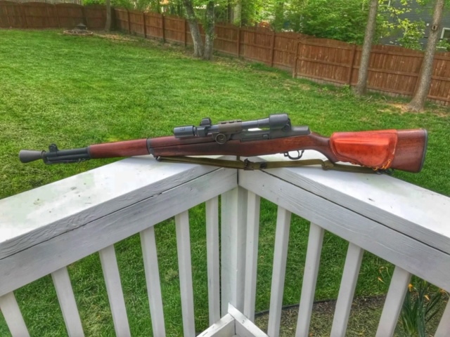

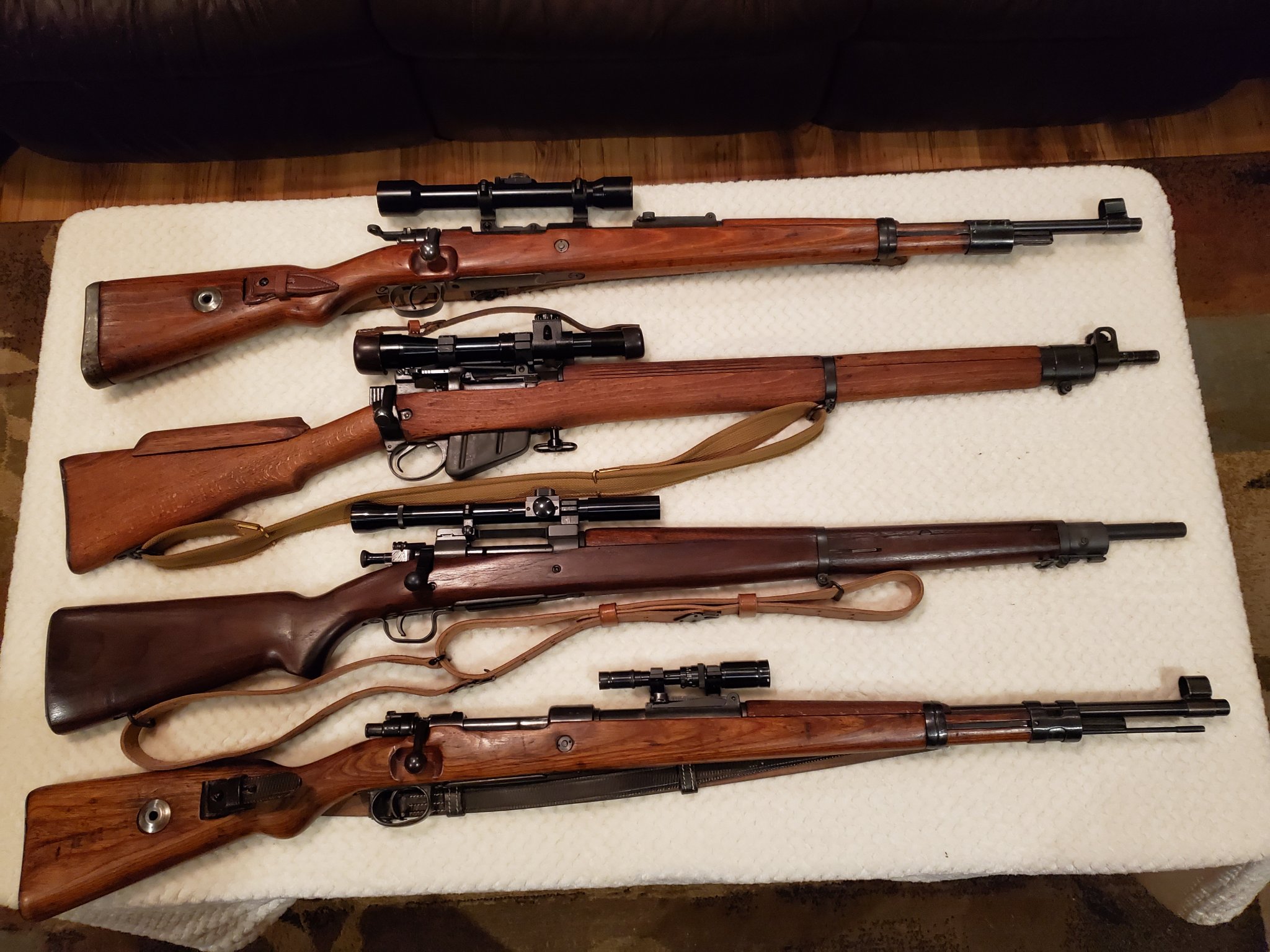

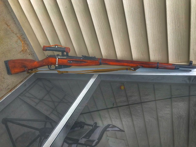

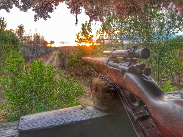

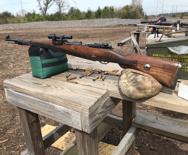

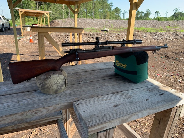

So far my WW2 sniper rifle collection is up to 5. All are original snipers and original accessories with the exception of the 1903a1 Marine sniper. That is the only clone.
Winchester M1D with all USGI accessories.
All matching byf 44 K98 ZF41
Z Prefix 1903a4 with M73B1 scope
1903a1 clone built on a 1927 SA receiver
1943 Izzy Mosin PU
