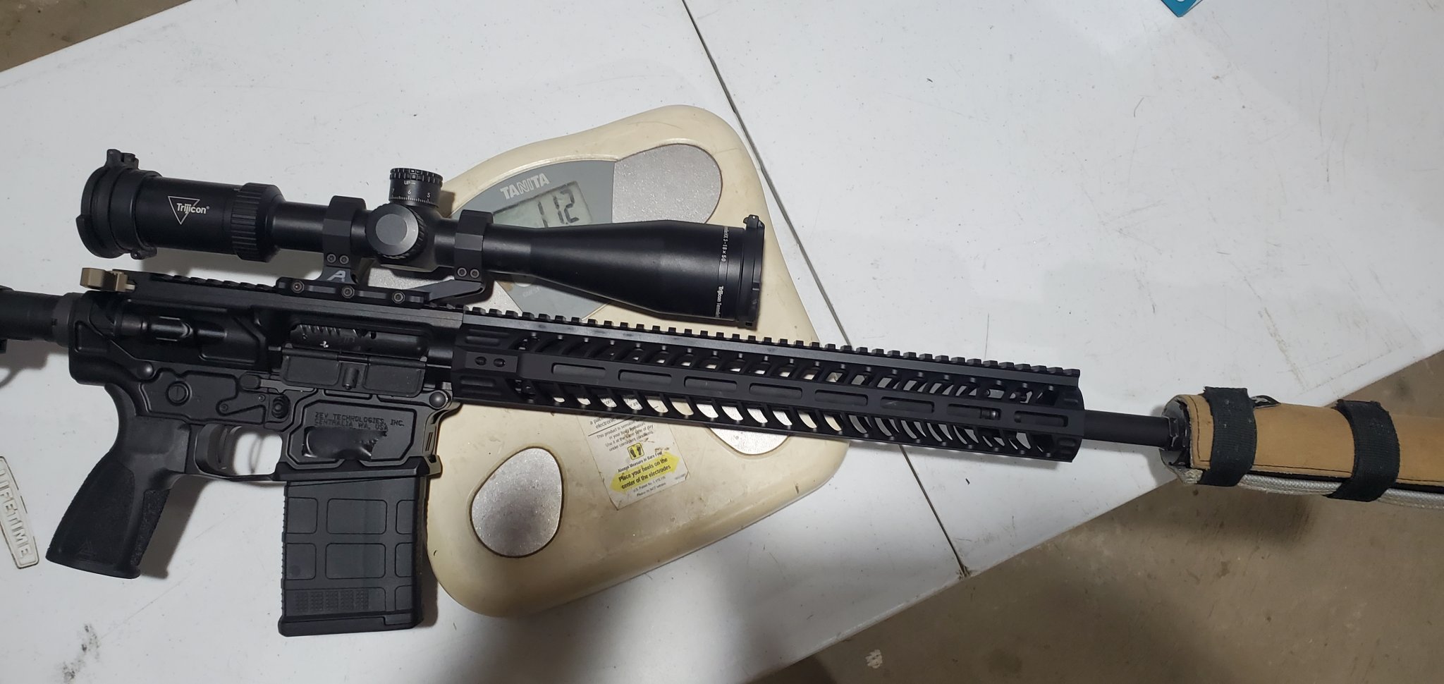

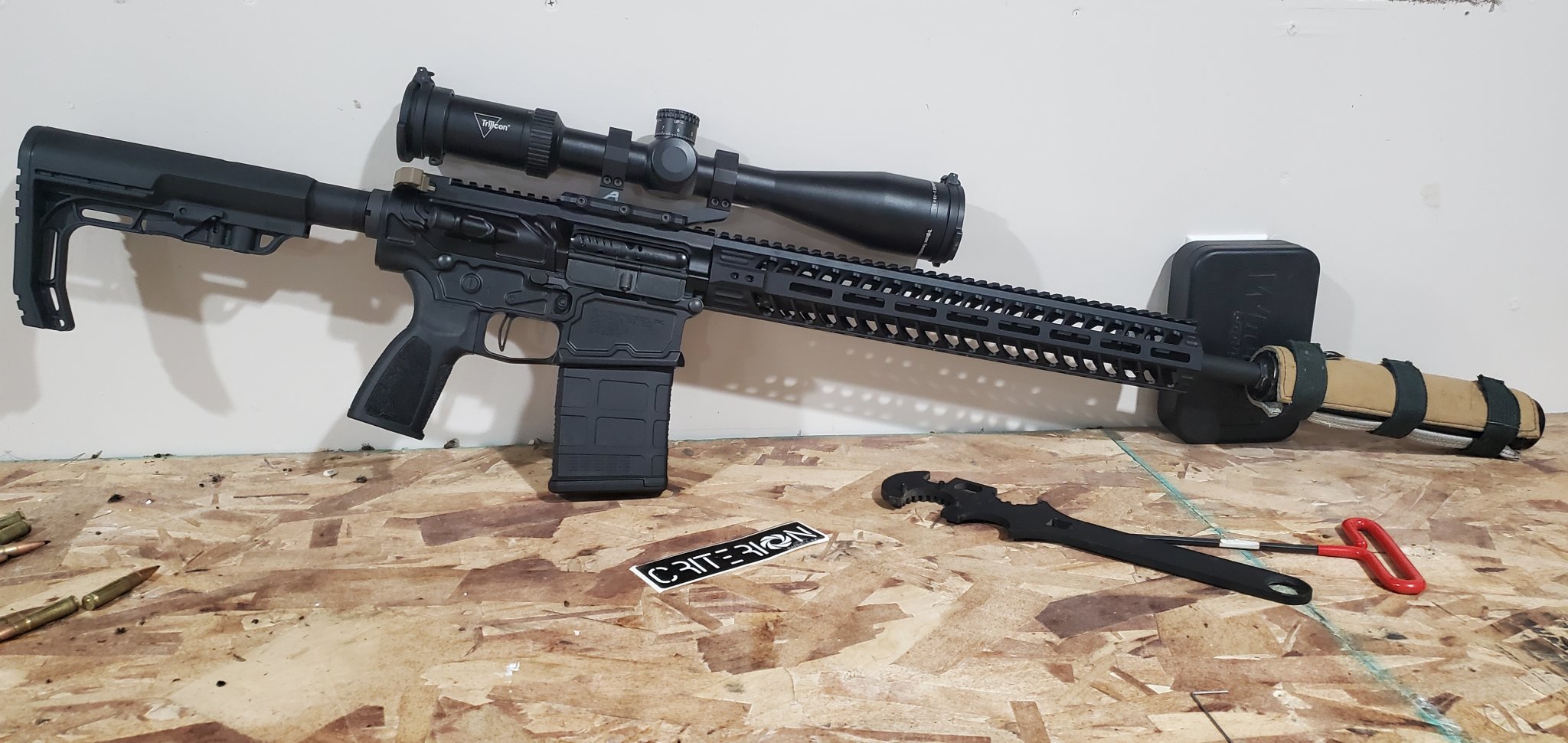

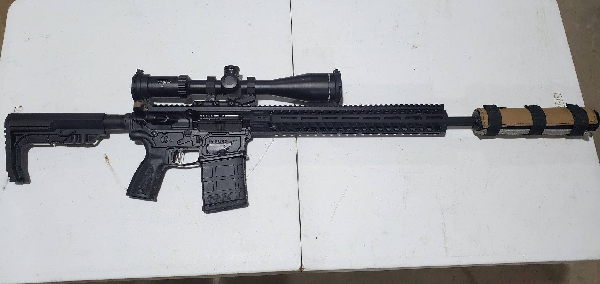

Aight so the leftists and neocon uniparty running our country seem intent on thrusting us balls deep into WW3, sooo I decided it was time to fill a void in my arsenal.
I'm set up to kill commies really really far away, I'm also set up to kill commies close.
What I needed was a tool to kill commies far and close..
Enter the 6.5 Commie Killer AR 10 build!
I just got her assembled tonight, here's the specs:
Zev receiver set
Criterion 18" barrel 8 twist
JP full mass HP BCG
2A ultralight 15" handguard
Larue MBT2S trigger
Griffin SOB buffer assembly
MGT minimalist stock
SLR 7 AGB
Trijicon tenmile 3-18×50
Aero ultralight mount
Nomad LT suppressor
She weights 7lbs 10 oz neked, and 11 lbs ready to smoke commies.
More to come

View attachment 8278362View attachment 8278364

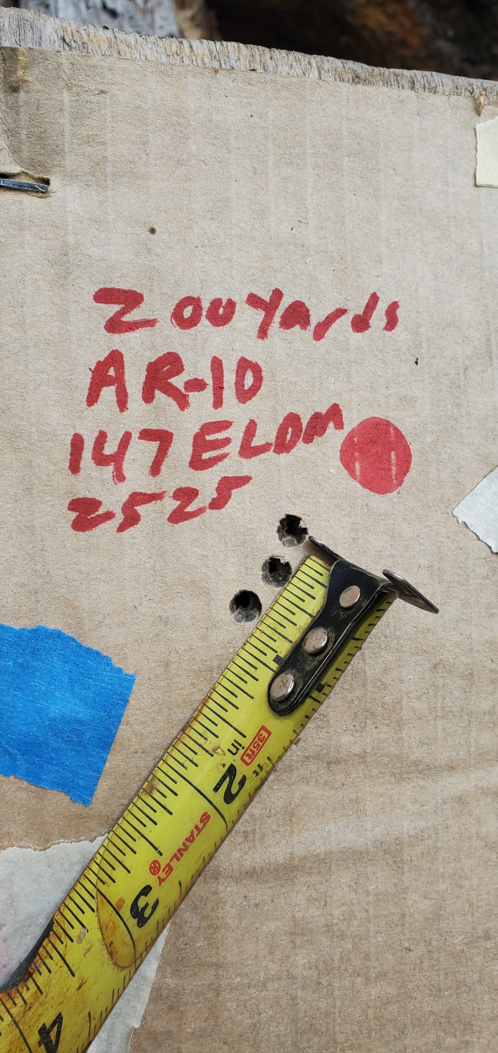

I broke down and bought a $40 box of factory ammo yesterday, a small piece of me died..
I got on paper with my magneto speed and averaged 2525 with the 147 eldms.
After getting it dialed at 200 yards I shot a 3 round group that measured under an inch, I'm stoked on the accuracy and flawless cycling thus far.
We sent the remaining rounds at a 550 yard gong and my 14 YO nephew effortlessly smacked it every single shot.
It's actually damn quiet without earpro, I'd only wear plugs for extended shooting sessions.

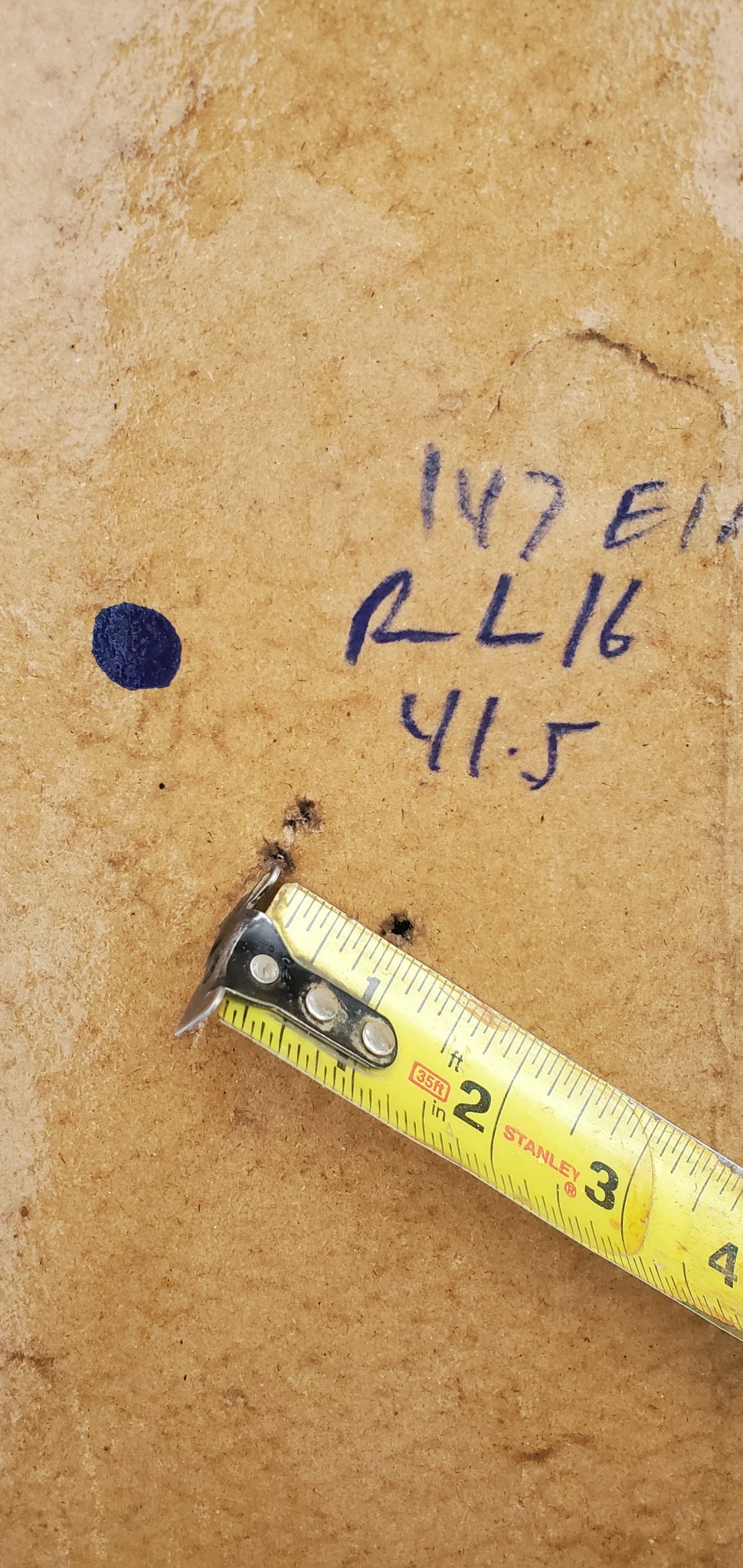

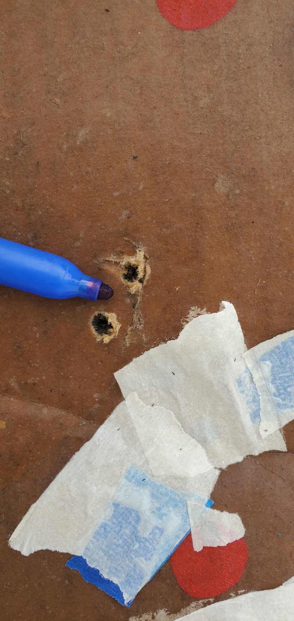

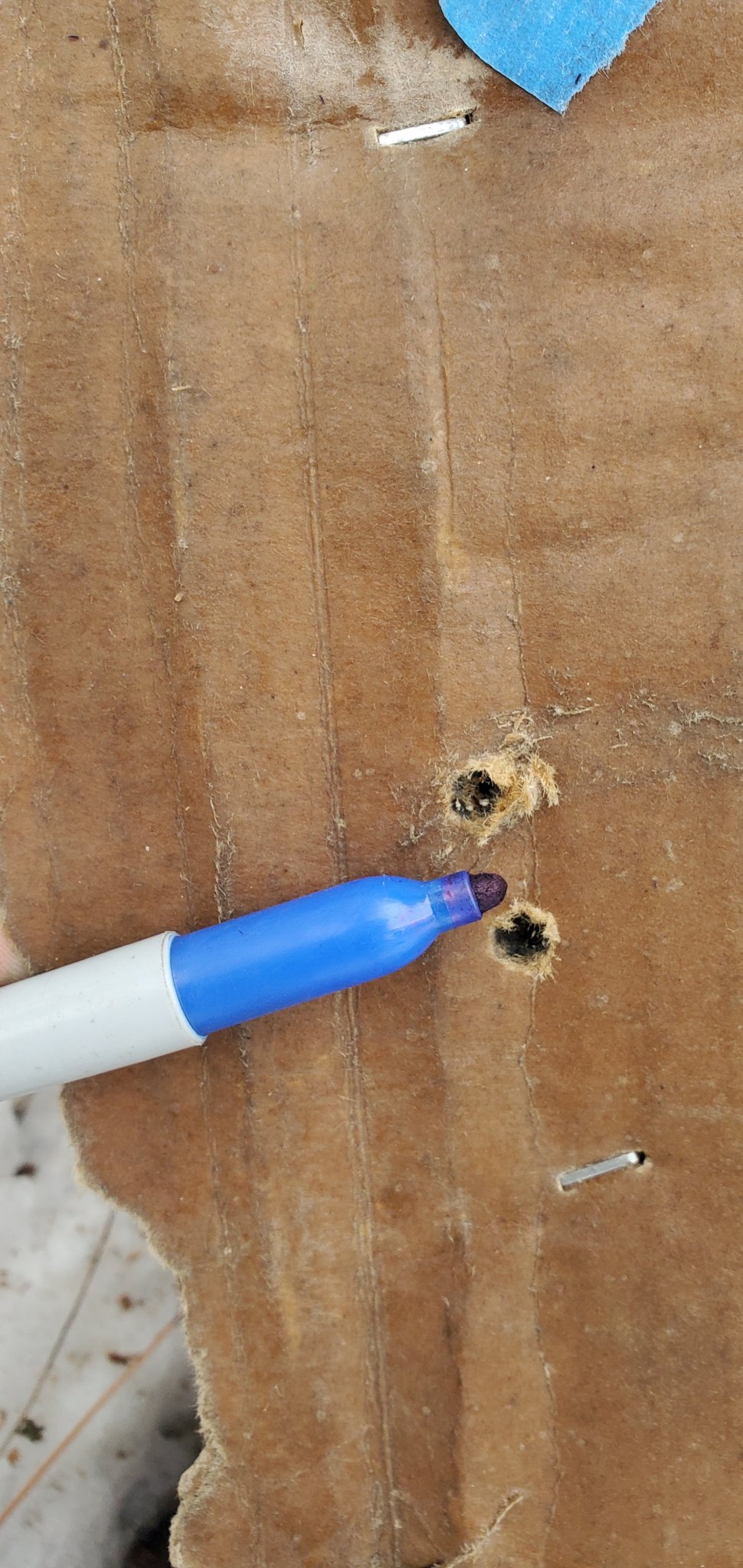

Another quick update
I got some load development done today with 147s, the only powders I have that work with the CM are n565 and a little Rl 16.
Both powders are shooting tight little groups at 200 yards, cycling is flawless and there's no gas to the face with the Sprinco extra power spring.
I have about 100 rounds through her so far and it's a pleasure to shoot!
Couple pics of 2 shot groups during development, settled on 41.5 grains of RL16 at 2550 fps (final 3 shot group)
View attachment 8287915View attachment 8287916
