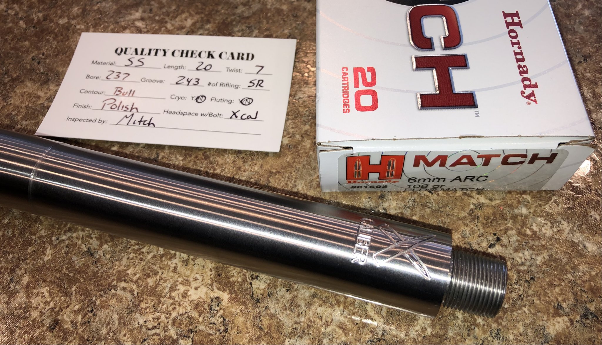

I ordered two AR pattern barrels from X-caliber on Dec 31 when they had a 20% off sale going. At the time they quoted 8-10 week delivery. They are due for delivery this weekend. One is in 6mm ARC and the other is a 308 win. I'm hopeful they are both shooters! Of course that depends on me. lol

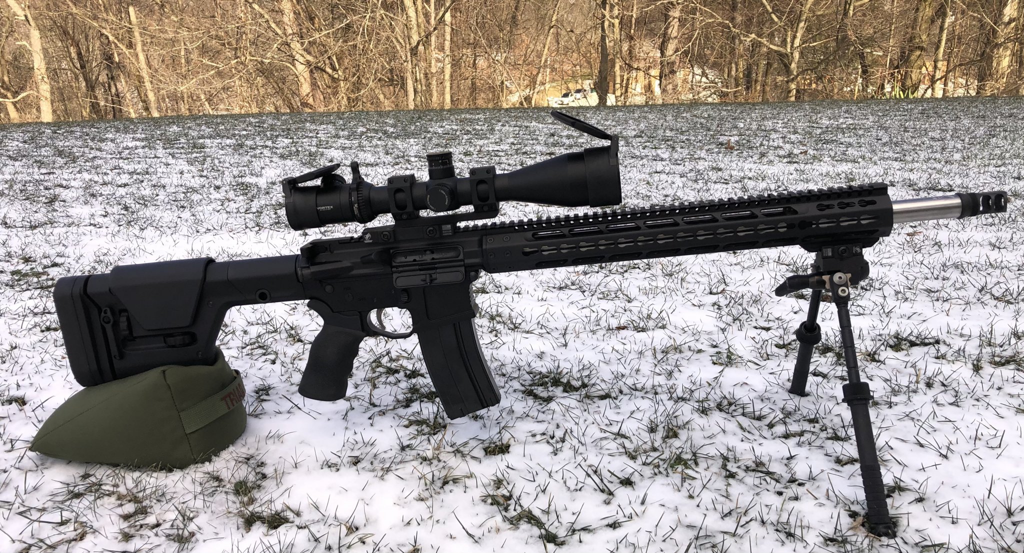

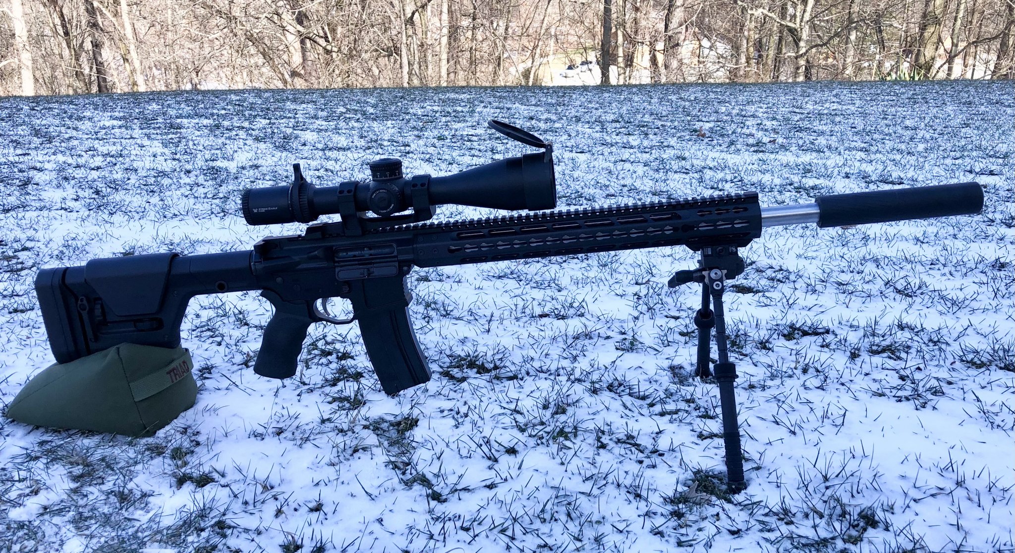

New rifle build. More accurately a refresh. It used to be 6.5 grendel. I sold all that stuff a few years ago. It’s a Mega Arms MKM matched receiver set and 16 inch handguard. It’s almost complete. I need to order a LaRue MBT-2S trigger, kns non-rotating pins, BCM charging handle and a Vortex Defender eyepiece dust cap. I ran my bore scope through the chamber and bore and it looks very good. I recorded video of the bore scope but it will take me a few days to edit it and post it to my YouTube channel. Hope it shoots!

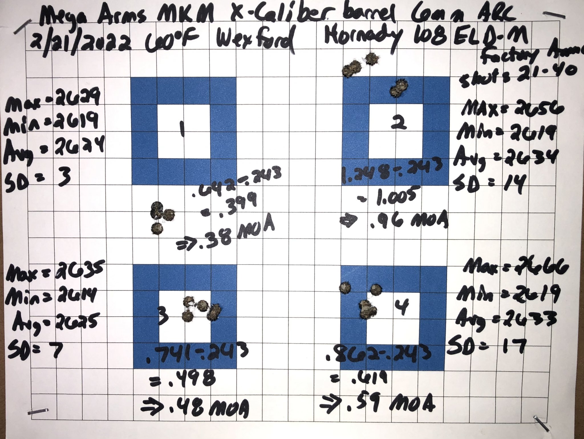

Well I’m a believer in X-Caliber now. I couldn't resist the nice weather so I hit the range this afternoon and did a 20 round break in (doing the shoot and clean method) and then shot four 5 rounds groups. All groups were shot from a bench and using an Atlas CAL bipod and rear bag. The range I was shooting at doesn’t permit shooting from prone. I think it's a shooter! For factory loaded ammo at 100 yards, I'd say it's going to be tough to duplicate this through hand loads. Hopefully I gain consistency in muzzle velocity by hand loading. I'm very pleased!
Edit: Forgot to mention that the point of impact for each of the four groups changes because I was dialing in the scope zero.
