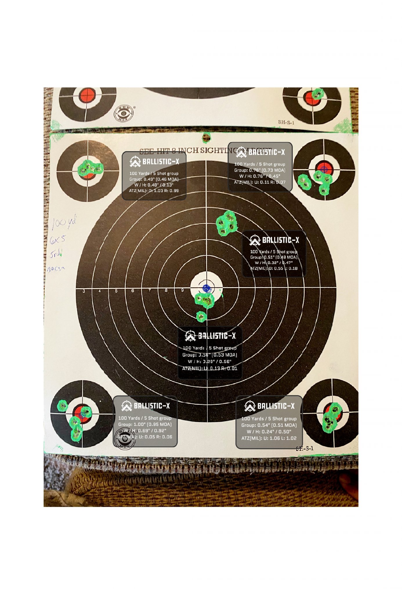

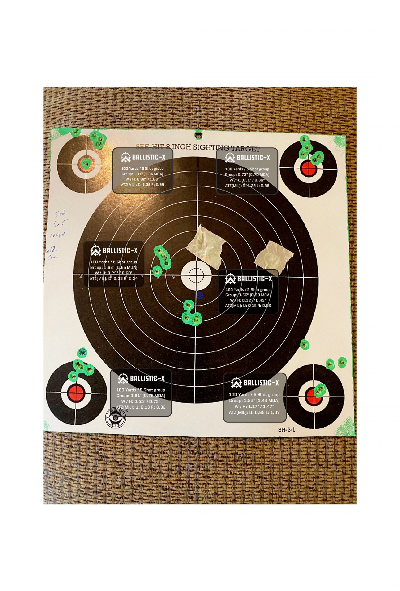

It’s in the vudoo thread. Don’t remember the time frame but it was after March of this year. I shot a couple different lots of center x and did 6x5’s. With and with out the can. The can avg was something like 0.7moa at 100yds whereas without was 0.6moa at the same distance. All shooting was done off a bench, bipod and rear bag, indoors so I could control the environmentals.
I’ve also never lot tested my rifle as I’ve never needed to. The accuracy I’ve had out of all the different lots has proven to be sufficient for the shooting I do. While my results are a drop in the bucket compared to others shooting suppressed, I will not run suppressed in a match after the testing I’ve done with my setup.
First pic is with the can
Second pic is with out the can

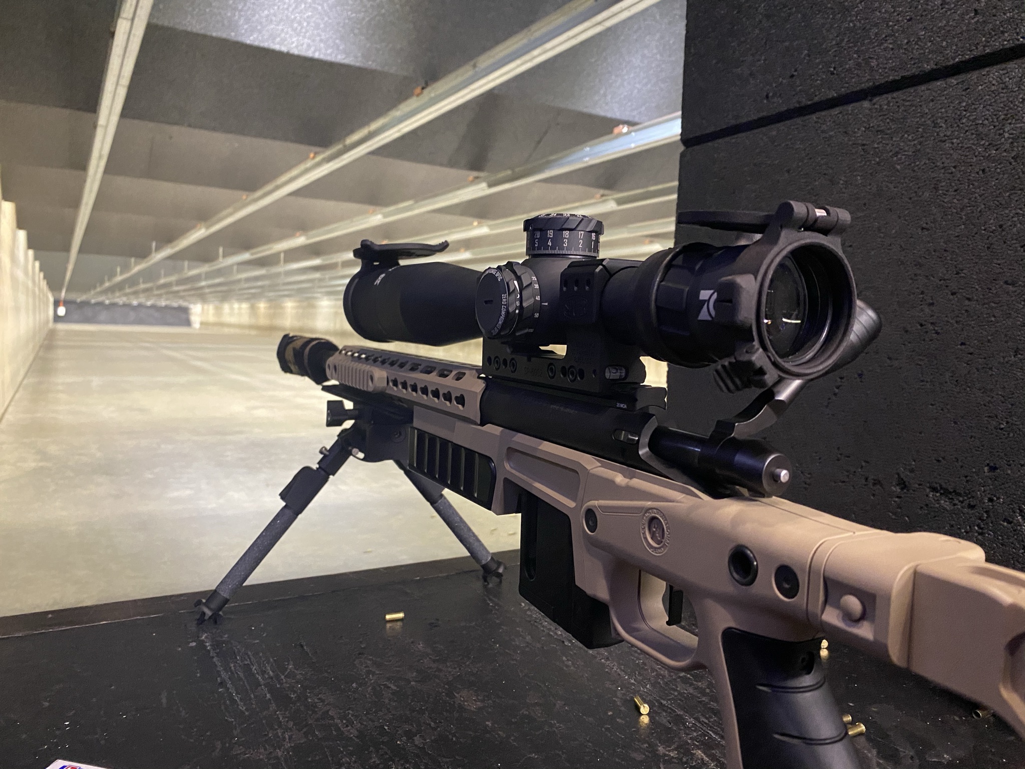

Third pic is the setup
Vudoo V-22
18” Proof carbon fiber barrel
TT Diamond single stage
AIAX chassis
Ckye pod
Thunderbeast 22TD
