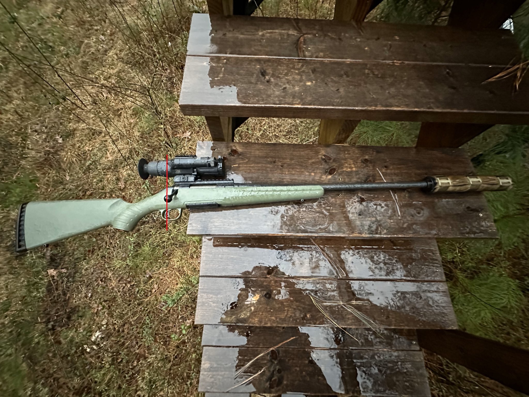

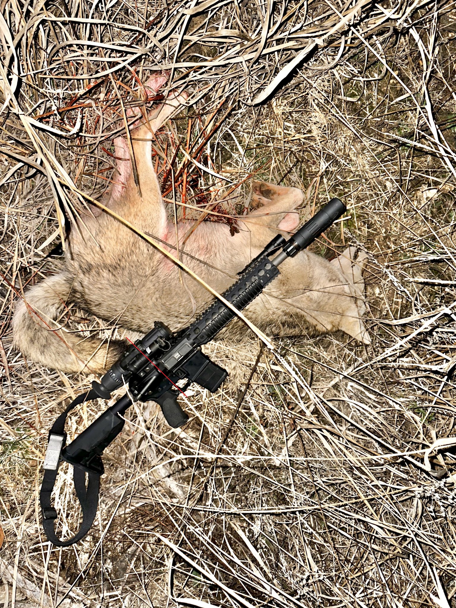

Nvision NOX 35. I need like 9" LOP to use it on a "normal" rifle.
See pics. On an AR I can get it much further back in relation to the trigger, but on a bolt gun (or any rifle stock with a 13" LOP) it is way too far forward to use with a shuttered eye guard and I am looking through a tunnel. I have tried it on AIs, MDTs, MPAs, etc none of them reduce the LOP enough to easily see through the optic.

Have you looked into different scope mounts? I think Bobro makes one that extends it back farther. I don’t think you’ll get your LOP short enough on a bolt gun to make that comfortable.
This type of thing:

Seriously this is awesome. I had no idea this existed - in fact when I saw your post my first thought was "Dude regular extended scope mounts don't work with NOX thermals"
I've already placed the order. This is absolutely perfect. Now I can run any chassis/stock I want with great eye relief.
