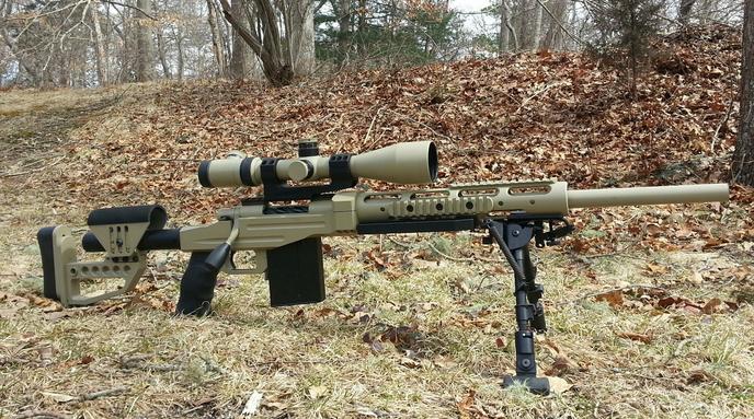

I use the Aadland one piece from Jon here on the hide. EXCELLENT mount and I have both 50mm and 56mm scopes and they work fine. There is also a built in level.
