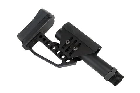

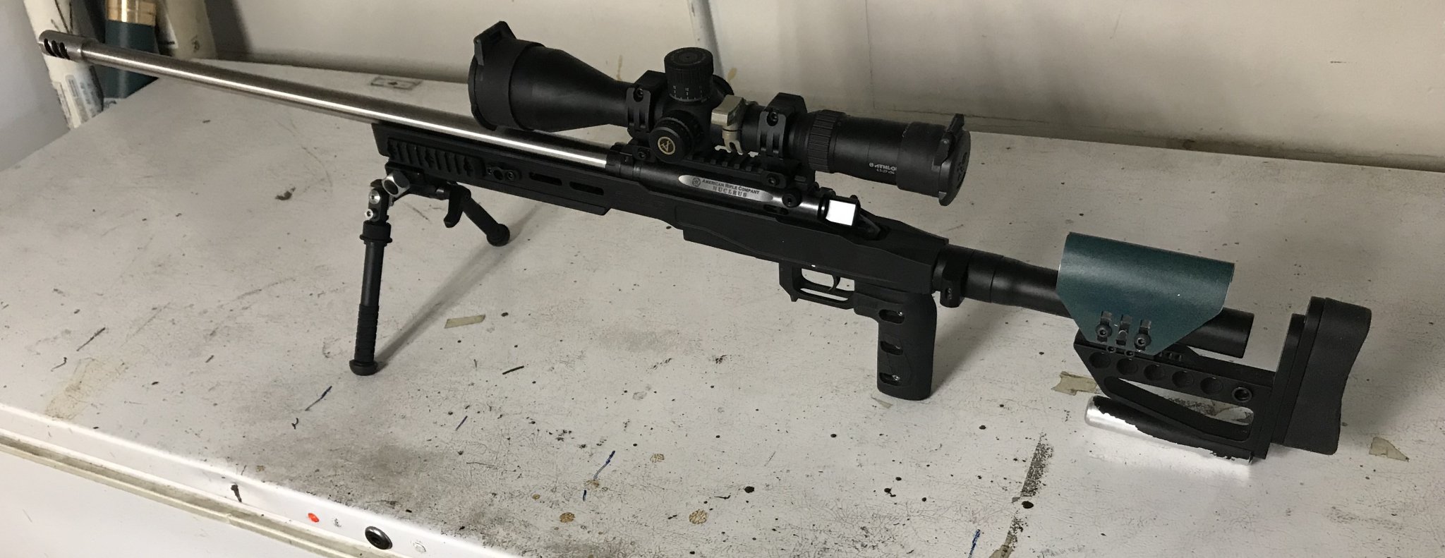

I have 2 XLR chassis, both with the tactical buttstock. (pic)
7098422
For me, the "hoop" cheekrest is a bit too wide, making getting a good sight pic difficult, and the body of the cheekrest covers over the adjustment screws, making adjusting it tedious.
I'm working with a SH supporter to gauge interest in making a cheekrest that attaches to one side of the buttstock, arches halfway over the "buffer tube" that will allow for easier adjustment and better sight picture.
Lemme know, here.... thanx !

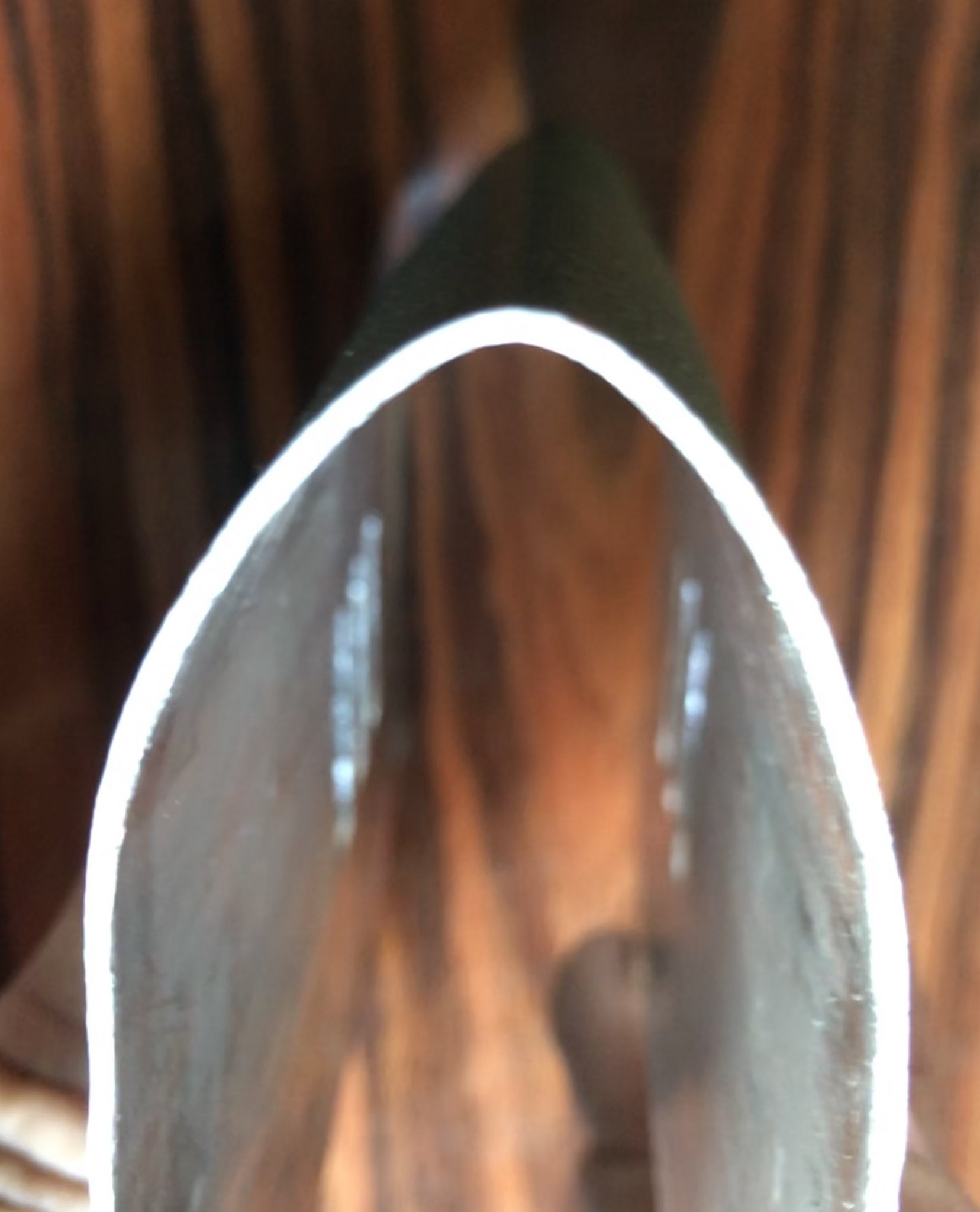

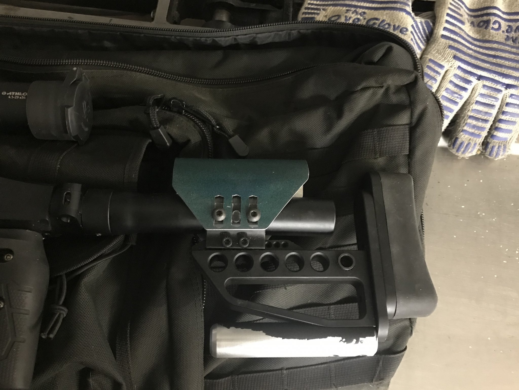

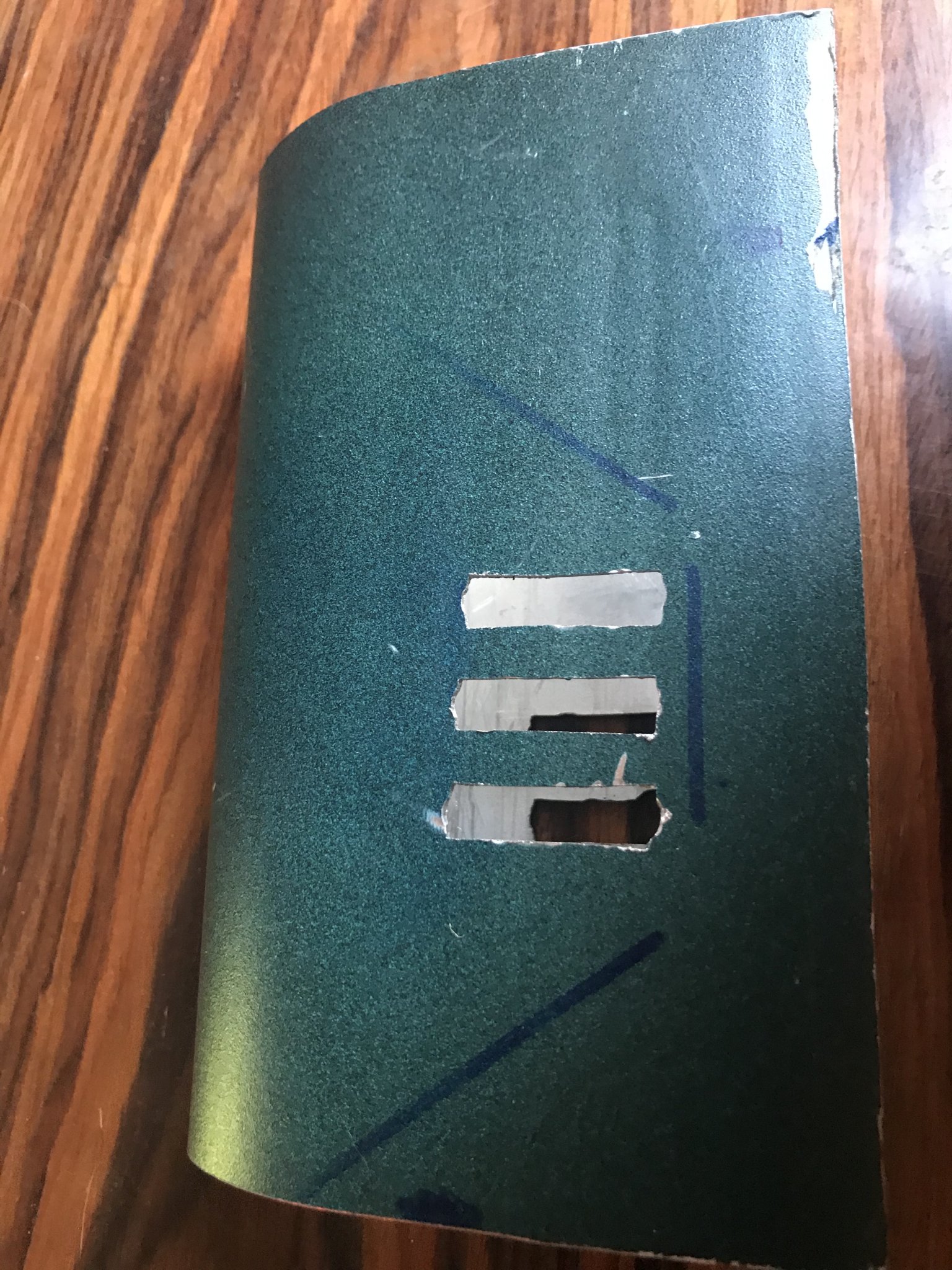

So I had some powder coating aluminum tube at the shop I was saving for something laying around the shop.
Made a wood buck with a asymmetric profile with a different radius on each side so I can swap it around to try two shapes.
Drilled some holes and cut some rough slots with a file.
I’ll finish it out tomorrow at work with the band saw and belt sander.
Hopefully I can shoot with it tomorrow before I leave to Cali on a business trip.
I need to re zero it anyway because I changed barrels.
Both Sides feel real good especially the really big radius side like a JAE cheek piece.

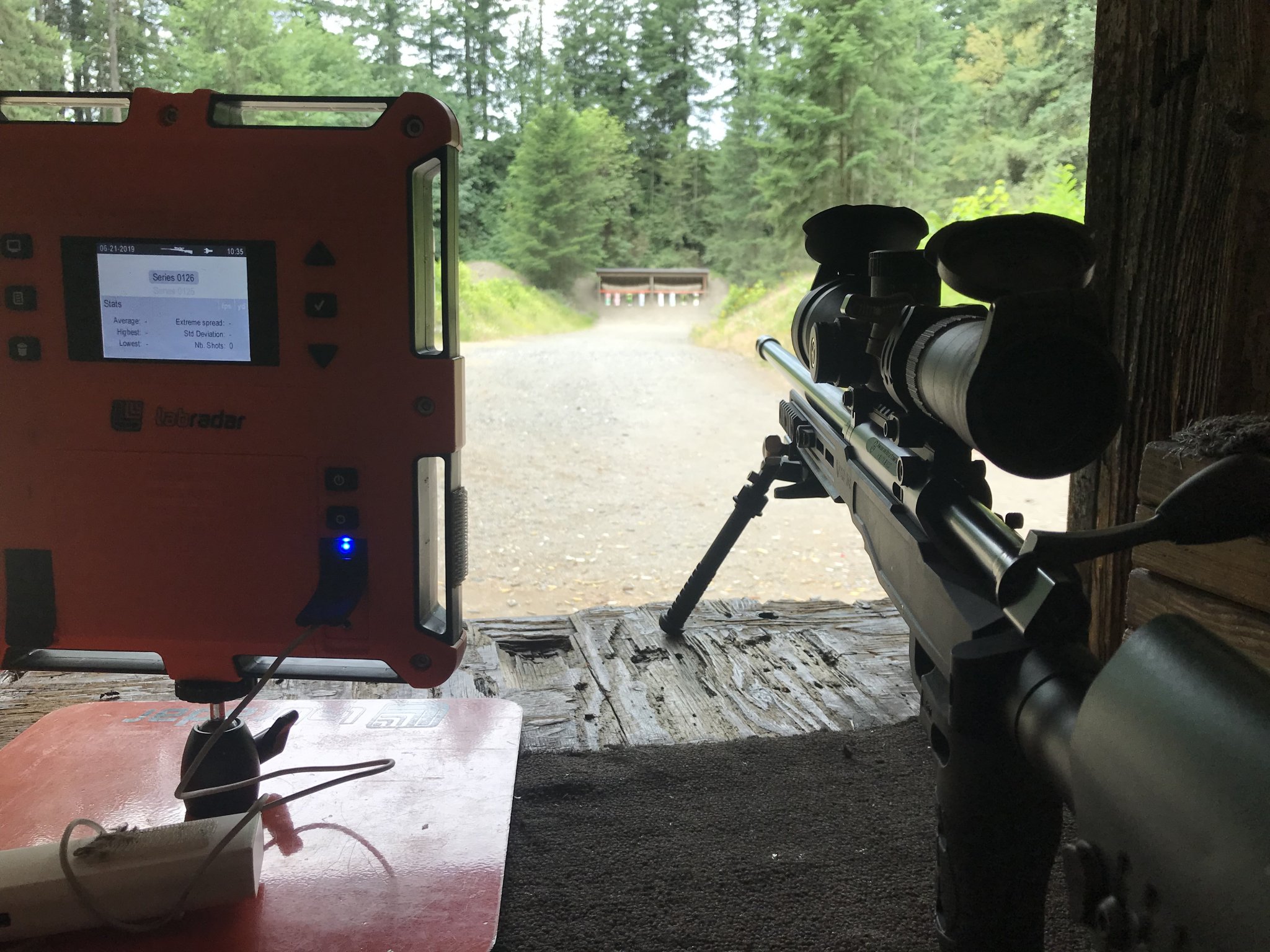

I need one of the labradars. Thot they were over a grand. Actually under 600.
Bye bye magnetospeed. :)
No doubt they're the "cool kid" gear, but they are far from perfect. Personally, I would wait to get rid of the magnetospeed until you have hands on experience with the labradar's finicky issues to see if it's stuff you can live with or not.
Reactions: garandman
