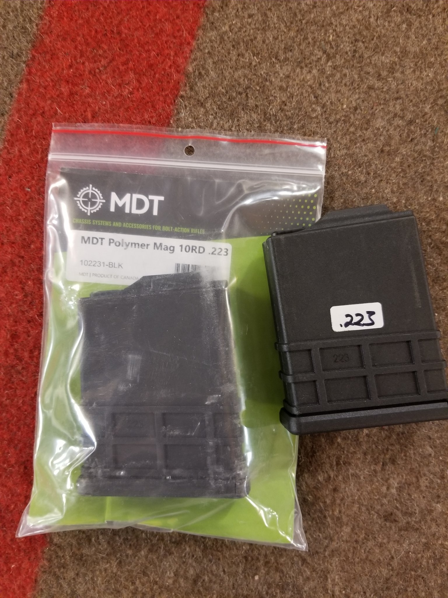

Just received a brand new XLR Envy yesterday and installed my T3x Varmint .223 in it today. After getting everything torqued correctly, I put a couple of dummy rounds in an MDT poly mag, inserted the mag (made a mental note that it went in kind of firmly), cycled the dummy rounds and then could not get the magazine out. I ended up taking the rifle back out of the chassis and tapping on the magazine with a soft faced hammer to get it out. I looked everything over, reinstalled the magazine and noted that it had to be lined up just perfectly to be able to be removed, and even then it required quite a bit of effort.
Is there an adjustment on these or is this a known issue with poly mags? I have a few KRG Bravo stocks and am used to fine tuning them so they are tight enough to pick up the next round but not so tight that they get stuck.
MDT makes several different types of poly mags, are you sure it's an AICS mag? I use pmags in my Element chassis, they work perfect.
Good question, and to validate here is a picture. These are the same mags I use in my KRG Bravo stocks.
