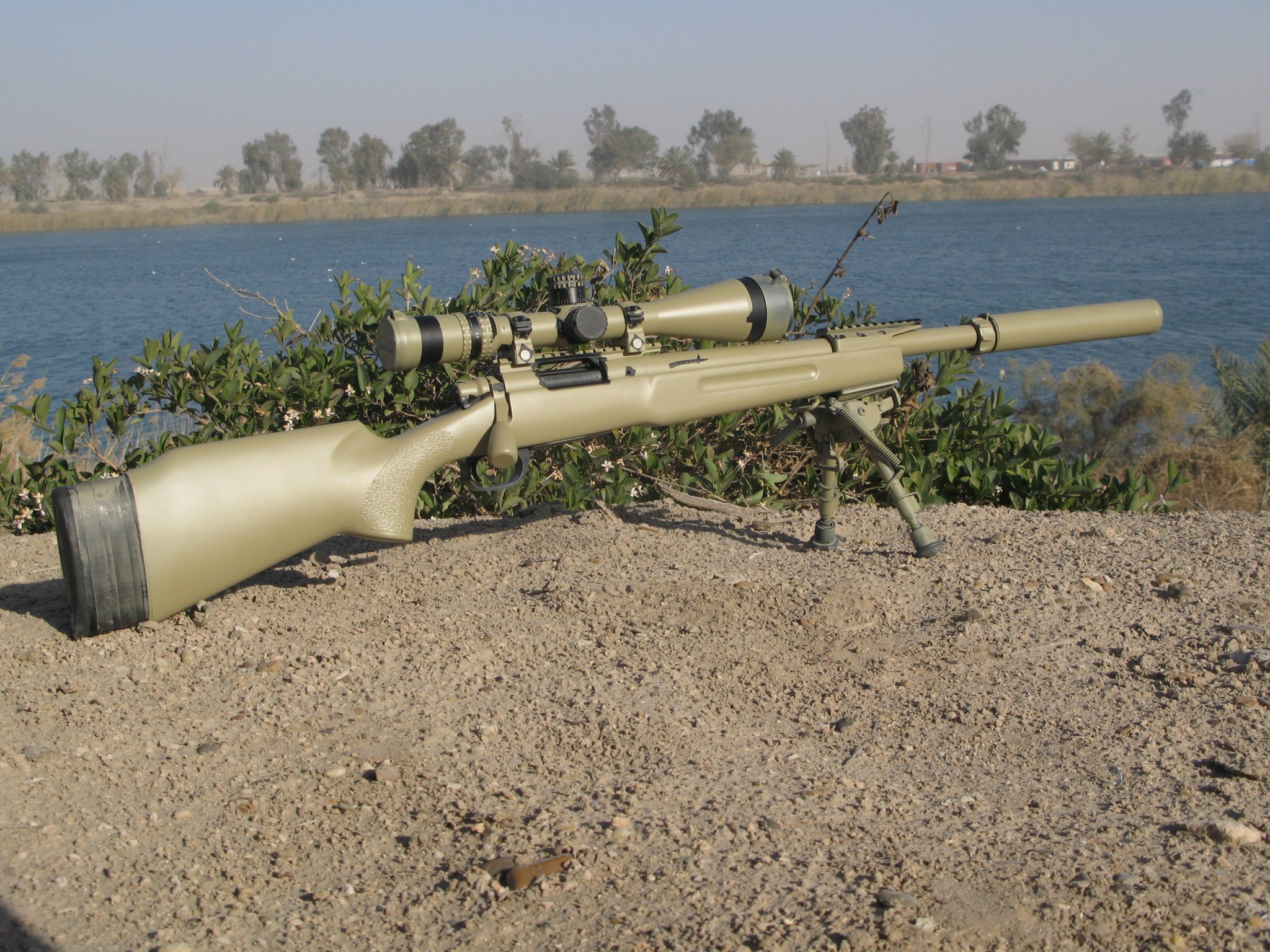

XM-3 on CMP, what’s the story behind these?
Chabrone
Sprayer
May 10, 2011
112
49
44
Thornton, Co
Saw this and was curious what the story was. I think I saw one for sale a few years back but didn’t know much about them.
Thanks in advance from an ignorant civilian.
It was a Norm Chandler boondoggle.
They were, however, cool rifles that performed pretty damn well.
The package makes sense, but, as typical, the Gov paid WAY more than they should have.
The PWS could have done the same thing for a significantly lower cost.
Chandler sent the actions to Hart (if memory serves) to be trued and barrels chambered/installed.
Huh
Not 15k worth of huh, but huh
Huh
That site is also wrong, the XM3 rifles were built by IBA, not at PWS. Jack Fields did the metal work and "Tiny" Briggs built the rifles.
This is false, all the work on the XM3's was done in house by the IBA armorers (mainly by Jack and Tiny)
Thanks for the info.
Can you share anything else? They are dandy rifles and likely superior than the heavier than it needs to be M40 series.

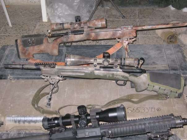

The XM3 is a fantastic rifle, the only shortcoming is the scope. Some platoons replaced their scopes with the S&B from their A3's, other platoons (such as mine) left the NF scope on the rifle. The rifles are very accurate and will easily shoot 1/2 MOA groups (even my IBA XM3 test rifle shot this well).
This was the first time USMC snipers had in-line night vision (no Simrad caps), a silencer, short barrel, simple stock and an adjustable magnification scope all on one rifle. The XM3 was a complete package with all of these new features, not a random one off prototype that only had 1 or 2 of these features. Also, S&B won their contract in 2006, which is the same time the XM3's were built, so the Corps got 2 adjustable magnification scopes at the same time.
If the XM3 had a better scope, 2 piece scope bases and detachable magazines, it would have been damn near perfect. It was an accurate, lightweight, compact rifle with features that weren't found on the early M40A3's of the time. Later on the A3's got an EFR rail, years later they got a silencer on the A5 and years after that they finally got a barrel chop on the A6. It took over a decade for the Corps to integrate all three of these XM3 features into the M40 series. And then they ended up with the boat anchor Remington RACS chassis.
The XM3 is a fantastic rifle which paved the way for features on future M40's. Unfortunately, it just seems to be a footnote in USMC sniping history, when in reality it was probably the single best 7.62 bolt action sniper rifle the Corps ever fielded. Even with the wonky NF scope with MOA turrets and mil reticle, it still got the job done and the snipers only had to memorize a new dope.

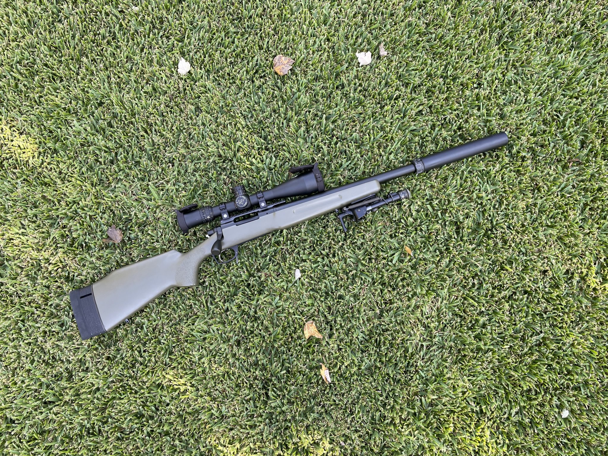

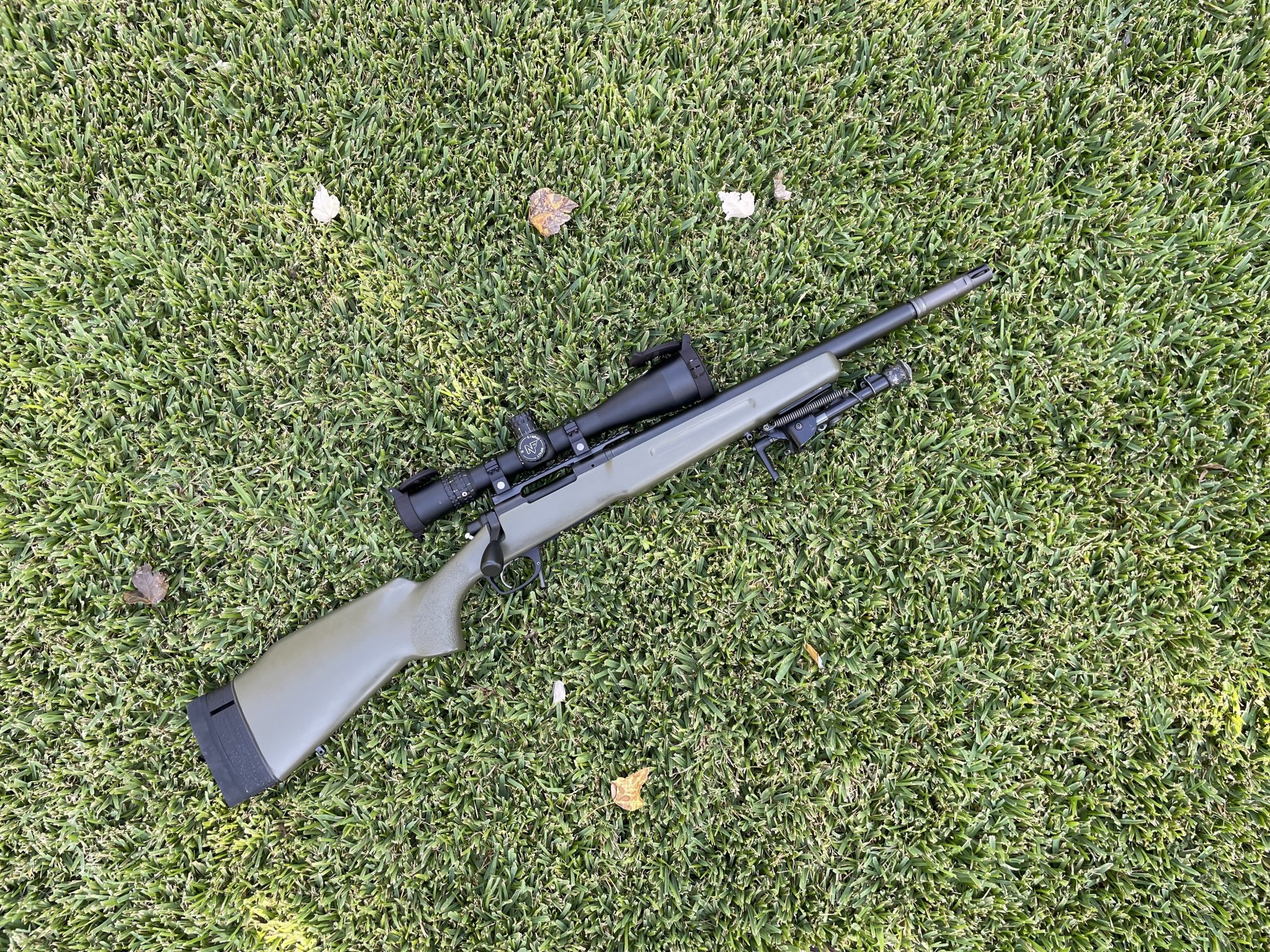

Here's the rifle I purchased from the CMP. This photo was taken by Sgt Fechner in 2008 at Camp Baharia (near Fallujah) right after he painted it tan:
Here's the same XM3 in a photo from a previous sniper platoon that used the rifle (it remained in Iraq as a regional asset). This is what it looked like when my platoon got the rifle, before Sgt Fechner painted it tan:

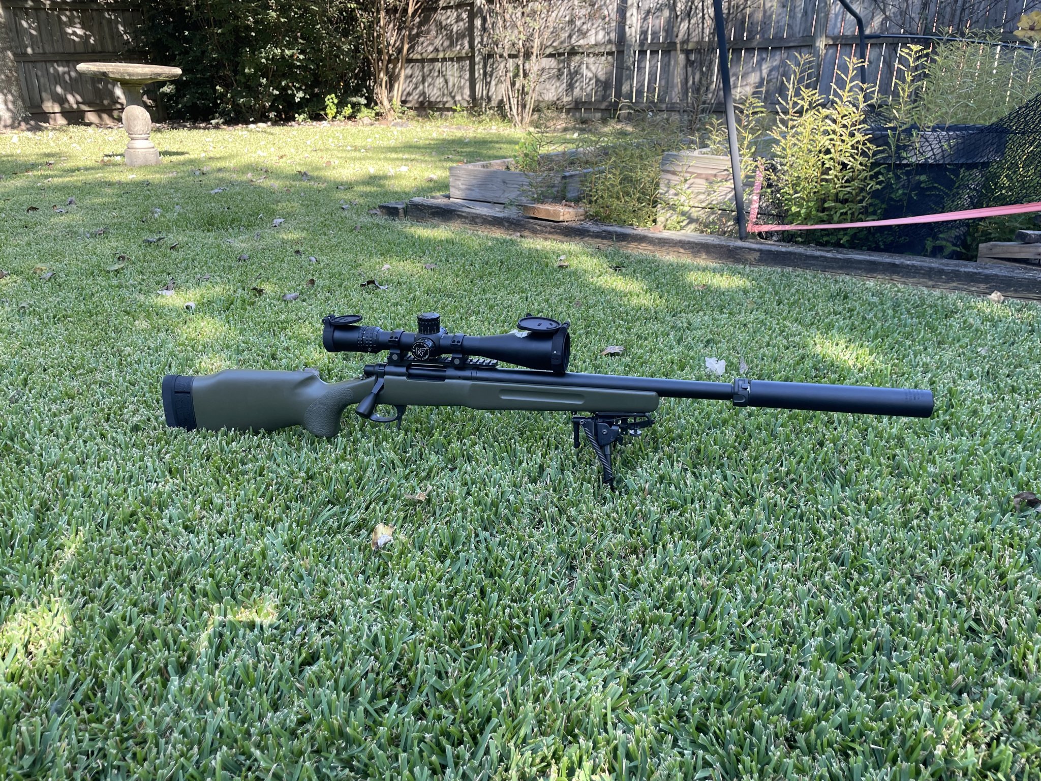

My XM3 with PVS-22 attached:

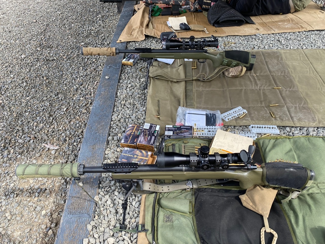

Here's the XM3 with my M40A6:
Any technical information or history of the program is well documented on Steve Reichert's website, there's not much I can add to what he's written, it's great information. My platoon had 4 of these rifles when we were in Fallujah, we only used 2 of them. 2 of the 4 have been sold at the CMP auction site, I purchased the tan painted one in the link you posted.
It the XM3 had a better scope and had detachable magazines, it would have been damn near perfect. It was an accurate, lightweight, compact rifle with features that weren't found on the early M40A3's of the time. Later on the A3's got an EFR rail, years later they finally got a silencer on the A5 and years after that they finally got a barrel chop on the A6. It took over a decade for the Corps to integrate all three of these XM3 features into the M40 series. And then they ended up with the boat anchor Remington RACS chassis.

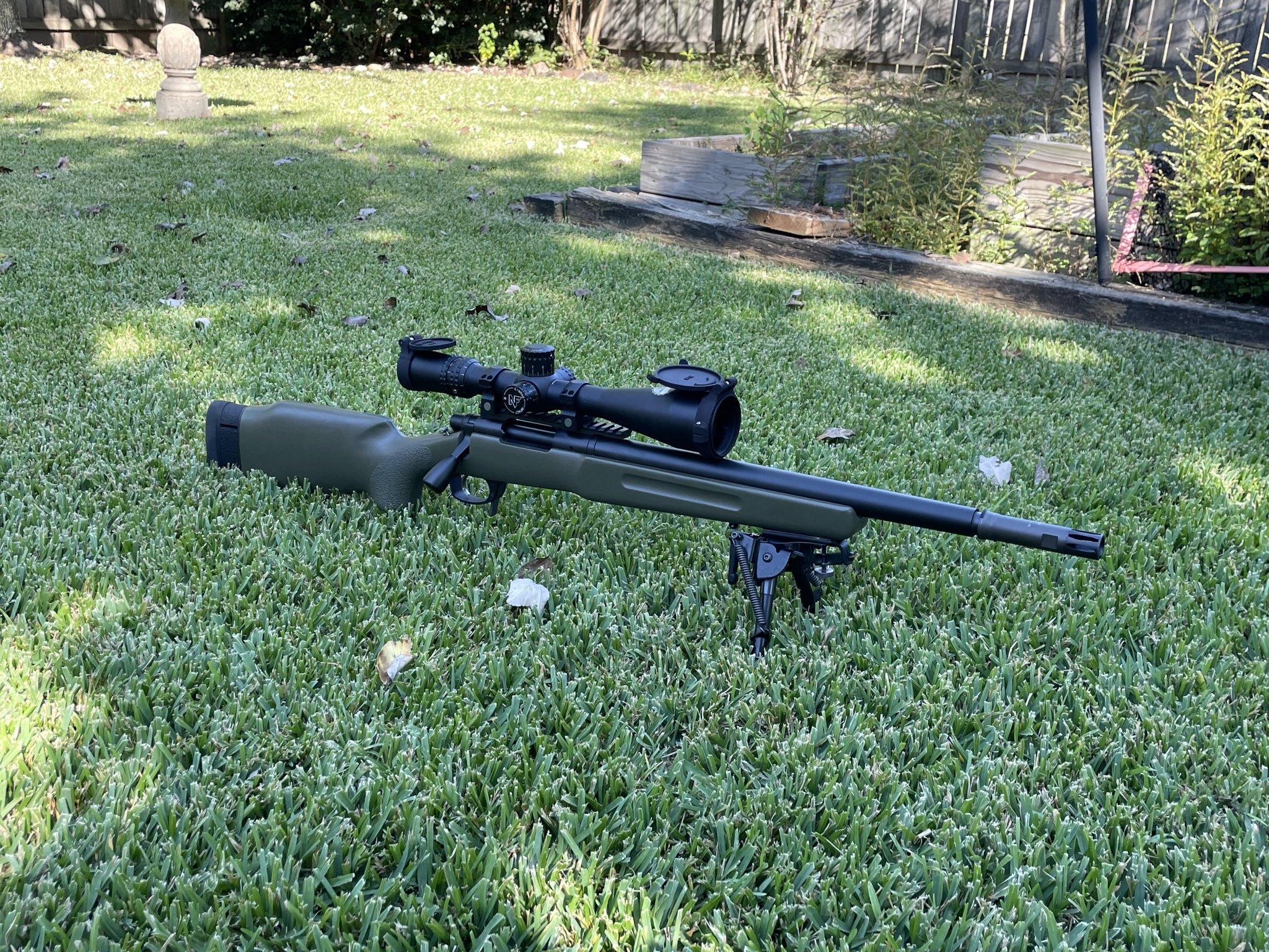

Here's a bunch of photos that Sgt Fechner took at Camp Baharia (Fallujah, Iraq) right after he painted the rifle. This is the rifle I bought from the CMP and is 1 of 4 XM3's my platoon had during that deployment. It's amazing to have this much documentation on this rifle!
As I mentioned in a previous post, this is how my platoon received this XM3, before it was repainted. Same rifle, different camo:
