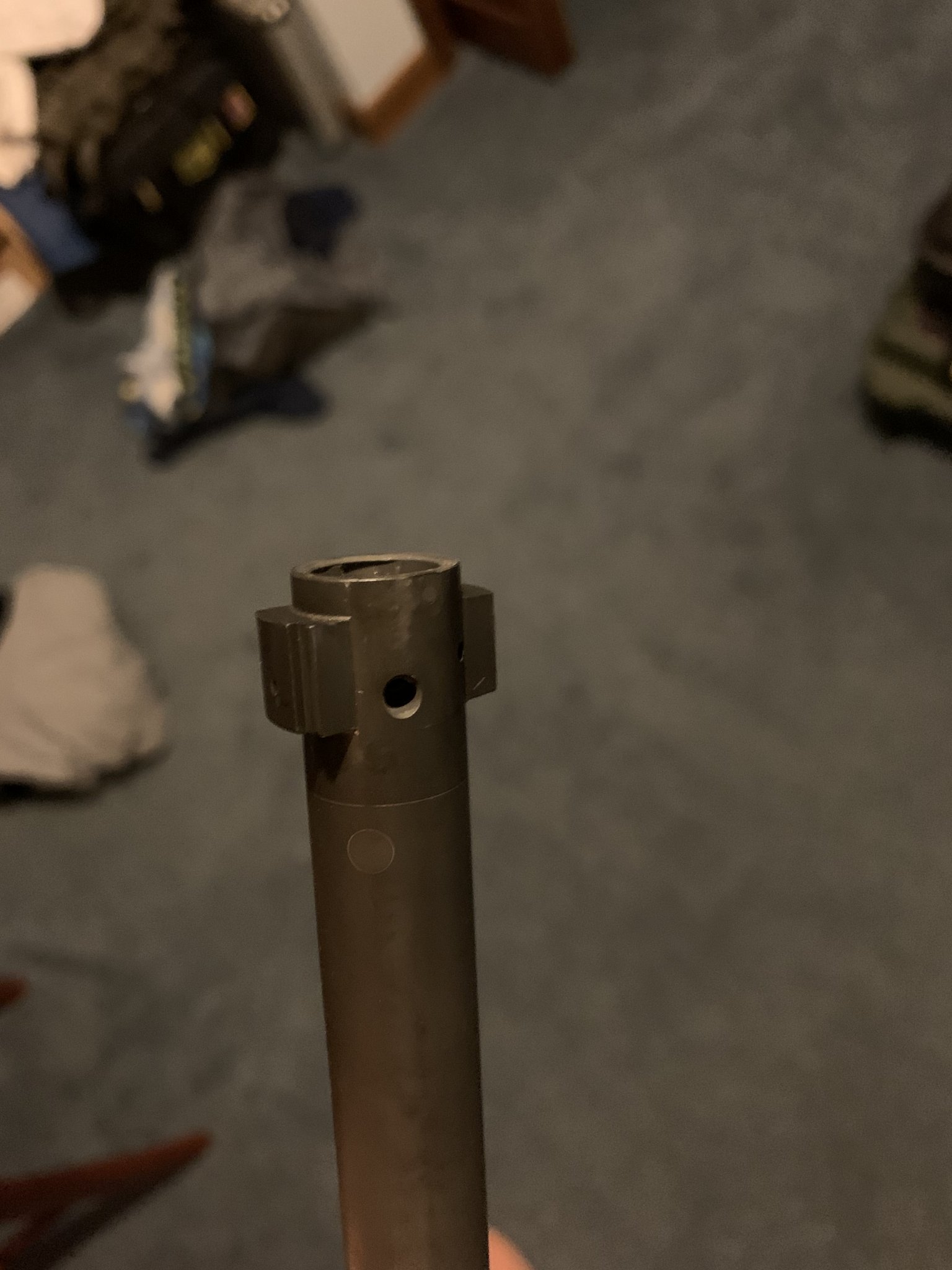

Hi all,
I’m currently building a XM2010 and was starting to recover some parts for it. When I looked at the bolt I noticed a big hole near the front. Nothing comes up when I look at parts list for this spot. Do you know what this is for??
Also If you know where to find a chassis let me know! Lol
