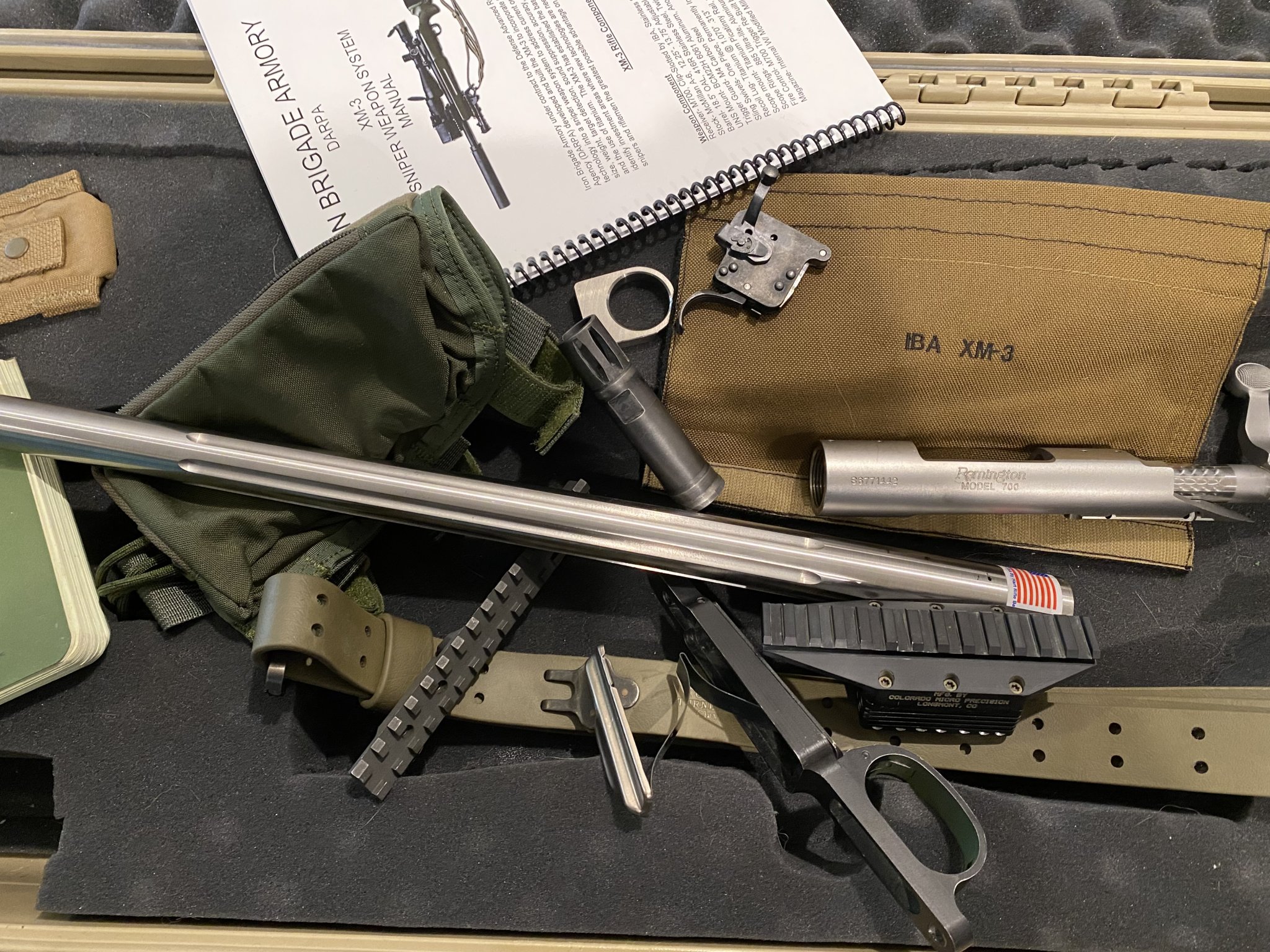

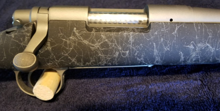

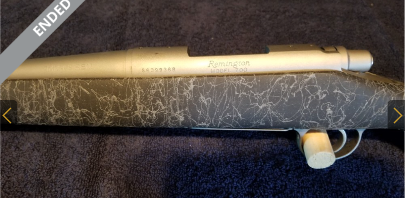

I am new to this community so I have reached out to a few members for guidance and insight. I started some research on a build I am interested in and almost made a fatal mistake. I almost ordered a built XM3 DARPA clone from BG Defense (Type A Rifles). The price I was given was $6,900 without the needed scope, suppressor or cheek pad. I am thankful that I reached out to Ryan (USMCSGT0331) because he STRONGLY stated not to pay the $4,000 one material cost. After watching a video about Type A Rifle clone I was led to believe that they had the only McMillan stocks for this build.

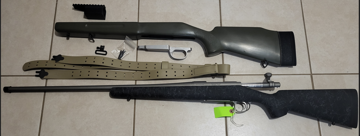

Are you still looking for a stock and parts? McMillan has a stock with EFR for sale at the moment. They won’t tell me who made the EFR. I just purchased the one that didn’t come with the EFR
Reactions: USMCSGT0331

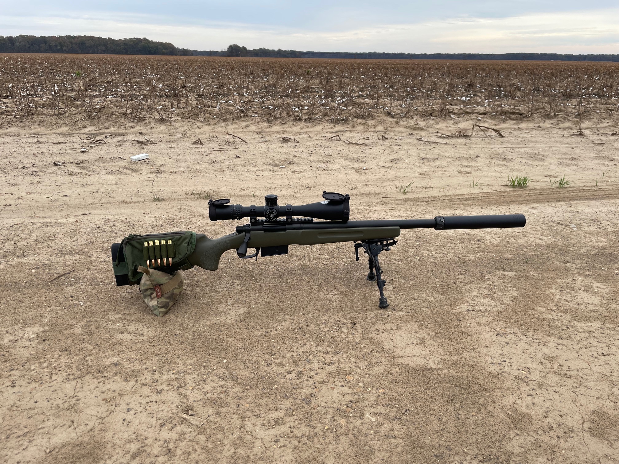

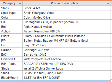

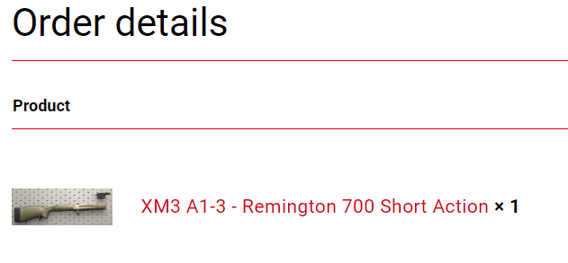

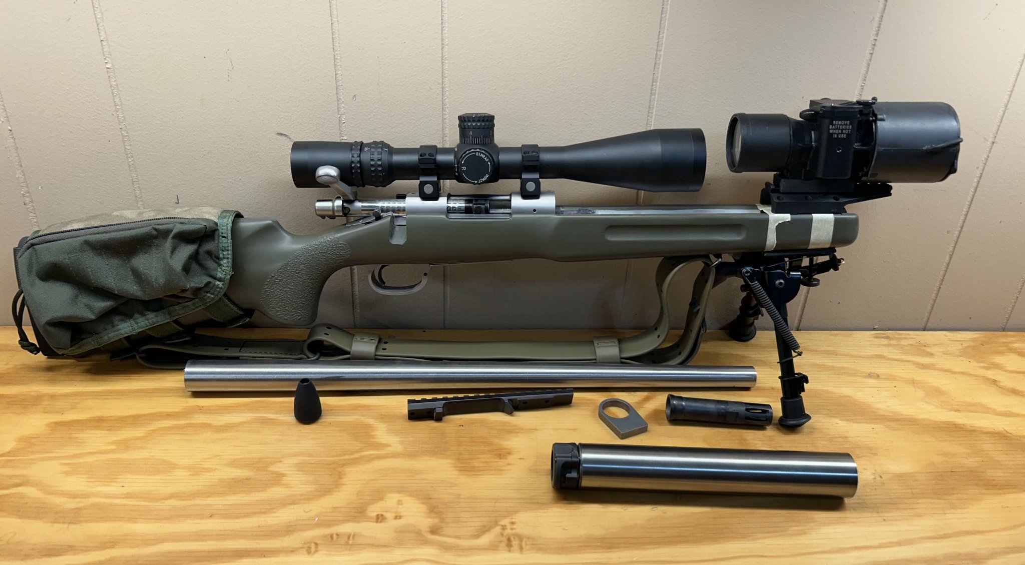

As the following picture shows, that is not accurate. Today I purchased a McMillan XM3 A1-3 stock and will soon have bolt, action, and correct trigger guard for less than $2,500. Total build should be under $5,000 with smithing fees. Why is Type A Rifle Co charging $3-4K over material costs? Also, is a detachable magazine, clone correct?
As the following picture shows, that is not accurate. Today I purchased a McMillan XM3 A1-3 stock and will soon have bolt, action, and correct trigger guard for less than $2,500. Total build should be under $5,000 will smith fees. Why is Type A Rifle Co charging $3-4K over material costs? Also, is a detachable magazine clone correct?

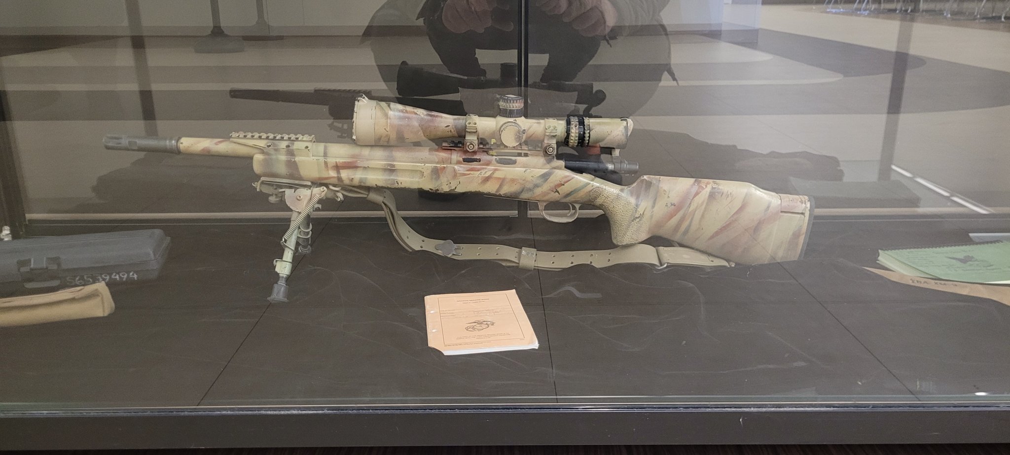

From what I have seen, the rail over the front scope ring is also not clone correct.

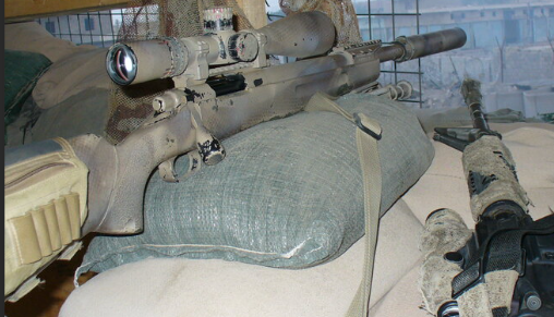

Not to mention the cheek pad that is clearly OD green not woodland camo as Type A Rifle provides. It almost seems criminal to me that a rifle manufacturer would charge the same price to assemble and smith a build as the total price of all parts required for the build.

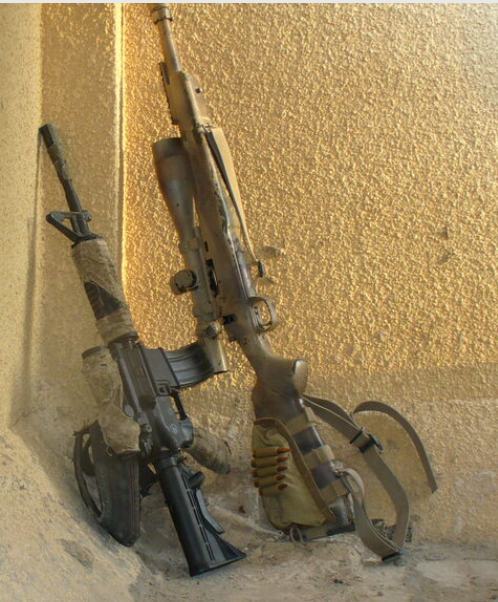

If you want to look at a bunch of actual XM3 photos go to CMPs auction site search title XM-3 then look for the completed tab to the right and it will give you a bunch of rifles you can look at.

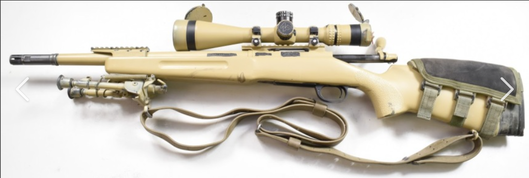

yeah the front EFR was for the night vision. If it has the diving board ring it would have been for the use of a Raptar rangefinder. But I have no idea if they were used or not

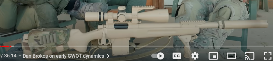

None of the issued USMC XM3's had "diving boards" on the top of the front scope ring. Never.

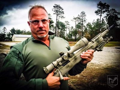

BG Defense/Type A Rifles just made up some nonsense (detachable bottom metal, diving board, etc.) with the rifle they're using for social media promotions. They took liberties with the rifle, no one should ever view as a correct clone. That company is charging about $7,000 or an XM3 that has maybe $3,000 in parts. Typical gunsmithing fees for this type of build is usually about $1,000, but they're charging $3,500+ or so in fees.
That's absolutely ridiculous, and that company should be avoided at all costs. They're trying to charge Tac Ops money for a far inferior rifle. They also make it seem like they're the only ones who can get XM3 stocks from McMillan, which just isn't remotely true, as previous posts in this thread have proven. And they're not even using the correct old S prefix serial number receivers or even the correct muzzle device on their rifles.

I spent a few hours helping @Redwolf505 create an XM3 build list and helping him with sourcing the correct parts he needs for the build. I highly recommend that people spend the time to pick up the parts and just build the clone themselves. That way you'll save thousands of dollars by not purchasing through ridiculous gougers. Stay away from the scammers who are trying to take advantage of this community.

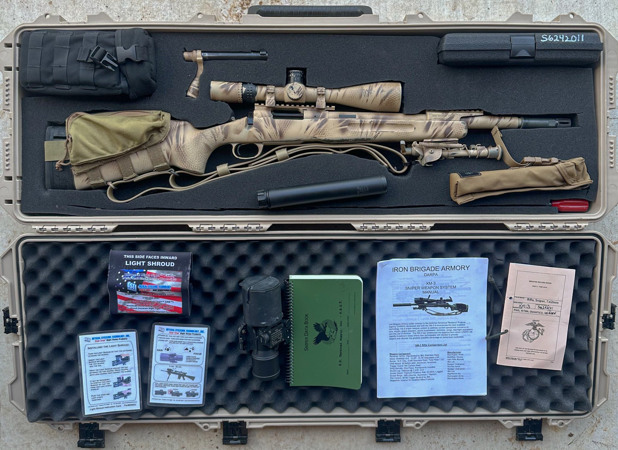

One thing to remember, the SureFire flash hider for the USMC issued XM3's are sterile, there's no markings anywhere on it. Also, the surface finish on the XM3 flash hiders is a lighter color than the civilian flash hiders. So, these are 2 considerations for the XM3 flash hiders:

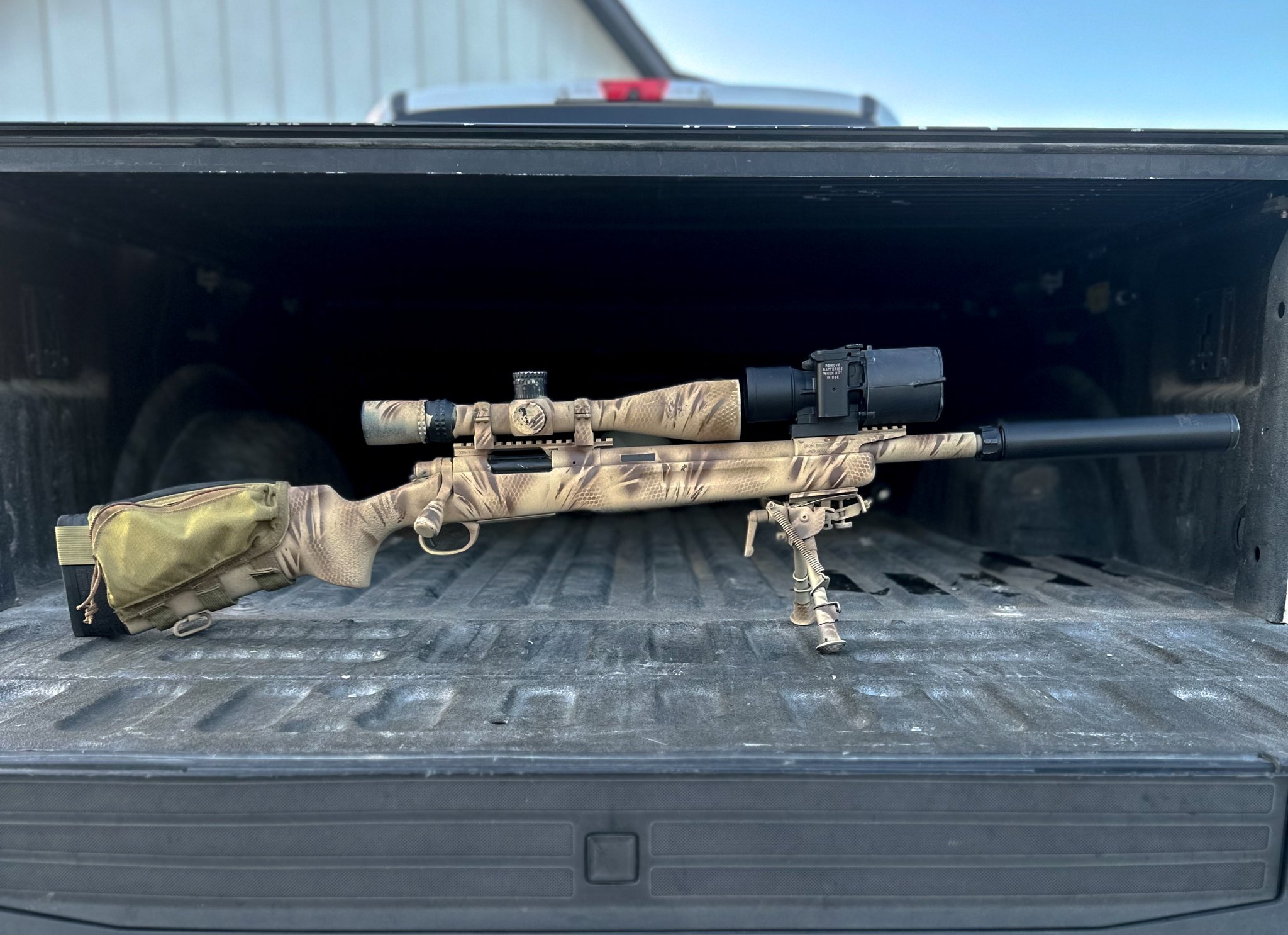

Just added up my parts list.
~$4700 for everything, including the F1 NXS, excluding the pvs22 obviously
Another $1300 Rws quoted me to build it.
Another ~$1000 (including stamp) for my form1 fa762ss clone
