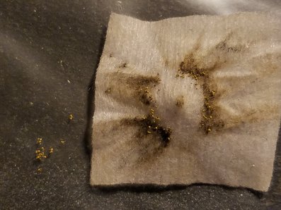

I just got a new Fedderson barrel for my CZ455 and got the chance to shoot it yesterday. As I packed up my eqt, I noticed these little yellow pellets in the barrel and on the muzzle. My suppressor is full of this crap. Ammo was Winchester 30gr. V-Max in 22WMR. Has anybody seen this before? Any idea what it is? I'm guessing primer compound but I'm really not sure. It's gumming up the can bad enough that I'm concerned about a baffle strike. There was a mound of this stuff visible when looking through the bore.

It's unburned powder. Kinda looks like a scaled down kernel of Hodgdon Benchmark..
I've been seeing the same thing in my bore and can for about 500 rounds of the 30 grain vmax and the A22 load.
The striker mod helped some with mine, but whatever that powder is it's borderline inappropriate for the 22wmr.
I'm waiting to see if hot weather makes a difference. Despite the unburned powder, both rounds shoot MOA for me at 100yds..
Thanks for the replies. A little pyrotechnical experimentation confirmed that it's unburned powder. I feel kinda tarded for asking, but it seemed small to be powder... That amount of unburned powder seems EXCESSIVE. Shooting was done at 63F. Advertised MV is 2250; I was getting 2100 to 2140 out of my 21.5" barrel. I wonder if a longer barrel would help alleviate the problem? I think I'll definitely have to do the striker mod. Was hoping to stay away from that as I do use my 455 VPT as a switch-caliber system. But I guess I can just as easily swap out strikers when I swap barrels.

Yep - powder residue/unburned powder. My son uses that ammo and another Federal 30g in his 22 WMR for prairie dogs too. I think they load it hot for performance and with the light 30g Vmax bullet there is a good bit that ends up not burning. He has a Marlin with a 3-12x scope. It is good for routine kills out to about 150y and occasional hits out to 200y. The winds start to mess with it bad past 150y though. We usually transition to the 17's or 223 out past that.
