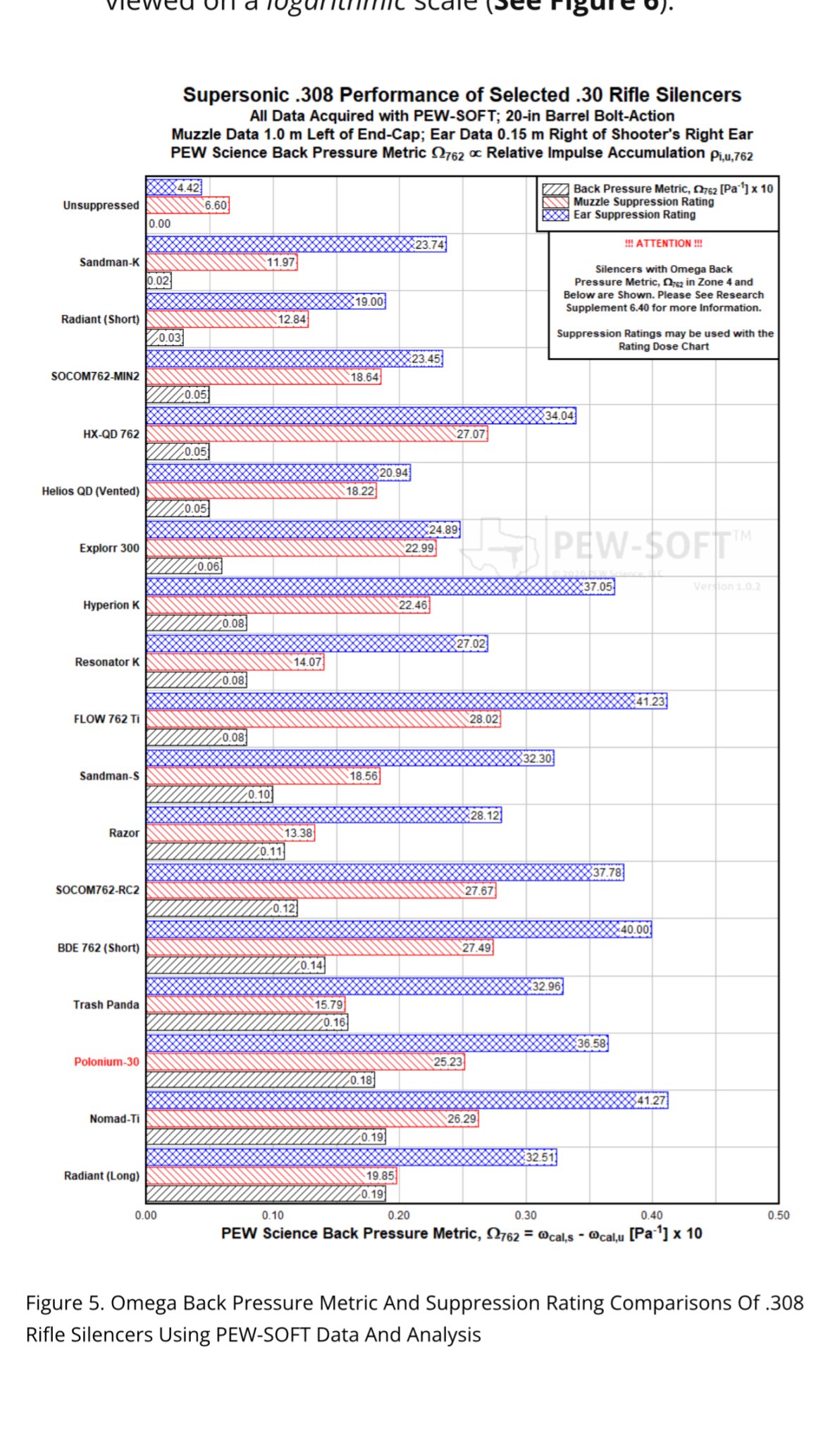

I have and am happy with my SF Socom 2 Mini. It does everything I need it to do. I need another 308 can that will run on a 16” MWS, 18” rifle gas 6.5 Grendel, and 16” 556 middy but Im being cheap and looking at the YHM Resonator K. Size and low back pressure are the main criteria. If you look at the Pew Science back pressure chart, the Resonator compares well to the SF Mini and even outperforms the Huxworks Flow Ti on back pressure.

I am very skeptical that the Resonator K has the same back pressure as the Flow 762.
Maybe I misunderstand Pew’s goofy rating system.
