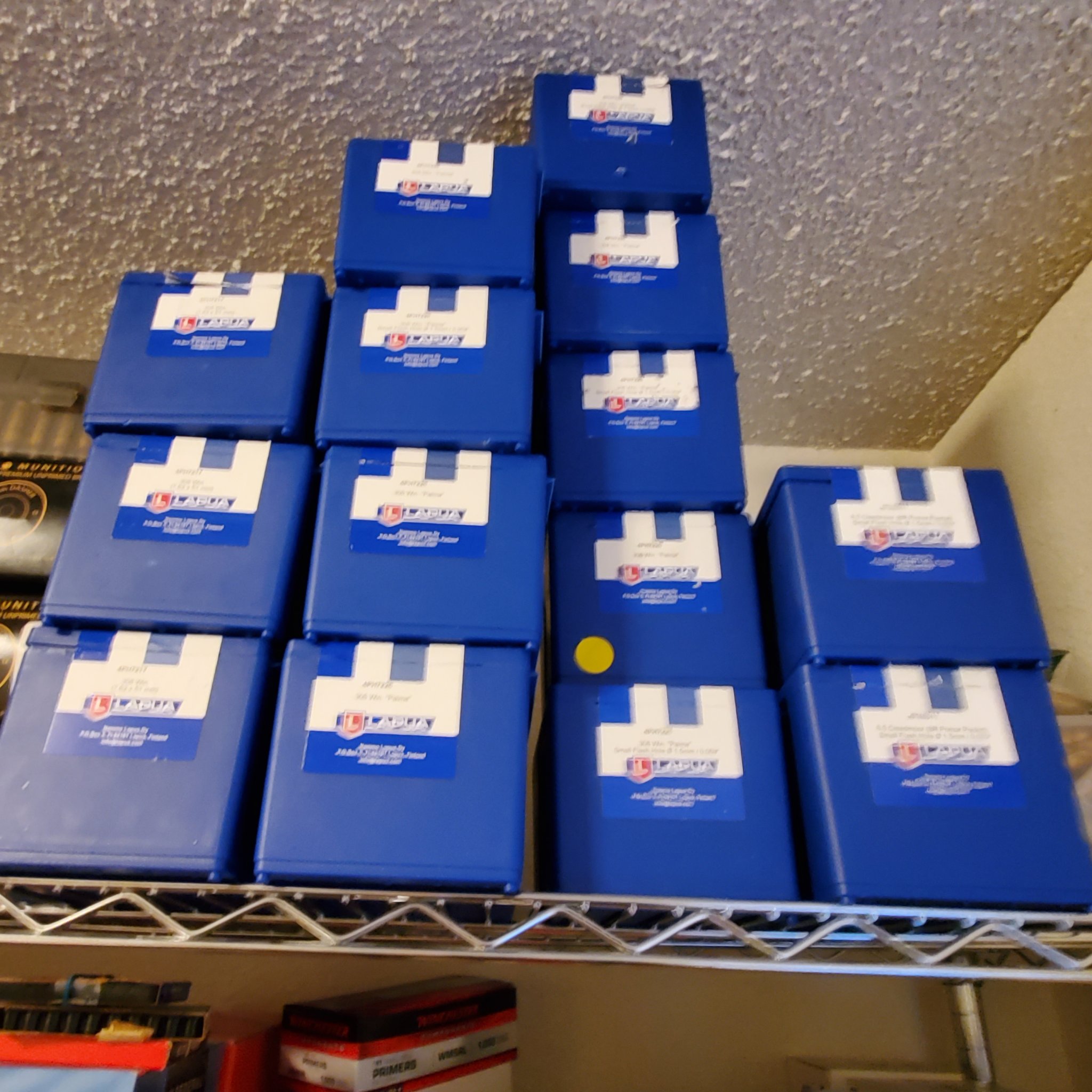

Here are 900 new SR 308 Lapua Palma cases along several hundred 6.5 CM SR plus hundreds in service of both types, plus thousands of Lake City military brass and commercial brass.
The Palma brass works good on standard loads like 308 and Varget, with 450, BR4, or Rem 7 1/2.
Not so much with 230 gr SMK and large doses of ball powder, in 9 and 8 twist barrels....and why most of the orginal 1200 stack of Palma brass are still there and LR brass is way down to 3 boxes.
Plus hybrid cases are now heavily employed, in 308 and 6.5 CM both with Large Rifle primers capable of handling 80,000 psi, and cases full of slow burning powders.
Each combination has a purpose, there is a point where SR primers don't cut it.
