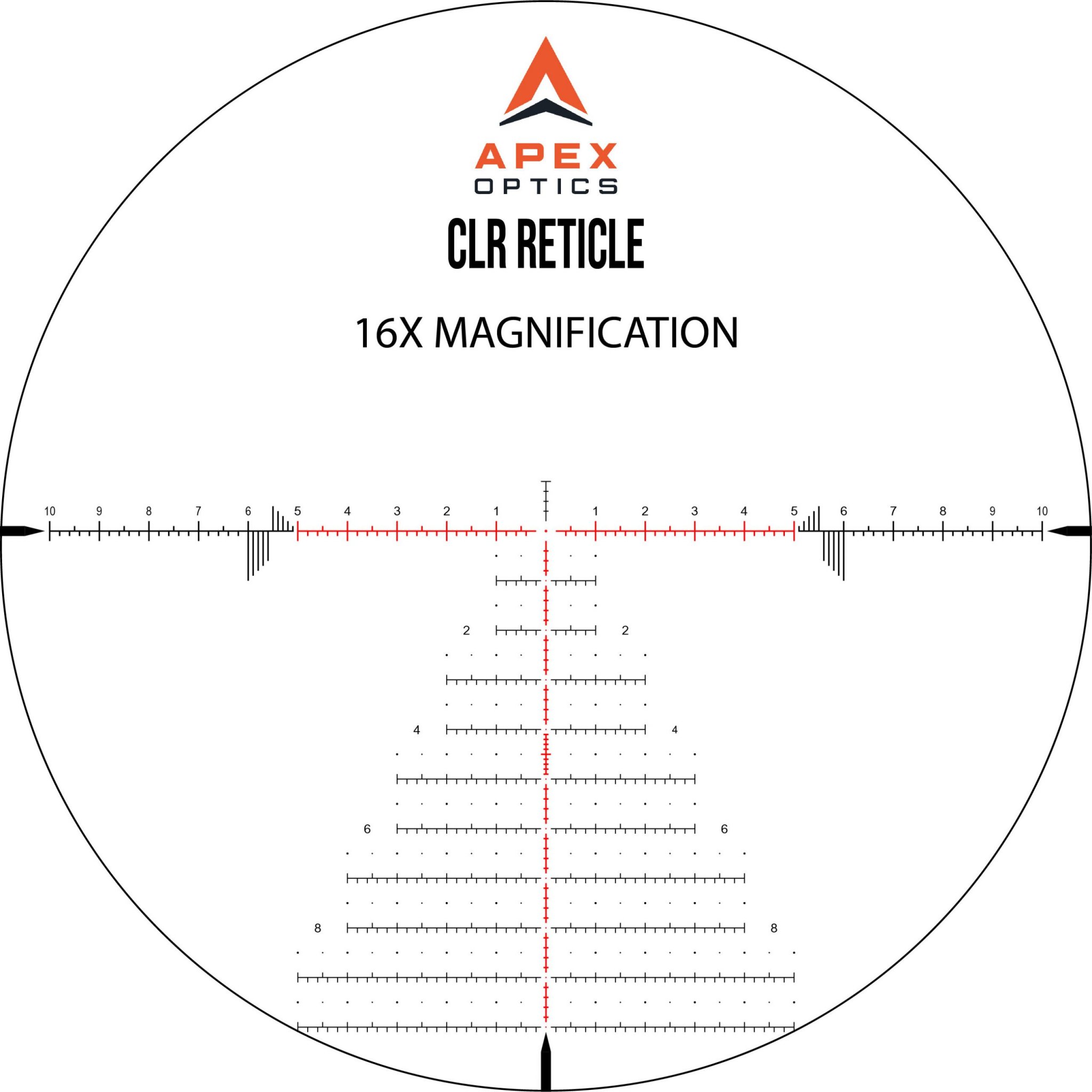

Rifle Scopes Your thoughts on this reticle
Whats the hide say to this reticle?

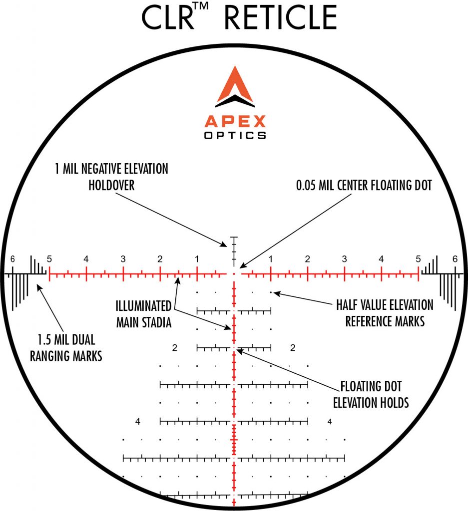

the aiming dots down the main tree vertical axis...
would be interesting to experiment with.
Dont care for the first tree line to be so thick,
prefer that to be a grid of dots or skip it etc.
Reactions: Boon20
Nothing special compared to what's out there
Perhaps reticles similar to this are close to optimum at this point. If you look at all the top reticles on this forum, the most popular ones follow this similar format. I guess I am saying it's not necessarily a bad thing that it looks like a lot of the others. Don't always have the reinvent the wheel if something is working.
I do like the center aiming points at each MIL.
Reactions: Scobes
Yes, but how often is your dope dial to exactly one mil. 2 mil 3 mil? Hardly ever. It looks nice but not anything special compared to what is currently out there and other offerings.
I'm not a fan of the aiming dots at the 1 mil lines.
I AM a fan of omitting the .2 mil hashes closest to the center dot. I like the very center to be free of clutter and this one is excellent for that. If I need a .2 mil hold its usually close to left or right edge of target.
Reactions: Boon20
Smashed the Pre-order button on this one. It’s one of those reticles that when you first see it, you scream out loud “YES, finally!” At least I did. LOL
Not saying it isn’t possible, but I don’t know how one would improve on this particular reticle. I can’t wait for them to be shipped and to get using it! Nice work Apex Optics!
Reactions: Boon20
