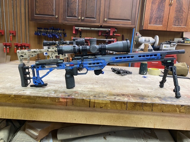

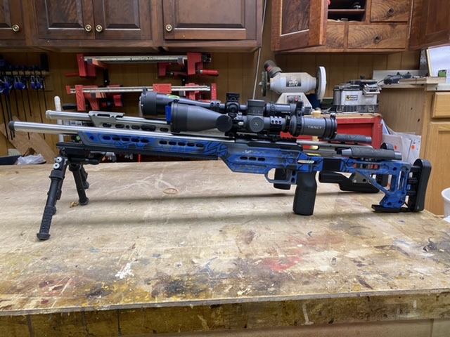

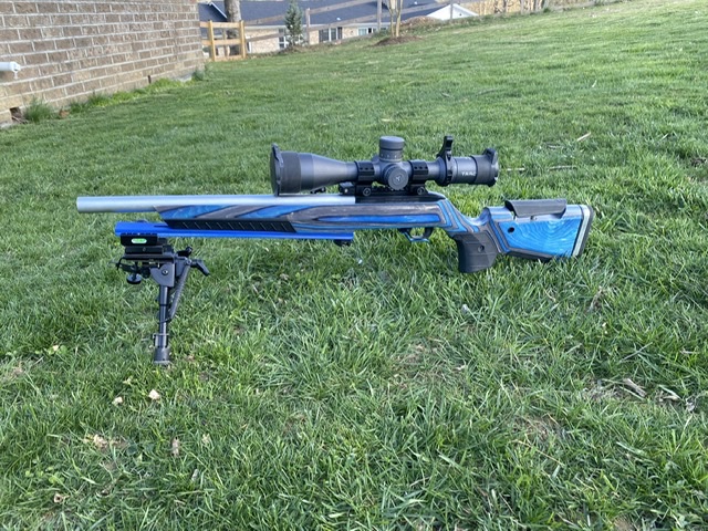

I have 2 sons that shoot precision 22 with me. They are 10 and 12 now. They both started competing when they were 9. We went through a lot of rifles. We started out with a Ruger precision rimfire for my oldest because of the adjustability and cost. He shot that until we felt the rifle was holding him back which ended up only being a few months. At that point we switched to a Tikka T1x in a KRG bravo which he shot for about a year and did really well with. We also found out that the rifle was in fact holding him back. His scores went up dramatically when he switched rifles. With the spacers removed the Bravo fit him pretty well and was light enough that he could move with it. Last year we switched him to a CZ 457 pro Varmint in a MPA chassis with a shortened LOP. This year he has grown a lot so the rifle needed to grow with him. We added a 20” after market barrel to get him a little more weight up front and I had to make a spacer to lengthen the stock a little. The big thing is getting something with the proper LOP that is light enough that he can move safely. For my younger son the solution was a 10/22 with a lightweight whistle pig barrel in a Boyd’s AT One stock. Both the AT One and Bravo have a 12 1/2” LOP at their shortest length. My youngest just graduated up to a tikka in a Bravo this year however. He is a lefty which is why we started him with the 10/22. We are still waiting on the lefty Tikka to come be available in the US but he is actually pretty good with the right hand action for now. The big thing was the bolt slowed him down a little which in his case was a good thing. He tended to rush with the semiauto.
Here are the boys rifles.
