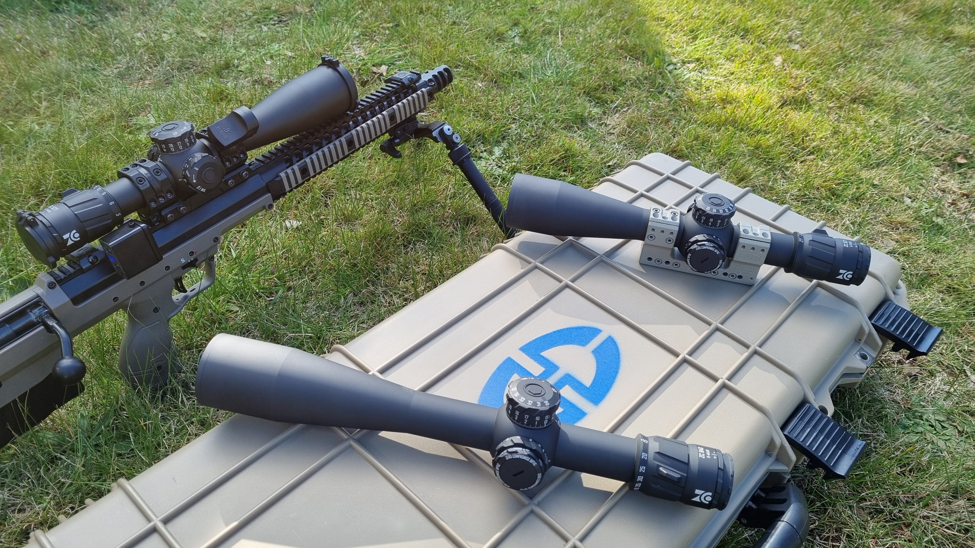

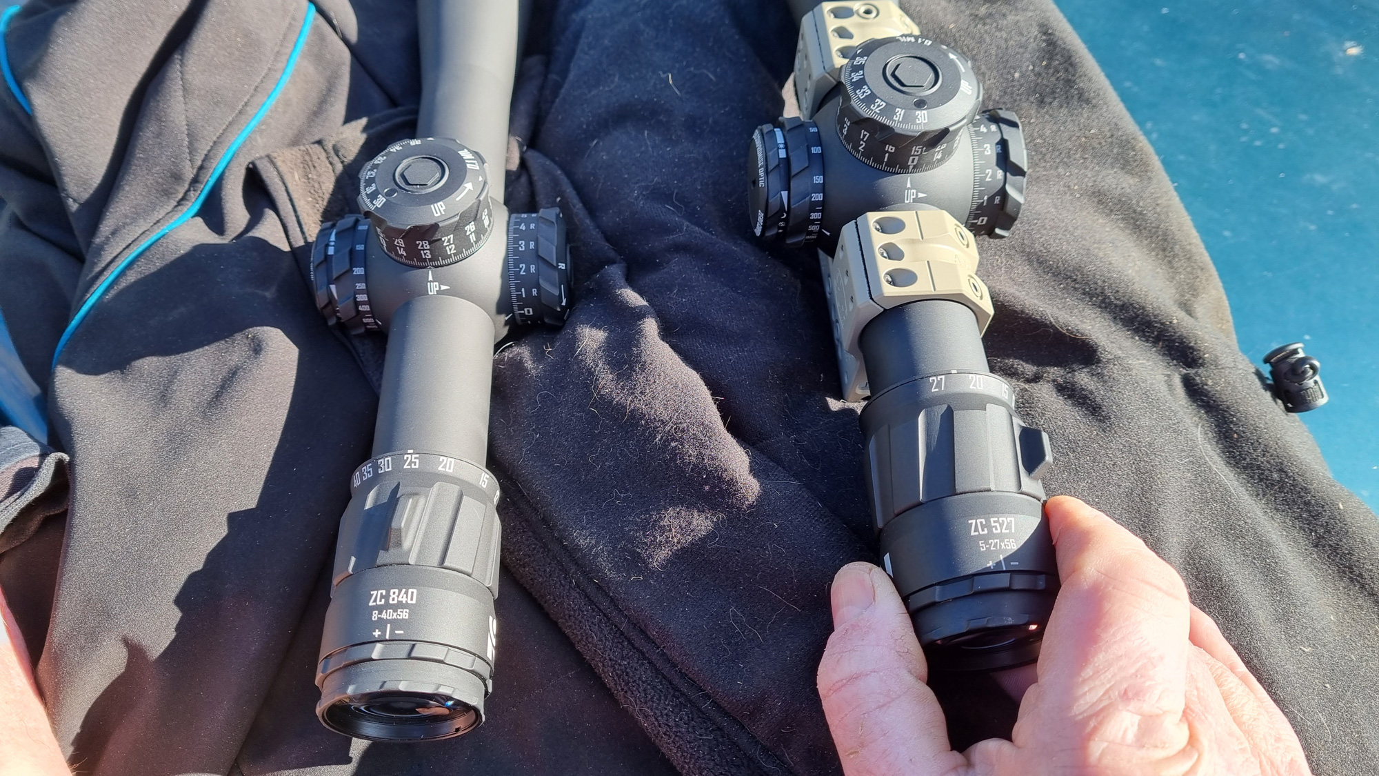

The 5-27 is a far better scope than the 8-40!! The 8-40 really loses it after 30x ..
Reactions: CK1.0
I have both and I have not seen the fall off on any of mine. I love both, and they suit different use cases for most. Most of my ARs wear 5-27s, one is an 840. my one zco rimfire is an 840 and my precision bolt rifles are 840s. I really can’t tell a big difference in terms of optics quality. If I was an active PRS shooter I might pick the 527 as it is shorter and at 20-25X you see less “wobble”. At 35-40x I would have to drop a RMR on top to do target acquisition.
Not sure way better, I have multiple copies of each, I think the 527 is slightly better at 27 than the 840, but not that much. My rimfire ZCO is an 840 (MPCT 1x). For PRS shooting many prefer the 27X but ZCO rimfire PRS shooters are moving towards the 840. all my ARs wear 527s, my bolt rifles wear 840s, in real use they are equal in construction/optics and visual loveliness.
which would you say has better FOV at 27 power? 20 power?
I will only add my thoughts on my 8-40...it is easily the brightest scope I have ever looked through. makes my tangent look dark. Not sure if thats good or bad...during bright snow on ground days this spring it was borderline bad lol. but i have no sunshade which would have helped alot. its on a rimfire now.
