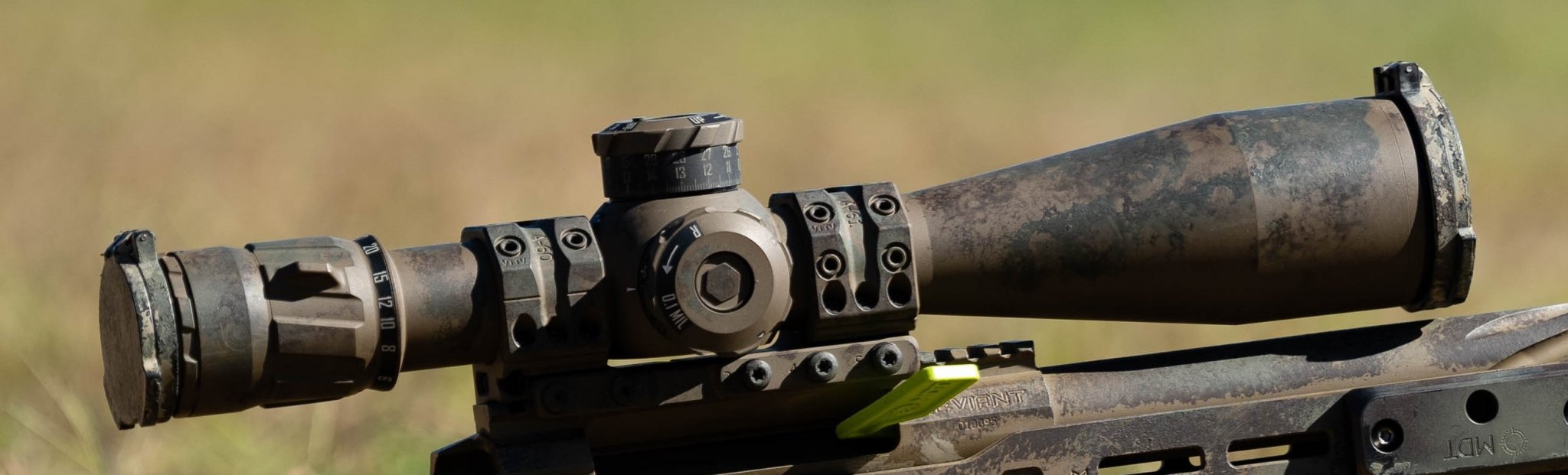

I have Spuhr Uni’s on all my ZCO’s and am delighted with them. No issues.

If your rail has 20moa then you dont need a unimount. So you have a wider choice of mounting heights available to you and that should be the driver of the choice. Had good luck with either Tier 1 rings or better yet the ZCO rings.
The Spuhr mounts have issues and if I had a comparable choice I wouldnt choose Spuhr.

The screws are a soft pot metal that dont respond well to multiple cycles.
The length of the bearing surface can cause crush issues on scope body, resulting in internal mechanisms binding. Do Not use the recommended torque specs of the rings.
The very short length only provides about 0.33" of fore/aft movement available to the scope, hope the rail has enough slots to position the scope because the mount doesnt. This (along with the length of the rings) also presents the problem of not being able to move the scope to avoid the above mechanical problems.
I'm not saying the mounts wont work, mostly, sort of, sometimes. I'm using one (for now) because of the trade off between those issues and the height requirements/desires. But every one of the above issues is a problem to be dealt with and monitored. If I could find a 20moa mount below 1.20" I would probably choose it instead.

I purchased one used which developed a crack in the clamp bar for which spuhr sent me a free replacement when I wrote and asked to buy a spare since that mount was no longer in their spares catalogue. on a few older used ones I will be replacing some screws, but on the ones I bouht new there are zero problems. I use 45 and 25 inch pounds and fresh bits.

Have only two, so my sample size is smaller than most, but haven’t had any issues with Spuhr mounts. If not going by the 15-25 in-lbs ring torque specs recommended, what are you using?
