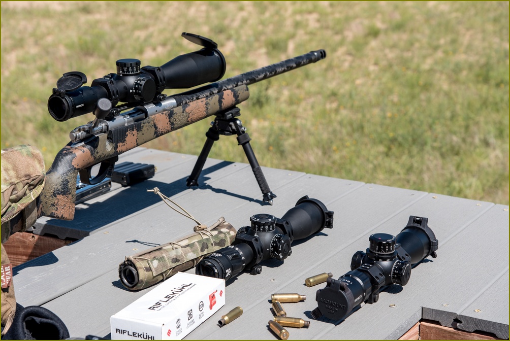

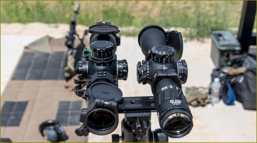

    The Scopes
    One might ask, why didn’t I include some other Ultra Shorts and there is one reason - I wanted to stick with alpha class (sorry Leupold Mark 5HD and others, you simply aren’t there). Why did I include the Minox ZP5 5-25x56 and 3-15x50 – very simply the ZP5 5-25x56 reigns as the best scope I’ve ever looked through (I have not experienced Tangent Theta, but I have experienced Premier and all three are sisters when it comes to the original design by Optronika) and the ZP5 3-15x50 represents the closest we had access to that would be close to the venerable TT315 series, that being said, I tend to view “Ultra Short” designs as having magnification greater than 16x but in a tube shorter than traditional scopes of the same magnification so we use the Minox ZP5’s as more of a baseline here.

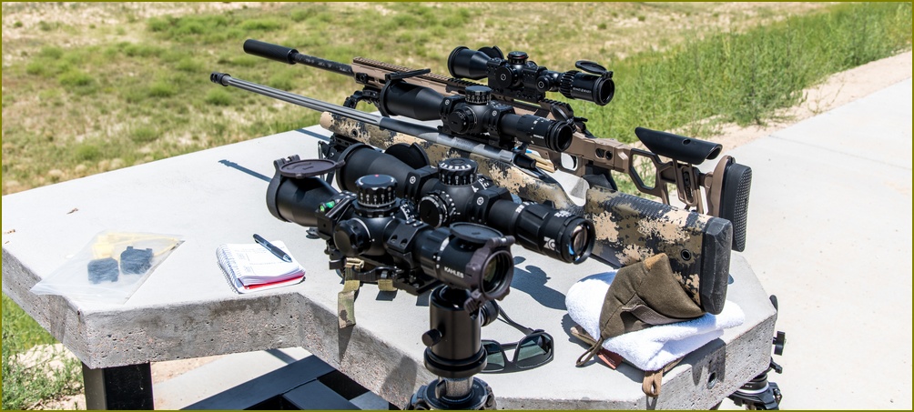

    The Purpose
    The purpose of this evaluation is not to give you any kind of “long term” results but simply to identify “initial impressions” of areas that are sometimes identified in spec sheets like the one above, but often times there are features to scopes that simply have no spec but do make a difference for the discerning long range shooter. The ultimate goal was to evaluate the brand new ZCO ZC420 that has just begun to hit the market, essentially, does the ZCO live up to its hype – “Zero Compromise Optic” and can this new manufacturer really put out a scope worthy of being considered “alpha” quality. Well that’s exactly the question that we set out to answer, and when I say we I’d like to give a huge shout out to @jwknutson17 who was kind enough to join me at my 1000 yard range and bring some scopes with him, it was great to put some rounds down range and have fun with optics, I also typically do these evaluations alone and rely on only my eyes so it was nice to have a second set of eyes and see if we both agreed (which you’ll find below, we sometimes didn’t).

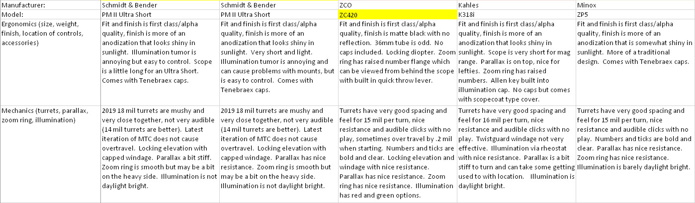

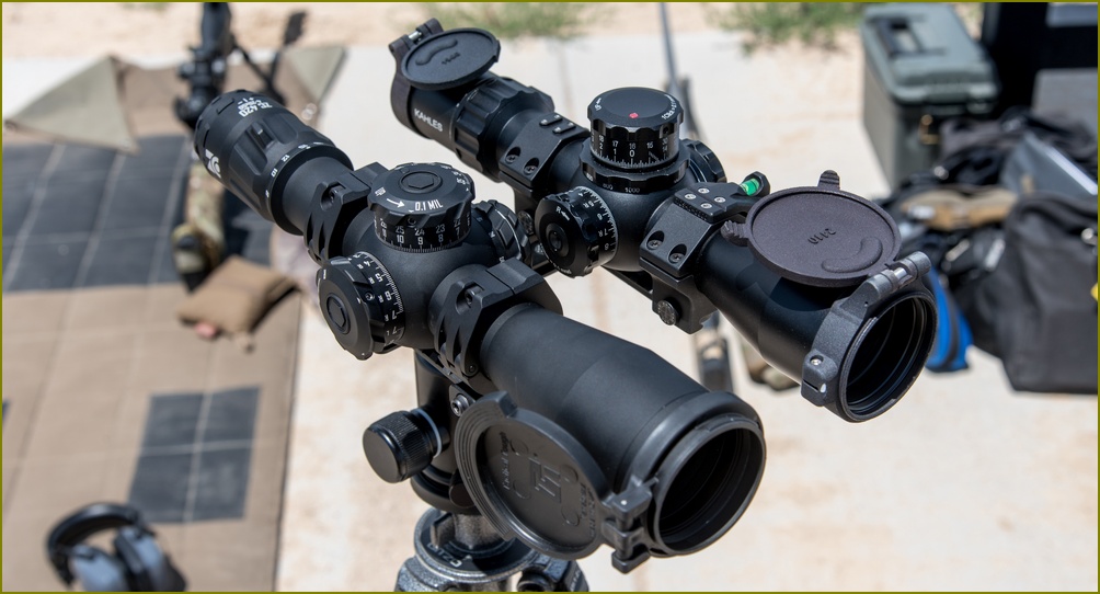

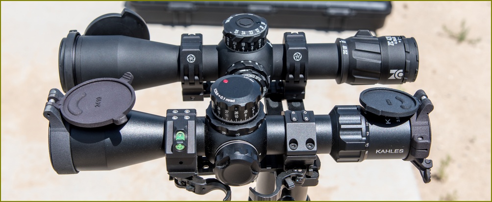

    Ergonomics and Mechanics
    I define ergonomics of a riflescope as the overall fit and finish along with how easily accessible certain features are. I define mechanics of a riflescope as the “feel” of certain controls and their usability and repeatability. Older versions of the Schmidt & Bender low profile Ultra Short turrets had too much resistance with MTC and would cause over travel by sometimes .2 mil, new 2019 18 mil turrets were too mushy for my taste and provided very little tactile/audible feedback, the 14 mil turrets have much better tactile/audible feedback and some 18 mil versions are better, I am still bothered by the big illumination tumor and wish Schmidt would come out with a PMIII version with illumination next to parallax like most other mfr’s have adopted. ZCO had the best overall tactile/audible feedback but the Kahles and Minox were not far behind. Keep in mind I am not a turret purest, unless a turret is really bad I have no issues getting by with it. The locking turrets on the ZCO have the best resistance I have experienced, Schmidt is not bad and neither is AMG but ZCO seems “just right”. Keep in mind that ergo and mechanics can be very much subjective and will be based on the user and their preferences/biases.
    Ergo and Mechanics rankings: ZCO ZC420 4-20x50 > Minox ZP5 3-15x50 >= Kahles K318i 3.5-18x50 > Schmidt US 3-20x50 >= Schmidt US 5-20x50

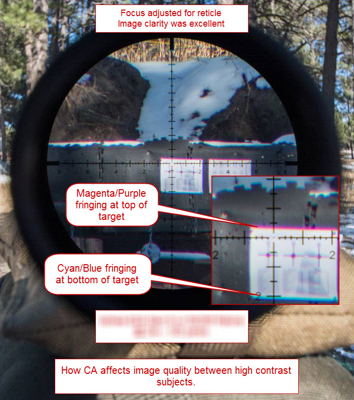

    That dreaded CA
    Some of you are thinking “why so down on California?”, but while I have my issues with California (I grew up there) what I mean by CA is Chromatic Aberration. For those who still may not know what this is I recommend you look it up, or better yet just follow this link to a great explanation - https://photographylife.com/what-is-chromatic-aberration. We can argue “‘til the cows come home” on whether or not CA has a negative effect on the usefulness of a riflescope, after all, we are not taking pictures through our scopes (well… actually I am, but only for this review), put plain a simple - CA bothers some people more than others (and if you haven’t noticed CA in your scope I’d recommend you not try to find it). Will CA cause you to miss a target? Doubtful, but it does have an effect on micro contrast as well as scotopic vision when the light gets low that could, in fact, degrade image quality (IQ), and let’s face it, when we are paying this much money ($3000+ for all these scopes) we are expecting to get the utmost in IQ. Because CA does bother me, especially in high end optics it is something I look for and evaluate. I did a review of the Kahles K624i Gen III when it was first introduced and I soon realized that scope performed very poorly when it came to CA, so much so that it affected the low light performance when I was comparing to other scopes with smaller objectives, and if there was any hint of snow on the ground (I live in Colorado) the annoying purple fringe was all over the place.
    CA usually rears its ugly head the most with high contrast situations so having something white with a dark background will usually induce CA more than say green grass in front of brown dirt, but as previously mentioned CA can affect IQ even when you don’t “see it”. For those who still may be missing the concept here, take a look at the below image showing what CA looks like (Note: This is not from a scope within this test):
    7116355
    Enough background, let’s get down to how these scopes performed. I will preface the results by saying this – all of these scopes performed extremely well when it comes to controlling CA, I have seen much worse scopes, and ultra short designs prove to be a challenge for the optical engineer to create an optical formula that is going to perform similar to that from a more traditional (longer) scope. I would be perfectly happy with the CA performance of any of these scopes, but that being said, this is an evaluation, so let me share my thoughts along with some through the scope images.
    Speaking of “through the scope” images, I will give my typical disclaimer: DO NOT USE THESE IMAGES as an indicator of the IQ of any of these scopes (in fact, don’t use any image on the internet to do so), riflescopes are designed for the human eye, they are not designed for a camera sensor and as such if I do not hand hold the camera perfectly you may begin to see optical aberrations in the resulting images, these are NOT indicative of the scopes design but of my own shakiness and/or misalignment. Also, do not use these images to judge how bright or dark a particular scope is, while I set my camera to manual, I forgot to set the ISO to manual and with different overhead conditions (clouds coming in and out, etc.) the resulting image may have compensated, I assure you all these scopes appeared very bright.
    Did we see some CA through these scopes, the answer is yes but it wasn’t “in your face” as some scopes exhibit. Now let me make another disclaimer: Images taken through a riflescope using another optical system (like a camera and lens) are not an “accurate” representation of what you see with the naked eye. So, don’t take images you find here or on the internet and immediately discard any particular scope because you see a heavy purple fringe along the edge, because CA is compounded by the fact that the camera lens also exhibits CA and if you are not perfectly centered to the scope, being offset might induce more CA than usual.
    To my eyes, both Schmidt & Bender’s seemed to have the most apparent CA of the bunch, followed by the Kahles K318i which seemed very close to the Minox ZP5 3-15 but the surprise was the ZCO ZC420 which showed very minimal CA, and if we’re nitpicking (which I am) I felt the ZP5 5-25x56 was still the best overall, that being said the ZC420 being an Ultra Short design was very impressive that it bested all the rest and came very close to the traditional design on the 5-25.
    CA Rankings (including ZP5 5-25 as baseline): Minox ZP5 5-25x56 > ZCO ZC420 4-20x50 > Minox ZP5 3-15x50 >= Kahles K318i 3.5-18x50 > Schmidt US 3-20x50 >= Schmidt US 5-20x50

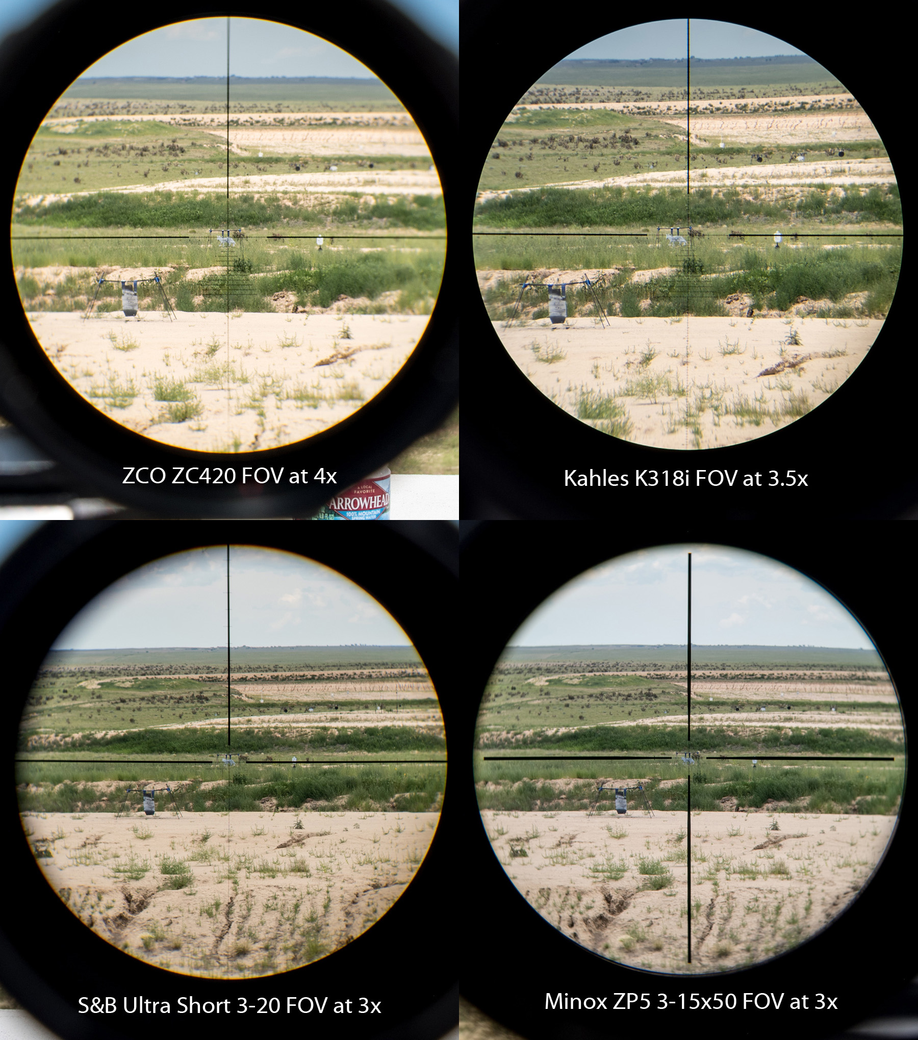

    Probably one of the most overlooked factors within any scope design is FOV. If you look at the specs above you’ll see some different numbers even though some share the same magnification, and in the case of the ZC420 and K318i, you’ll notice that the FOV is larger for the ZCO at 4x than it is for the Kahles at 3.5x. Optical design or “formula” plays a big part in FOV and I’ll take a scope with greater FOV over a scope with lower magnification almost every time (all other things being equal). Tunneling can also have an effect on FOV and I can assure you that none of these scopes exhibit any noticeable tunneling. With FOV I think the mantra “a picture is worth a thousand words” holds true, so instead of boring you with my diatribe I’m going to let the images speak for themselves (I will throw in a few notes here and there), but once again please do not use these images to get an idea of the IQ/Optical performance of the scope, all the scopes performed extremely well in this regard.
    Note: Due to lack of time we did not include the S&B US 5-20 in these tests. Also, we tried our best to keep the center of the reticle in the center of the steel coyote; however, some images were a little off but hopefully still show off how much, or in some cases how little, each scope is capable of. Keep in mind that outside of the lowest and highest magnification settings we used the indicator on the zoom ring as best would could to dial the appropriate magnification, user error and/or incorrect numbering position can play a factor in the actual magnification. Finally, these images were taken when clouds were coming in and out so do not judge one image as brighter or darker than another.
    3x FOV Test: Since the ZCO and Kahles cannot go to 3x I’ve used their lowest magnification settings respectively to represent the widest FOV capable for all these scopes.
    7116066
    The clear winners here are the Schmidt & Bender and the Minox as they are the only scopes that go to 3x, by mfr specs the Schmidt has a slight edge in FOV. It is no surprise (based on specs) that the ZC420 has slightly more FOV than the Kahles even though it is 4x vs. the Kahles’ 3.5x (some may note the image of the Kahles appears to be more magnified than that of the ZCO; however, all images were resized to provide the same sight picture and thus provide a side by side comparison to FOV, this is not a magnification test, but a FOV test).

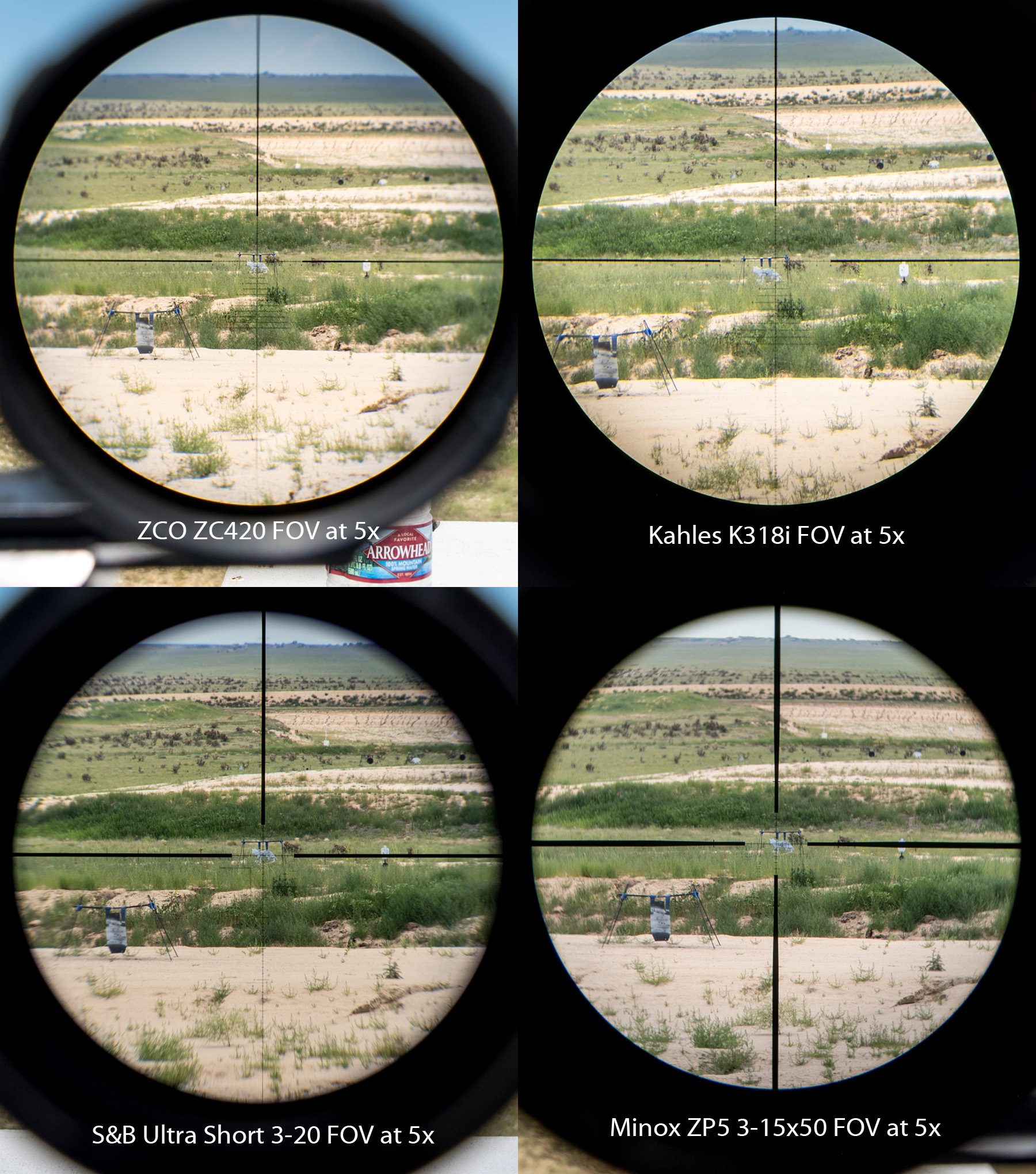

    5x FOV Test: Now things start to get interesting since all these scopes can handle 5x. Once again the Schmidt and Minox appear neck and neck, but the real surprise is it seems the ZC420 may actually have the most FOV of them all. The K318i continues its trend to have the least FOV and by a considerable margin compared to the ZCO.
    7116070

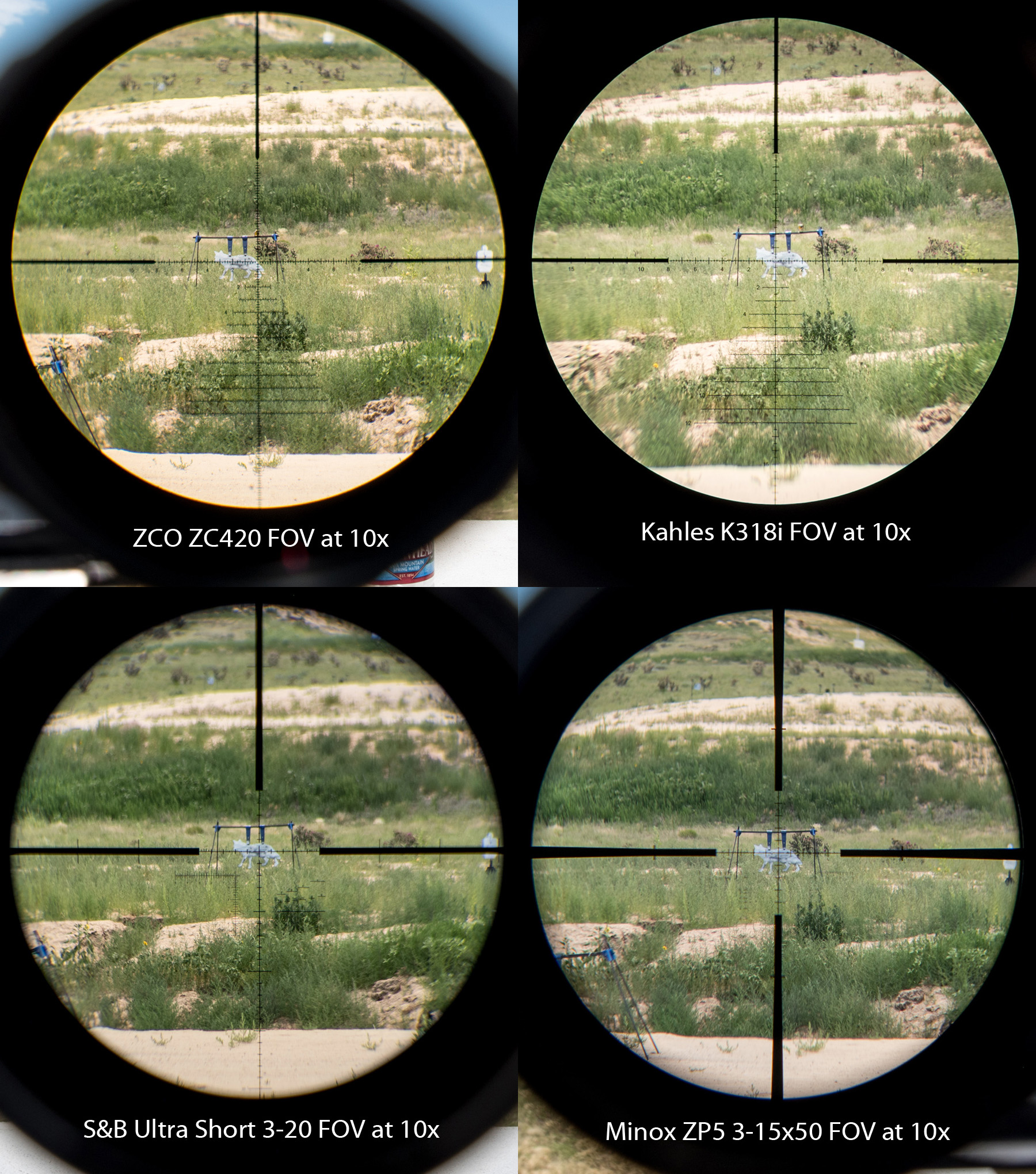

    10x FOV Test: Interestingly enough, at 10x the Minox seems to have pulled ahead and yields the most FOV out of the bunch but the ZCO is not far behind and might even match the Minox if it weren’t for us being a bit “off” in center crosshair alignment on the coyote. The K318i is lagging once again and still provides the smallest FOV of the bunch.
    7116071

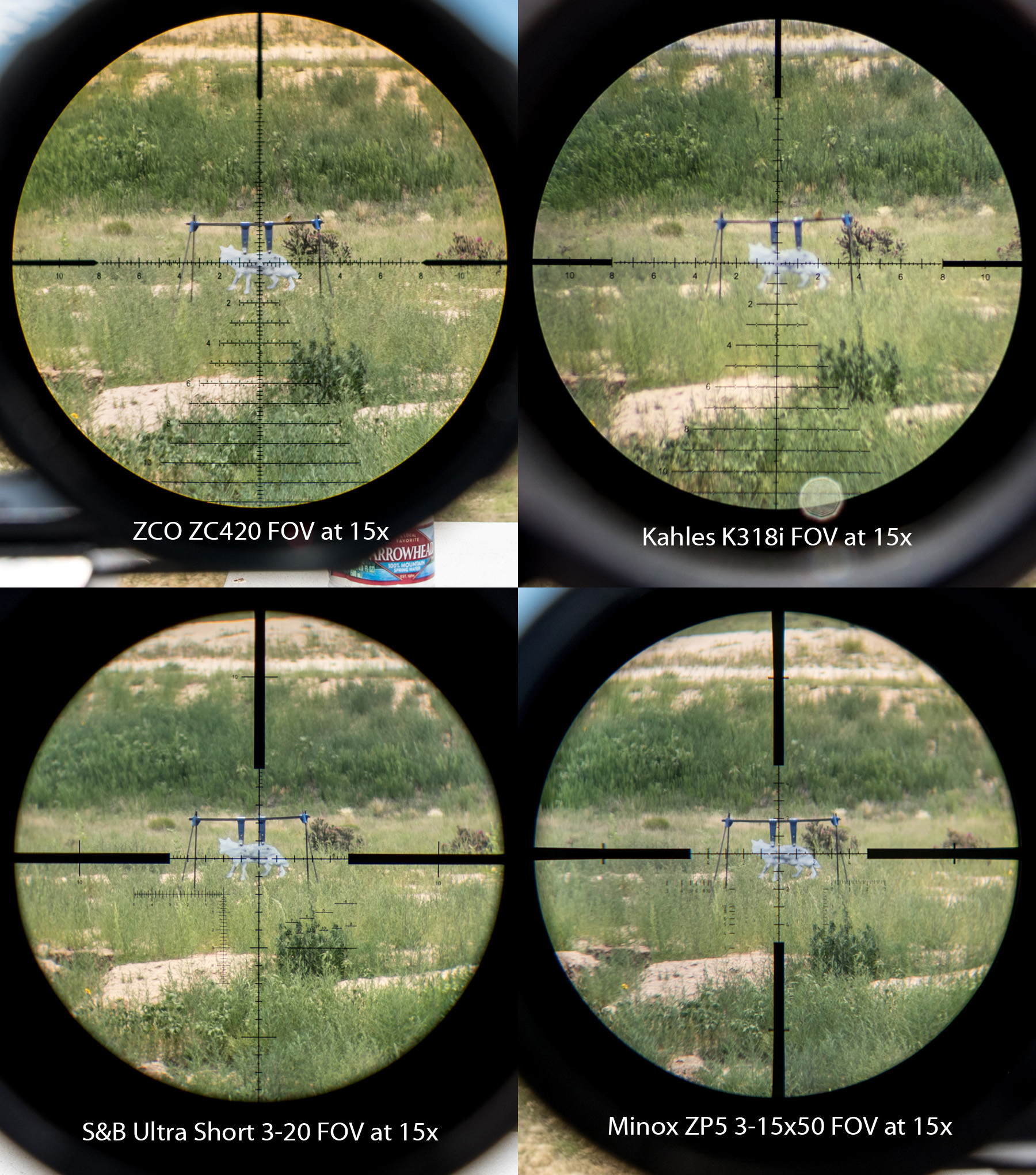

    15x FOV Test: Let’s call this the “sweet spot” of long range shooting. More often than not atmospherics and mirage play a big factor in dialing down our scopes, I probably use 15-20x more often at long range, while 20x and up I usually use when I’m doing closeup paper punching. In the image below, I notice a slight difference in magnification between images which may be due to precise setting on the zoom ring. Here the Minox seems to have the advantage but the Schmidt and ZCO are not far behind, good news for the Kahles as it seems to have gained some and appears to be picking up. (Note: you may notice a yellow banding around the outer edge of the ZCO’s sight picture, I was able to observe this through the scope with my naked eye when I was in certain eye positions, I’d like to follow-up with jwknudson17 to see if this disappears once mounted on the rifle or if any other ZCO owners have noticed this phenomenon with their scopes.)
    7116072

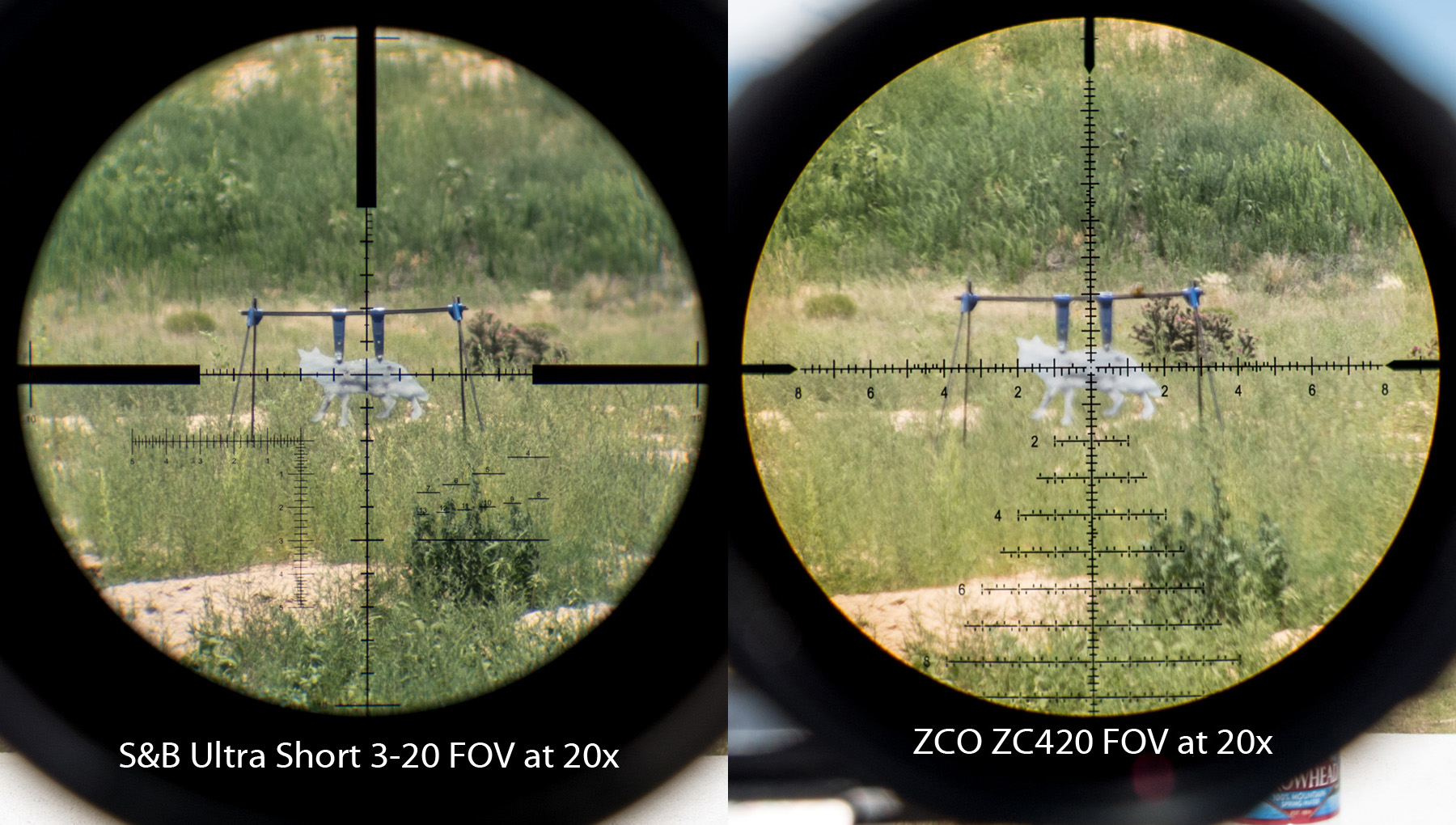

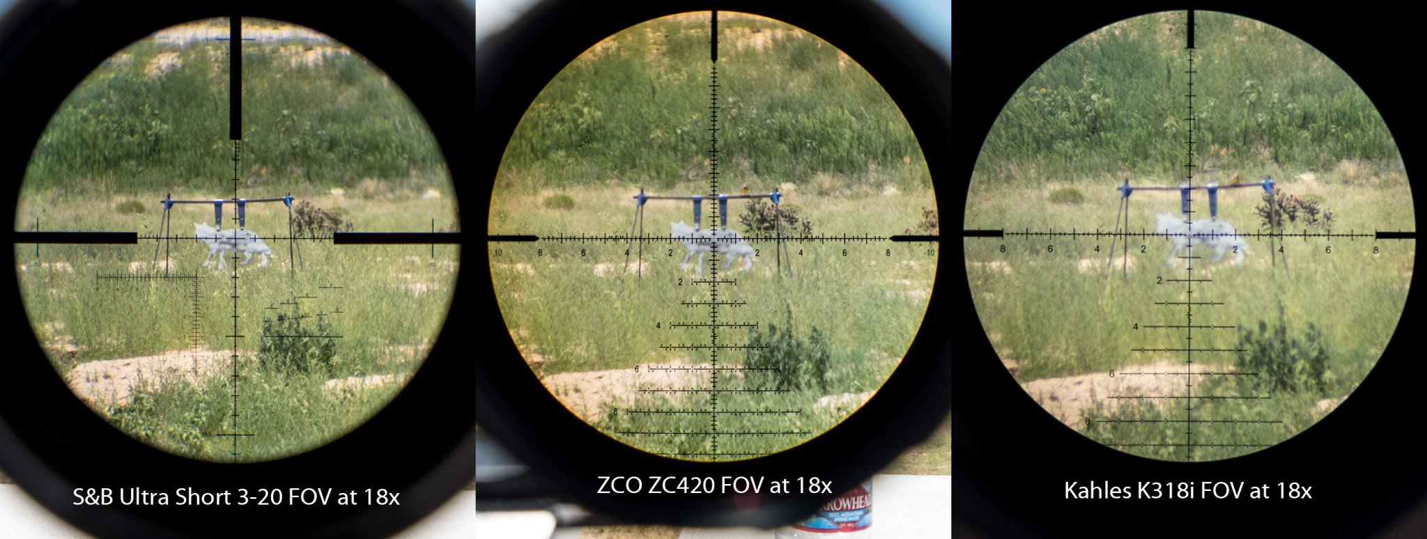

    18x FOV Test: The max for the K318i and above what the 3-15x can handle (hence its absence from the image), once again the ZCO and Schmidt seem really close with maybe a slight edge to the Schmidt, but the Kahles seems to have fallen out once again even though the reticle is off to the right slightly we clearly don’t see as much.
    7116074
    20x FOV Test: The Kahles drops and we see the Schmidt and ZCO at their top magnification. With this image we can see that the two scopes are not on the same plane which may be causing somewhat of an optical illusion when determining FOV; however, it seems the Schmidt has a slight edge in overall FOV and specs would also indicate this.
    7116075
    FOV Rankings: Schmidt US 3-20x50 >= ZCO ZC420 4-20x50 >= Minox ZP5 3-15x50 > Kahles K318i 3.5-18x50
    Lessons learned: I realized after the fact that the scopes were not all in the same location which caused some of the objects within the site picture to appear "offset", in future tests I will try better to ensure that each scope is centered and mounted in the same location.

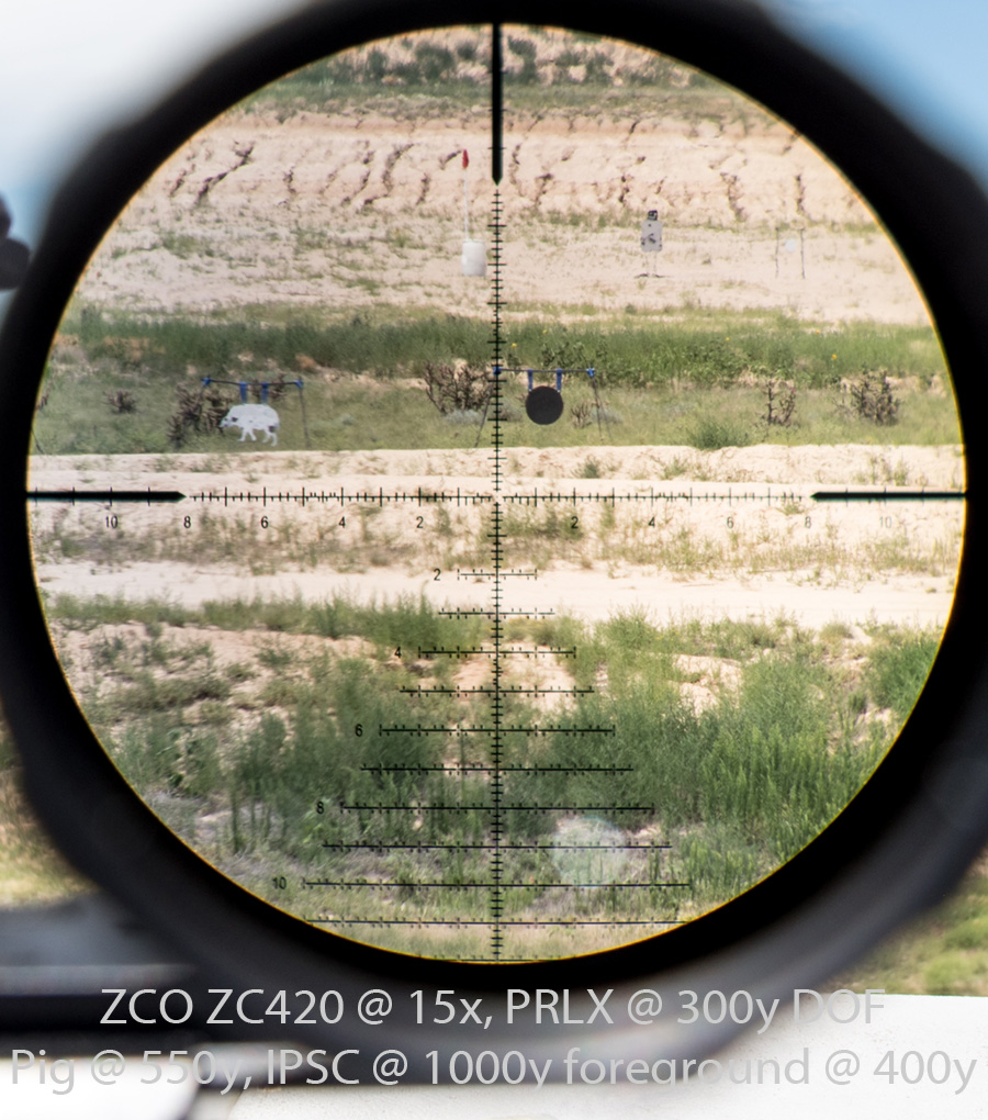

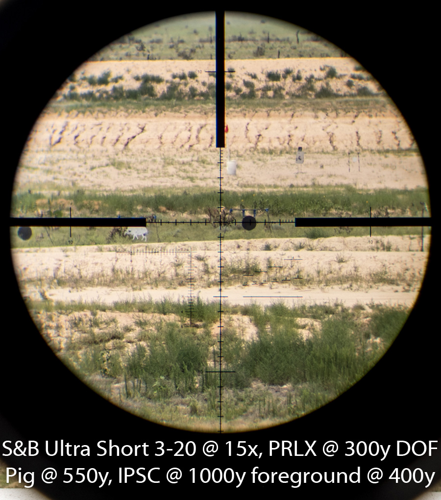

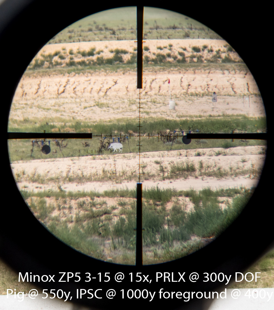

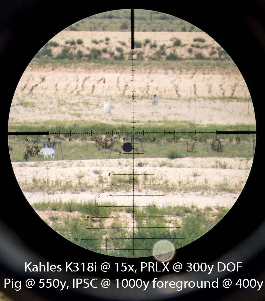

    Depth of Field (DOF)
    DOF is another often overlooked feature within riflescopes but can make a huge difference under field conditions. That little dial, usually on the left side of your scope, is sometimes called the side focus; however, this dial is really to ensure that your reticle is parallax free at a given distance, with a well-designed scope your focus and your parallax should go hand in hand. In brief, parallax is an error with your reticle in relation to your eye position, think of getting behind your scope and seeing your crosshairs dead center of your target and you notice your Point Of Impact (POI) is off by .2 mil or more, you might blame wind or say you pulled it etc. but it could also be parallax error and even though it looked like the reticle was dead center it was actually off. It’s easiest to induce parallax by wiggling your eye position behind your scope, if you do that, do you see your reticle move within the sight picture while the background stays the same? That is parallax and now you have to fiddle with the parallax dial until that reticle stays solid with relation to the background. Some scopes are more finicky than others and require a lot more parallax adjustment than other scopes with a greater depth of field. For this evaluation we set the parallax on all the scopes to 300 yards (some don’t have markers so it was our best guess) and then we set magnification to 15x and placed the scope so the sight picture had objects both near and far, not only did we look to see if these objects were in focus but we also checked for parallax to make sure the reticle did not change with relation to our eye position. I call this the “set it and forget it” setting because you can shoot the majority of near and far objects without ever having to fiddle with that parallax. I’ve struggled to even consider putting up images because it’s so hard to get my camera to focus properly through the scope that any blurriness you might see in a picture was due to the user and not to the scope. Jwknudson17 and I were in agreement that all these scopes showed exemplary DOF and this is one area where we disagreed on which we thought “looked” the best. One final thought, this was a hot day in Colorado, I’d say mid 90’s and mirage was quite heavy and each of these scopes had outstanding IQ and depth even through the mirage.
    7116077
    7116078
    7116080
    7116079
    DOF Rankings: Schmidt US 3-20x50 = ZCO ZC420 4-20x50 = Minox ZP5 3-15x50 = Kahles K318i 3.5-18x50
    I’ve ranked them all as equal, I thought the ZCO and Kahles looked best at all ranges and jwknudson17 thought the Schmidt looked best. This is further evidence of “in the eye of the beholder”, all these scopes are so good in so many ways that you won’t make a wrong decision by choosing one over the other.

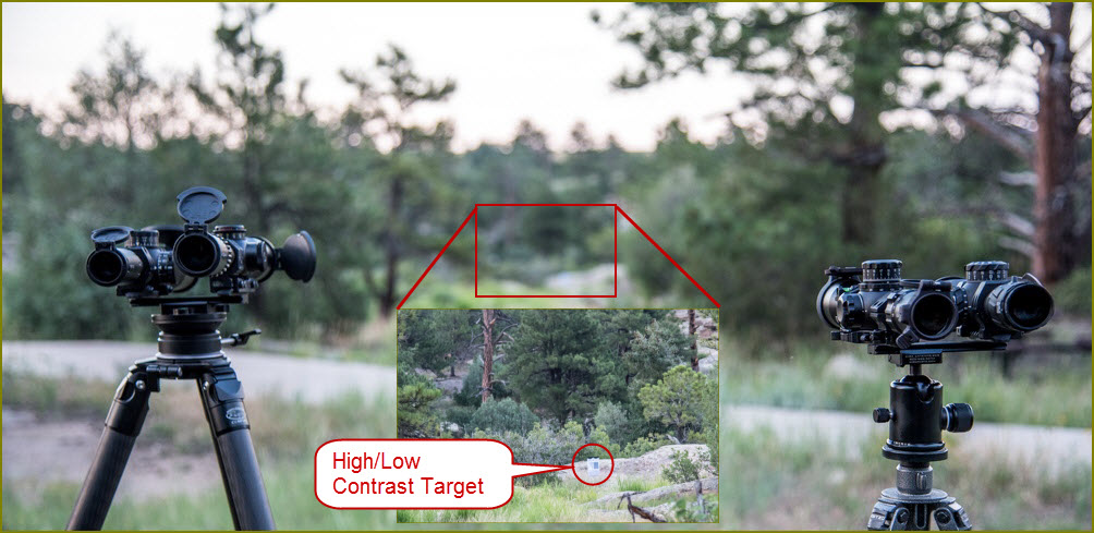

    LOW LIGHT EVALUATION

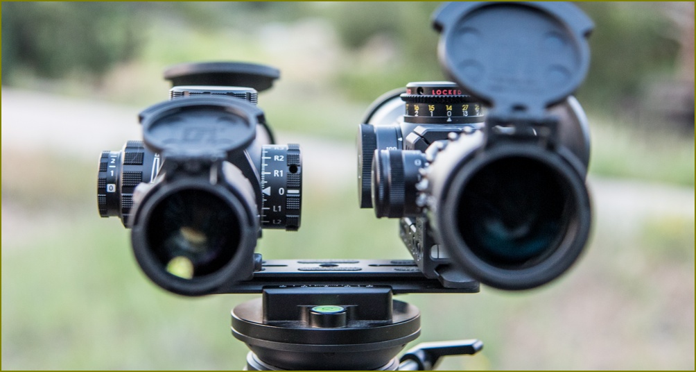

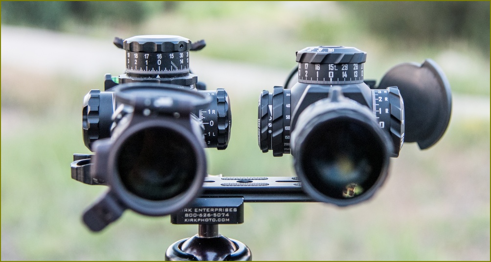

    @jwknutson17 and I had the chance to get out last week and do a quick review of these scopes in fading light. I have good news and I have bad news.
    First the good news, all these scopes delivered like alpha scopes in low light.
    The bad news, it has been a very wet summer in Colorado and as such the mosquitoes are on the rampage and we were fresh meat for their voracious appetite. As such, we were unable to conduct the full breadth of the evaluation which I usually like to do with a high and low contrast chart at 12x on each scope as the light fades from sunset to 30 minutes beyond.
    We had the Minox ZP5 3-15x50 and the Schmidt Ultra Short 3-20x50
    And of course we also had the Kahles K318i 3.5-18x50 and the ZCO ZC420 4-20x50

    Your Kahles set at 3.5x is magnifying more than the ZCO at 4x
    Read my notes, this is due to the resizing of the images to get the sight picture to look the same for a comparison of FOV, this also makes the SKMR3 reticle look just as thick or close to the MPCT2; however, this was not the case, the SKMR3 is quite a bit thinner when looking through the scopes.

    So the Kahles has a smaller image circle at 3.5x? Is it tunneling or is it smaller throughout the magnification range?
    None of these scopes tunnel, at least not to the point that I can detect. The Kahles just has a smaller sight picture, the ZCO is massive, it felt bigger than all the others; however, I wasn't paying as close attention to this, but maybe I should next time out. Let me see if I can do some crops that are more 1:1
