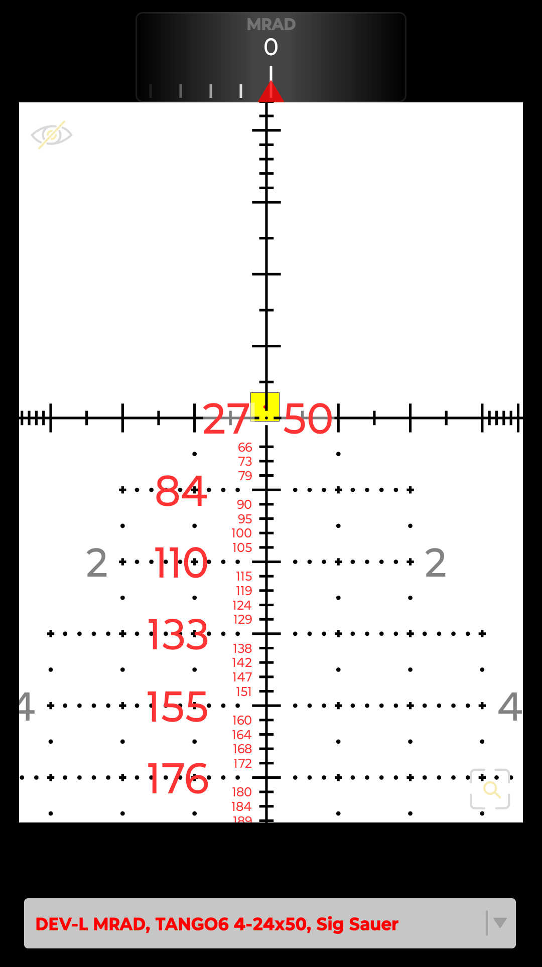

You hit the top of that box instead of the bottom and you just missed on a 1 MOA target.
If someone wants the ability to make dialing corrections over these short distances, a 35 yd zero takes care of the need to dial below your zero.

Or did he not realize that the furthest he'll ever need to hold under is about half the bullet width at 35 yards?
