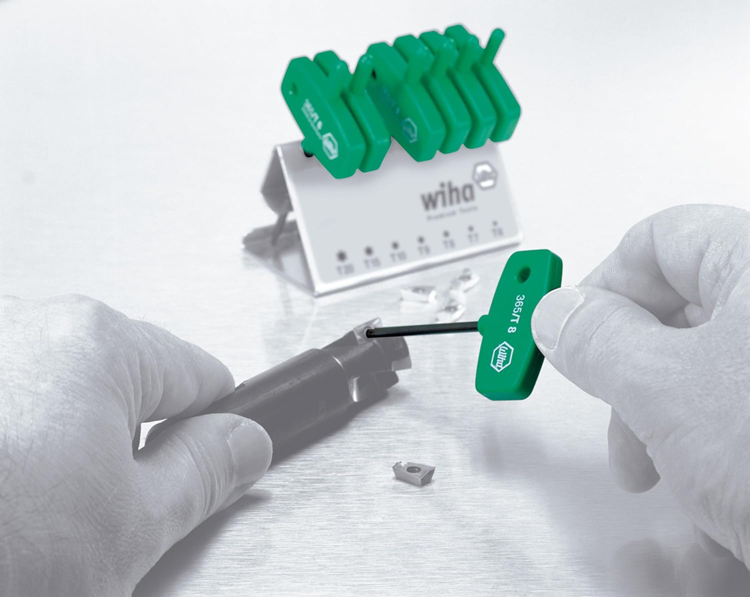

I did not care for the torx wrench that Zeiss provides. My big clumsy hands tend to drop small wrenches at the worst possible time and in the worst possible place. I keep a set of these Wiha winged torx wrenches in my range bag. Size T6 thru T20. The S3 uses a T8.
I've read a couple posts where the turret on the S3 has slipped. I believe that all have been attributed to not tightening the set screws enough. Nobody wants to damage a scope...
Given that the set screw is steel and the internal materials are brass, you should be able to see where the screws have made contact with the elevation mech. There may even been some burnishing on the brass surface where the set screw has slipped.
I did not care for the torx wrench that Zeiss provides. My big clumsy hands tend to drop small wrenches at the worst possible time and in the worst possible place. I keep a set of these Wiha winged torx wrenches in my range bag. Size T6 thru T20. The S3 uses a T6.
That makes sense. I’m pretty sure the turret screw and zero stop screws (which are what engage the internal turret) are T8.
I’ve been using a Kobalt t8 screw driver and tightening until I could feel the screws on both the zero stop, and then the turret, stop turning. I guess the 8.8 in/lbs torque spec had me scared of over torquing things:

You are correct. The S3 uses a T8 wrench.
