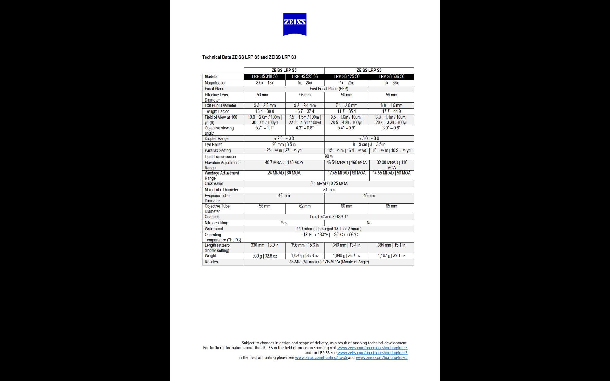

Check out the attached. I went with the S5, I liked it better. I can't speak on the S3 but I look at little differences between products that probably don't matter but it's how I decide things. Supposedly- The S5 is manufactured in the same facility that used to make the Hensoldt scopes (I own a Henny 4-16 and love it) and I wanted true German glass and manufaturing. But look at the numbers for; exit pupil, field of view, etc. I have both the 5-25 and the 3-18 S5. No regrets.
  • technical_data_zeiss_lrp_s5_and_lrp_s3.pdf
Same info screen shot
