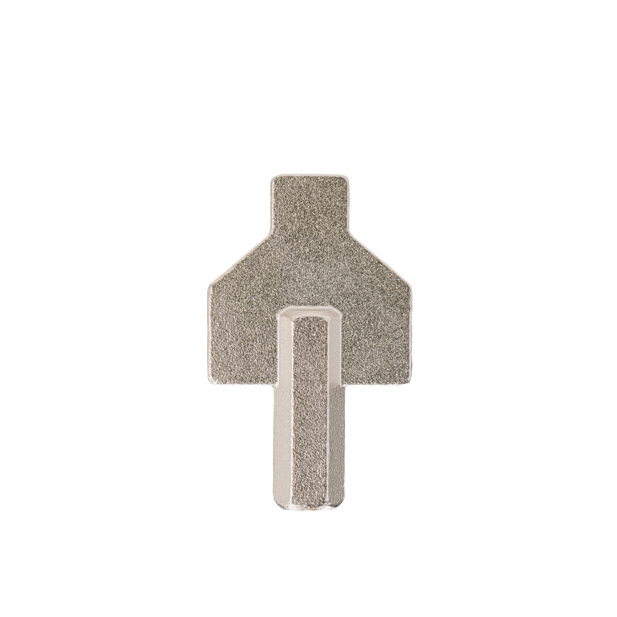

I just use the torx wrench that I loosened the dial with to turn the knob if I need to go down. Fits in the slot just enough to turn it. You can use whatever though. Glad to help.

If you have a set of Fix-It-Sticks, this choke tube tool fits really nicely in the S3 turret with the zero-stop removed... At least, the one I have does.
You cold also use a quarter if you had one in your pocket. Or, like Rob said, lay the little turret hex wrench in there sideways between the slots and spin it that way.

I had the hex tool they give you but thought it may have been a little thick so didn’t try it. Didn’t want to mess up the actual mechanism. May look into that choke tube so I can keep something plastic with me in case I need It.
