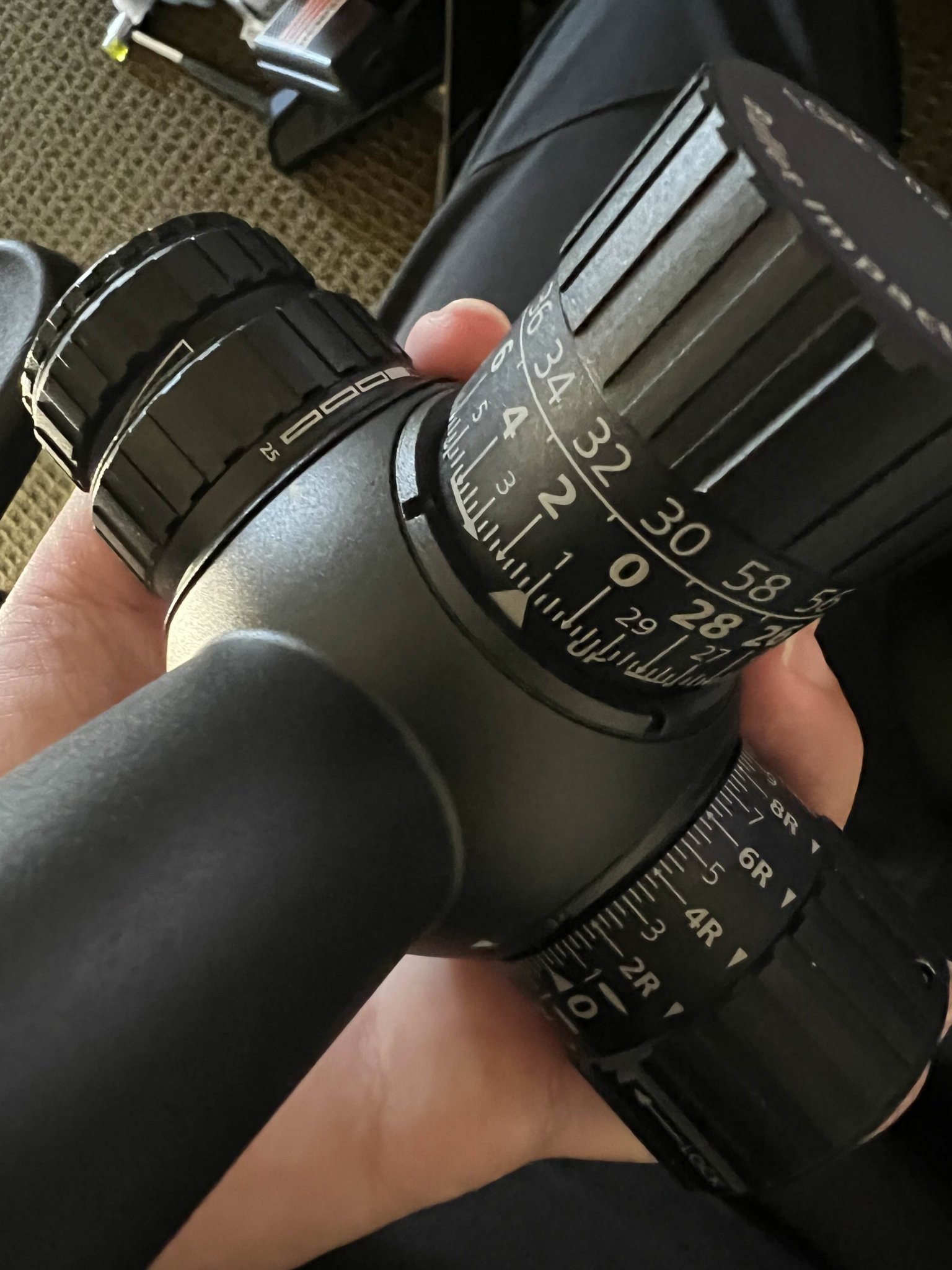

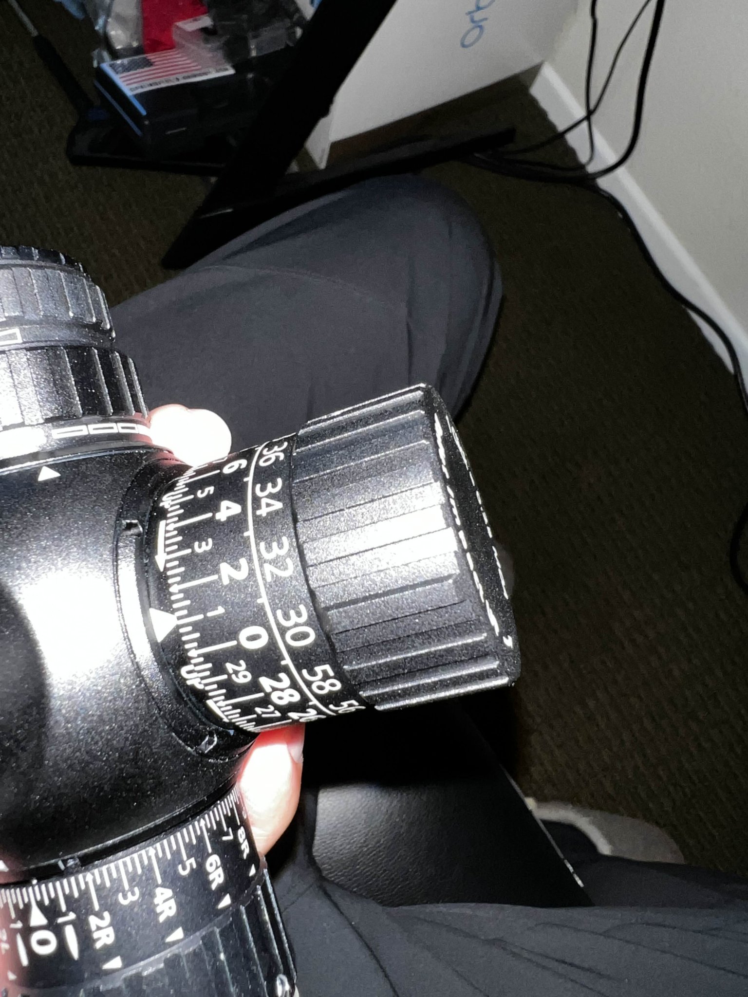

Hello everyone! I just joined this community. I recently purchased a Zeiss S5 and was planning to replace my old S3 with it. However, today I noticed an issue: the calibration lines on the S5 turret are not aligned properly. After consulting some information, it seems like this might not be normal. Attached are some photos I took for your reference. Could you please help me check if I need to exchange it or send it for repair? Thank you!

You just spent $4,000 on a scope and are unaware that the elevation turret free-floats and is indexed using several set screws that can be loosened and then tightened back up once you line up the numbers and lines?
Is this a serious thread?

Have you actually zeroed the scope yet? The turret may have slipped a little, causing the marks to not line up.
