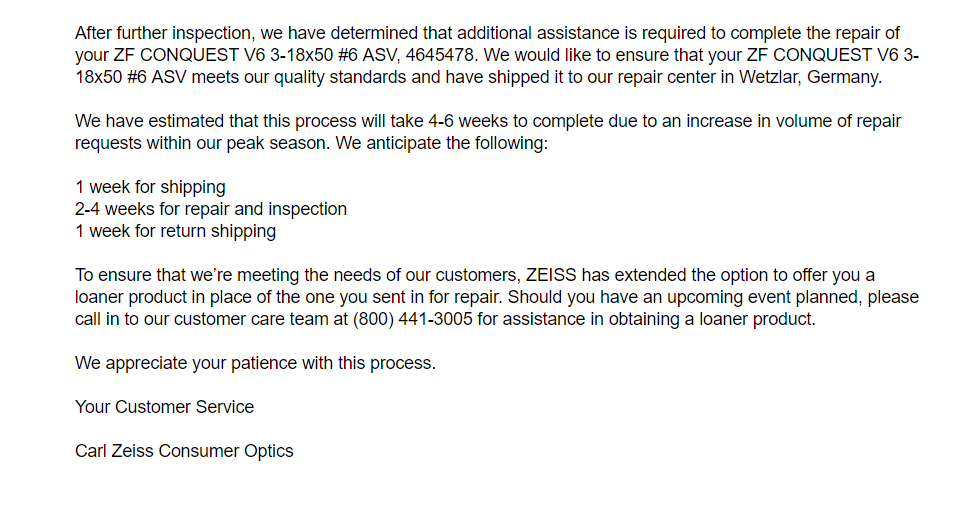

We have a V6 3-18 that i've not tested but something went wrong with it at some point. I zero'd it on dad's SAUM ran it out to 600yds for DOPE and let him have it. Went back to school and he kept missing deer. I figured he just didn't carry the range finder with him. Well he did and he was missing. I put it back on paper and it was 10" high. I've rezero'd since and we've taken 3 deer with it. One at 425yds, one at 270yds, and one at 190yds. Seems to be working now. I'll have to put it back on paper or do an official tracking test to really figure out if it was off. That or maybe the zero stop somehow slipped and i didn't realize.
I have one, and have had zero issues with it. While I haven't run a box test, I've verified it's clicks to 1380 and it was hitting where it was supposed to with my SAUM. Personally, I love it (the 3-18) model for a long range hunting rifle. I normally shoot about that power anyway, even on a 25x, so love having my reticle true on a power I actually shoot on. I'm VERY pleased with the turrets as well. Hunted hard this season with it, and took some falls on the scope. Held up very well. I personally think the turrets feel just as good as my ATACR. For a hunting scope, it's hard to get over 100MOA of elevation and turrets that good at 22oz. I'm definitely a fan!
I think the European versions are.
Ours is for sure not tracking. Took dads saum out to shoot some groups. 4” low and 5-6” right. This will be the third time I’ve zerod this gun.
Not indicative of the entire line obviously but this one is heading to Zeiss.
They haven't given me an explanation but it's on it's way to germany, there was a problem.

Got the call back from Zeiss they said nothing was wrong with the scope. Which boggles my mind because they said it warranted being sent to the repair facility in Germany. Started to think maybe it was parallax but that’s just improbable with how well the fun is shooting. I’ve got two optics to try out on it though. Mainly my USO which i know tracks. So well get to the bottom of it
