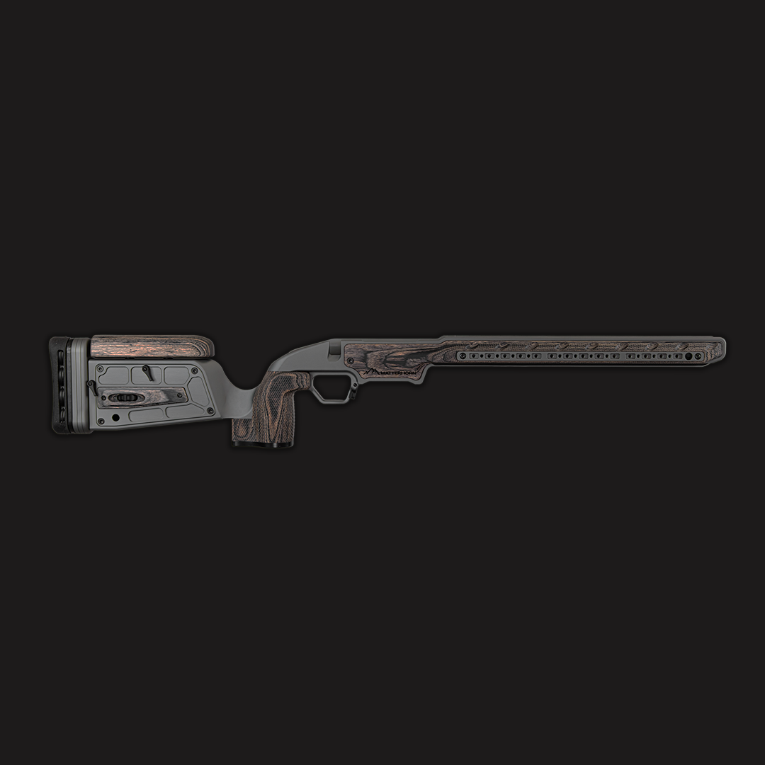

Zermatt Arms is pleased to announce the newest addition to our product line, the Matterhorn rifle chassis!
The MatterhornTM is Zermatt Arms’ vision of a modern-day rifle chassis mixed with elements of a traditional rifle stock. It features an all-aluminum frame dampened with a high-density phenolic material that absorbs unwanted vibration while providing the timeless look and elegance that only high-quality hardwoods can provide. The MatterhornTM also offers a tremendous amount of adjustability to suit the needs of a wide variety of shooters using products with the Remington 700 footprint.
The MatterhornTM will be available for purchase HERE Wednesday, May 22nd for $2150 in a short action, Remington 700 inlet. It will be offered for both right- and left-handed shooters and carries the following features:

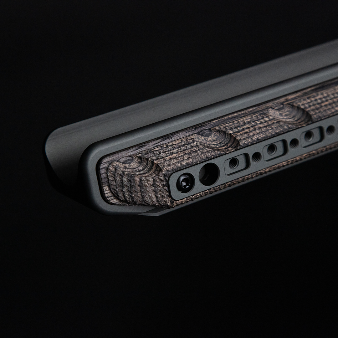

  • Full length Arca fore end
  • M-LOK accessory rails

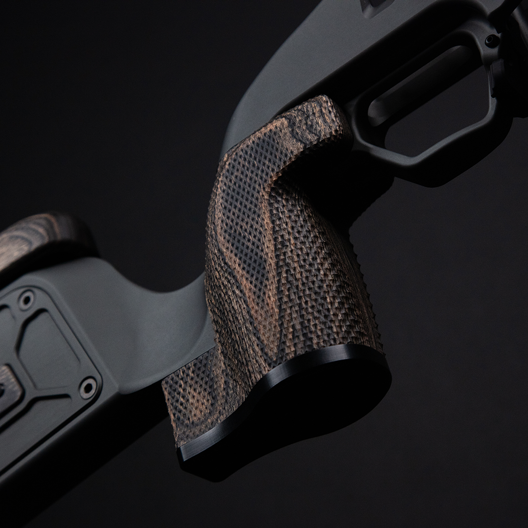

  • Vertical and swept grip options
  • (4) sizes of grip base plates (swept grips only, vertical grip uses flush base plate)

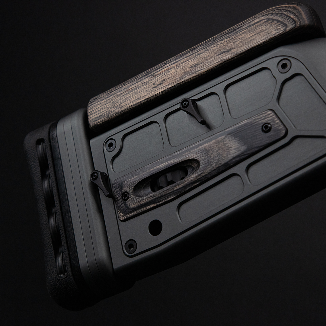

  • Adjustable length of pull
  • Height adjustable cheek comb
  • Laterally adjustable cheek comb
  • 100% captive action screws

Full specifications are listed below:
  • Base chassis: 6061 Aluminum
  • Anodized chassis base (grey and black options)
  • Wooden composite fore end dampening panels, cheek piece, grips and accents (options for colors available)
  • Base weight: 6.75 lbs
  • Fully kitted (maximum possible) weight: 12.25 lbs
  • Additional weight options:
  • Fore end: up to 22 ounces in 2.8 ounce increments (fasteners included)
  • Butt stock: 28 ounces (fasteners included)
  • External: 3 options available
  • Standard: 4.05 ounces each (fasteners included), up to 8 per chassis. Best paired with two small external weights OR one flush cup external weight and one small exterior weight OR two flush cup external weights.
  • Small: 2.66 ounces each (fasteners included), up to 14 per chassis
  • Flush cup: 2.75 ounces each (fasteners included), 1 or 2 pcs per chassis, same size as “small” external weight
  • External combination weight:
  • 8 standard and 2 small: 37.7 ounces (2.4 pounds)
  • 8 standard and 2 flush cup: 37.9 ounces (2.4 pounds)
  • 8 standard, 1 small and 1 flush cup: 37.8 ounces (2.4 pounds)
  • 14 small: 37.2 ounces (2.3 pounds)
  • Fore end width (without weights): 2.345”
  • Overall length (as sold with two LOP spacers): 34.750”
  • Minimum LOP: 13.25” – 13.375” (dependent on trigger shoe)
  • Length of pull spacers available in ¼” increments
  • Fore end length (from end of chassis to back of recoil lug): 14.125”
  • Maximum barrel diameter: 1.250”
  • Fore end depth from centerline: 1.500”

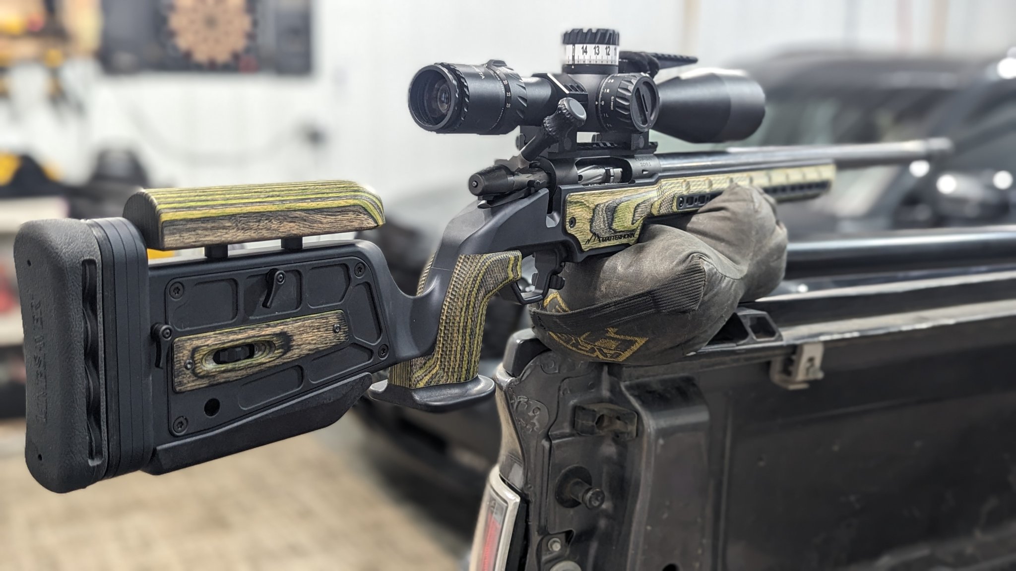

My experience so far...The fit and finish of the Matterhorn is nothing shy of amazing. The look of this chassis will always have varying opinions, but understand the panels help eliminate the metallic twang or vibration you get with other chassis systems. It also has the most "dead" recoil pulse I've experienced. Once you pick one up and get to spend any amount of time with it, you will understand the price tag... Nothing on the market compares to what this offers.
Did an initial impressions video. It’s actually pretty nice. To be expected with the price tag but at least they didn’t over charge and under deliver.
I do look forward to shooting this at a match next weekend.
