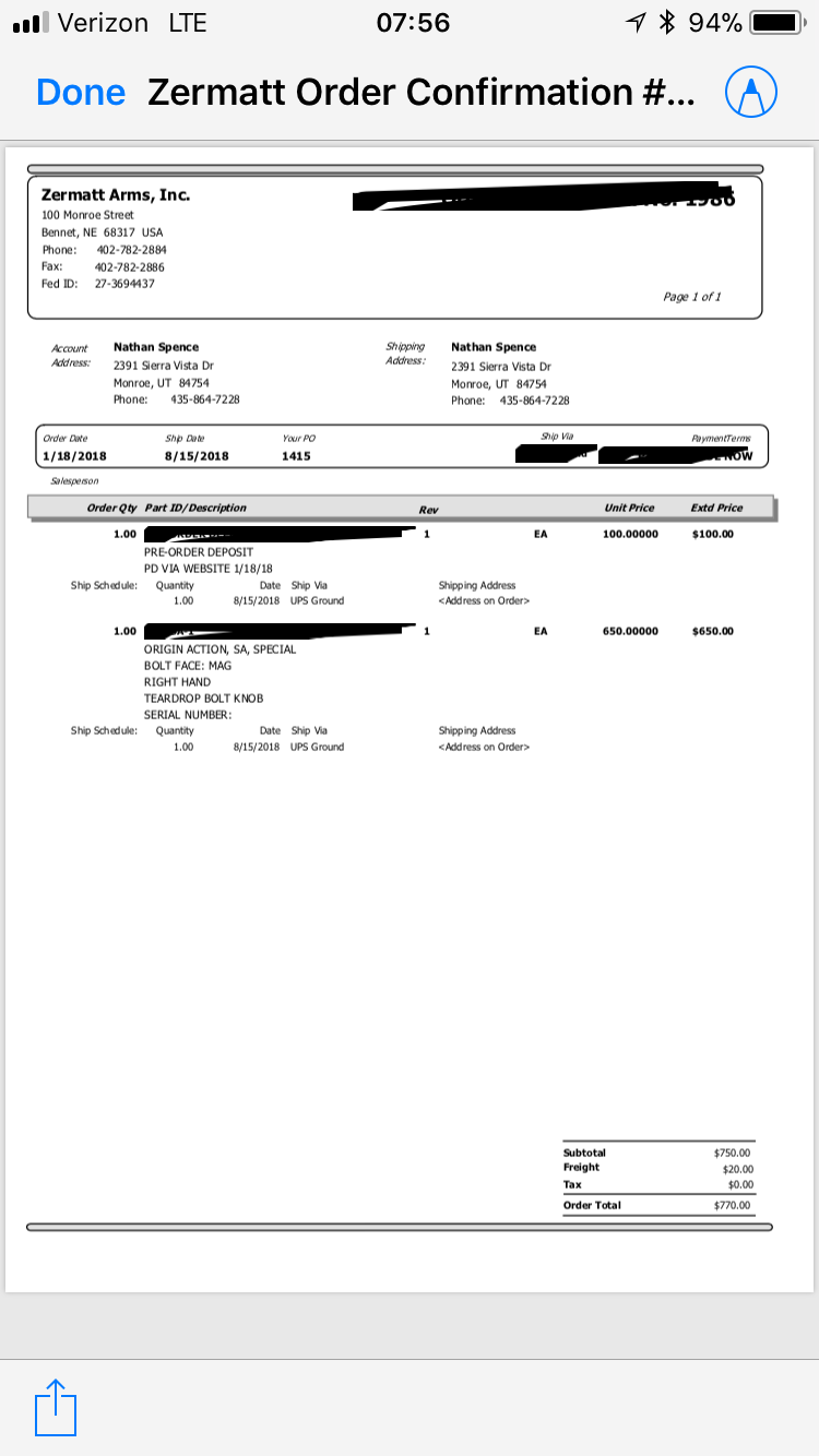

20moa only on the origin. When I called them they said the remaining 650 will be charged just before shipment. He also said guaranteed shipment by August 15th. But that he is trying to under promise and over deliver and it COULD be sooner

My ship date is aug 15th, but we can always hope for sooner
