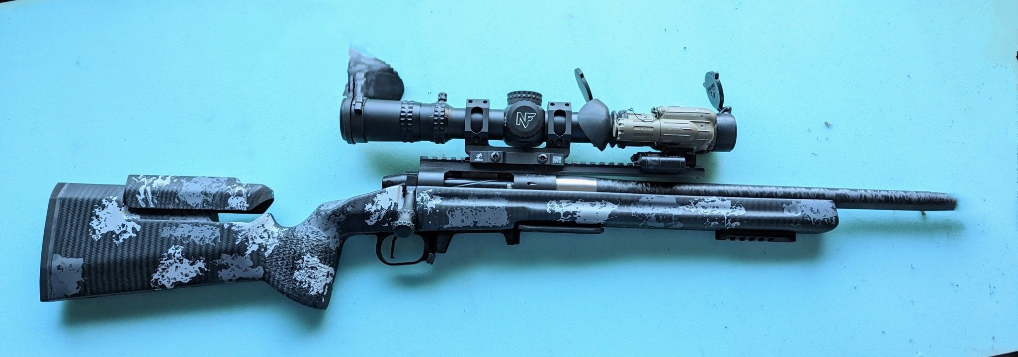

Just got mine all put together!
Are the extended rails available from @Zermatt Arms or was this a one time thing?
So far, they are one time thing. I needed a few rails for myself and to make it worth while, I ordered more. I'm digging the clipon thermal life right now and as they become more popular this is the easiest way to have both They are getting coated now
I enjoy mine, only have 250 rounds through it. But no issues running 140s up 2840 from a 20" barrel with rl26, no bolt lift. Cycles very smoothly, times up better to a TT, but have a bixnandy trigger installed for a lil more pin fall.
