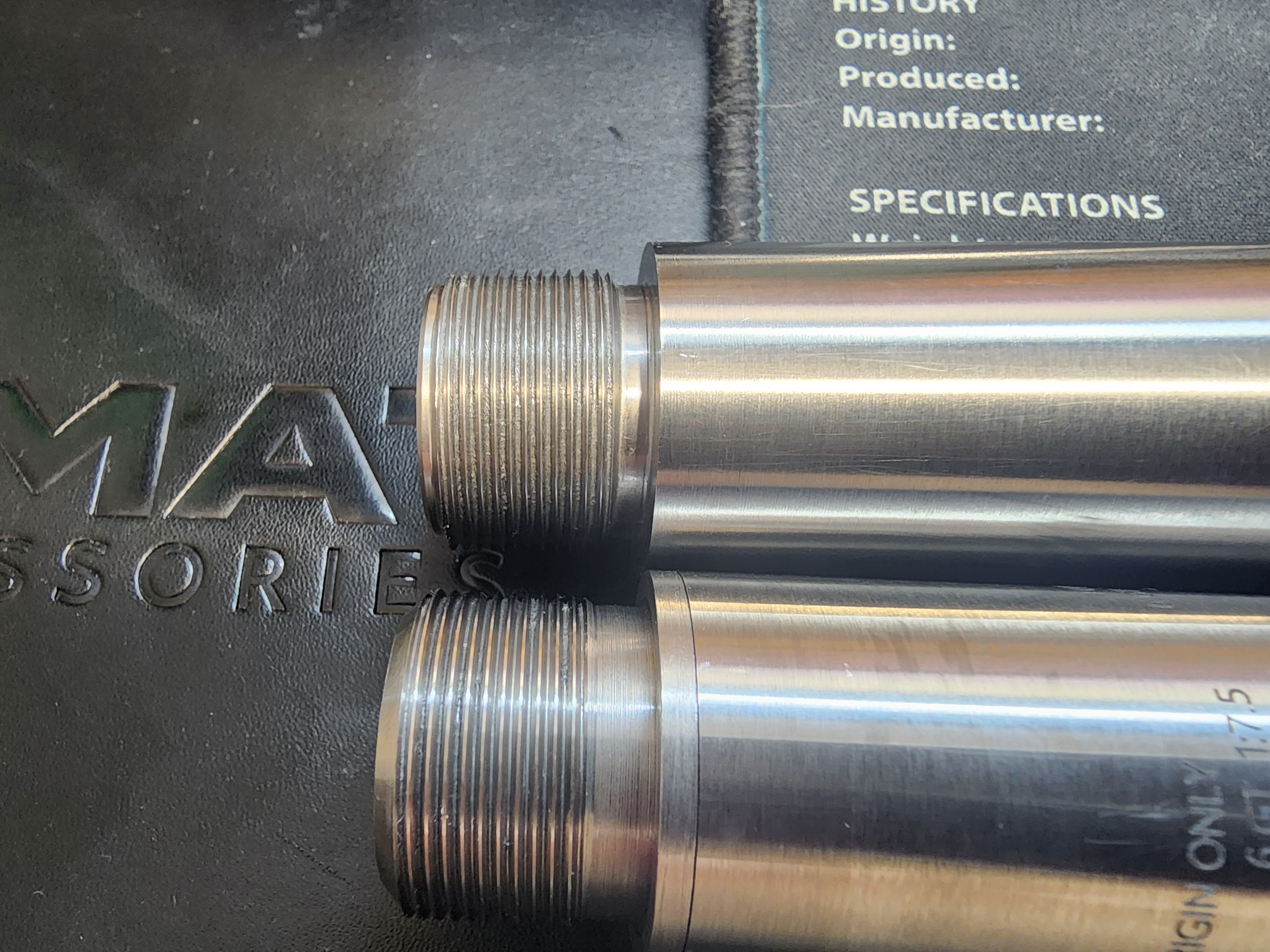

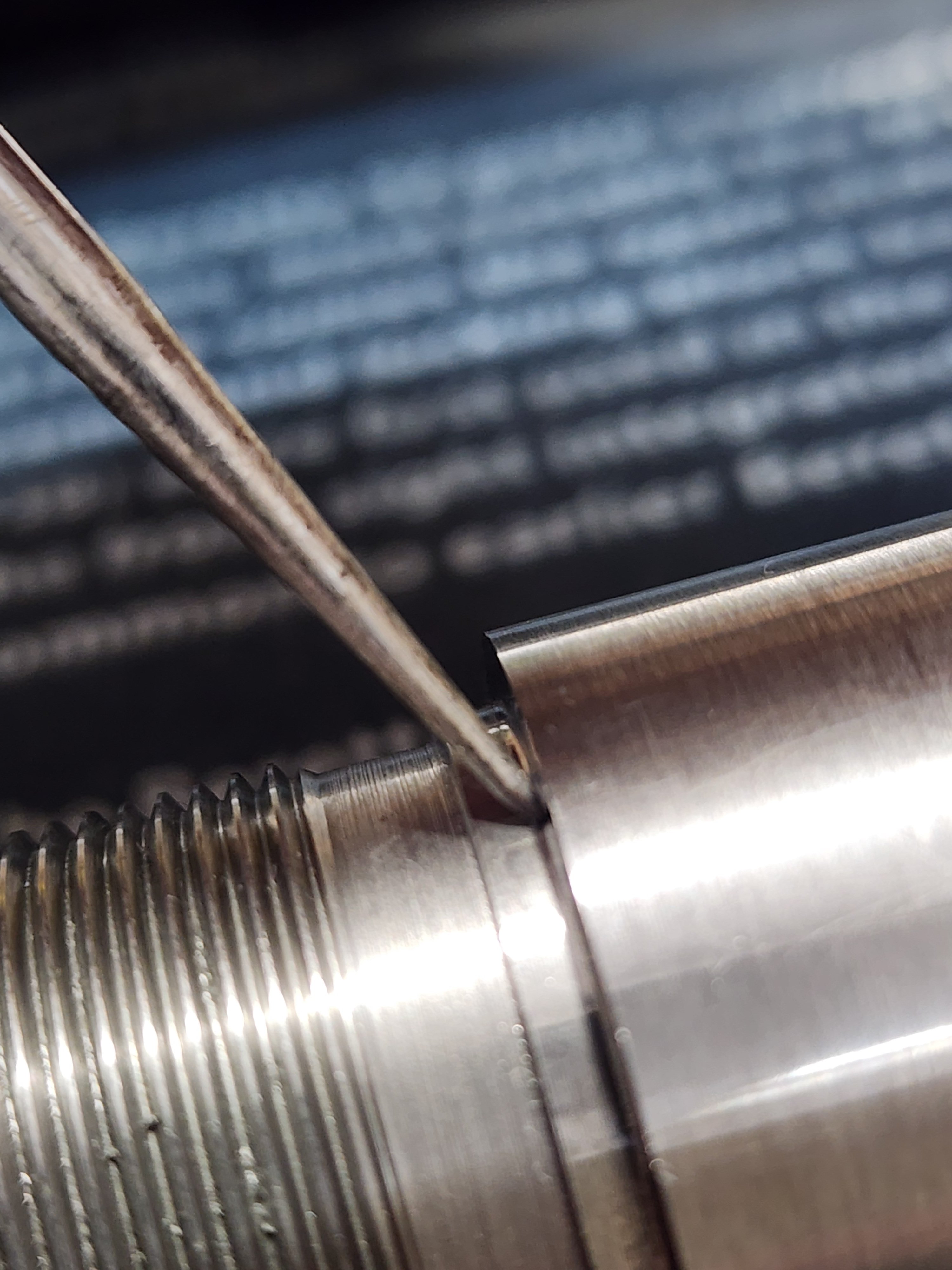

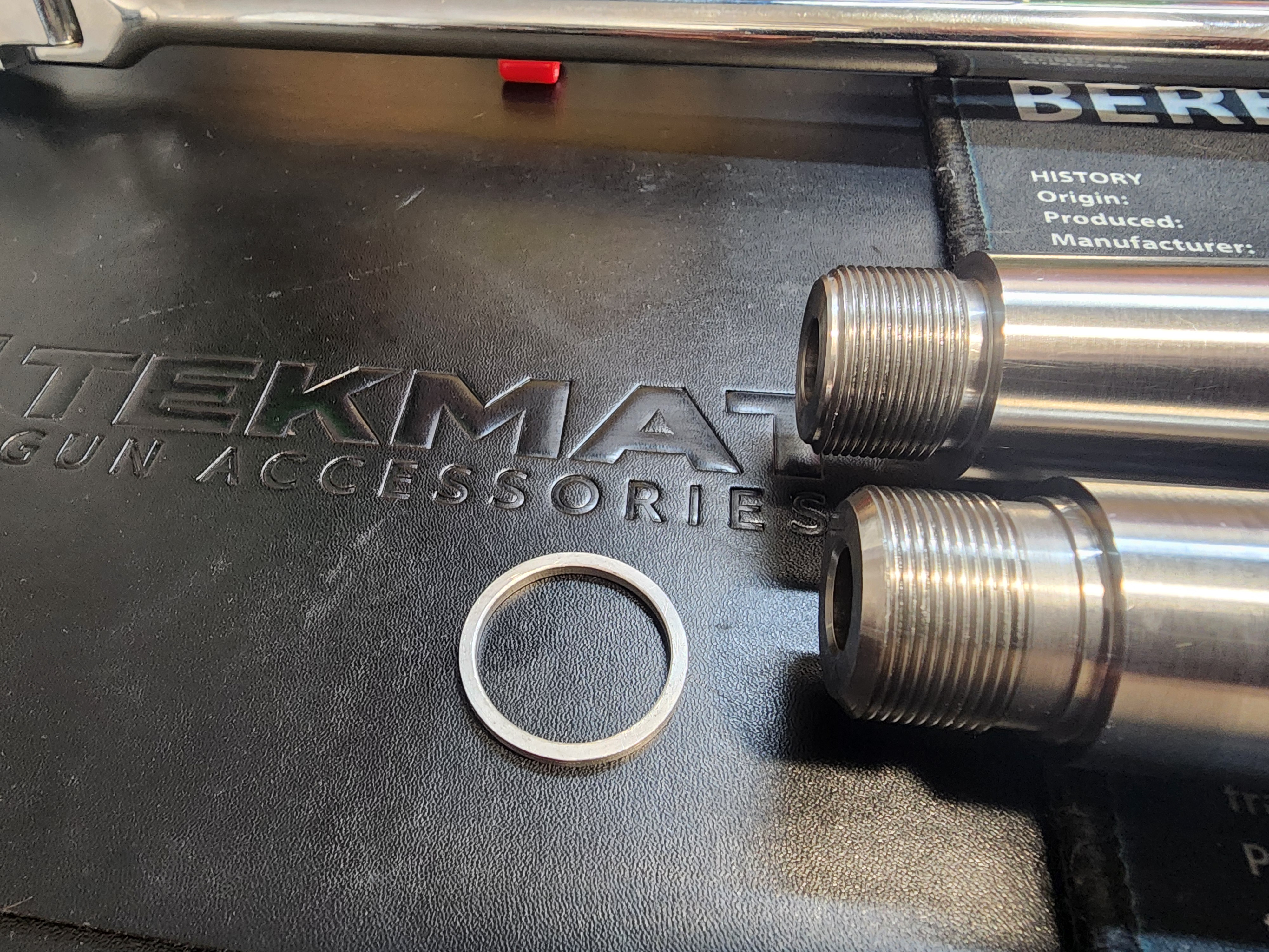

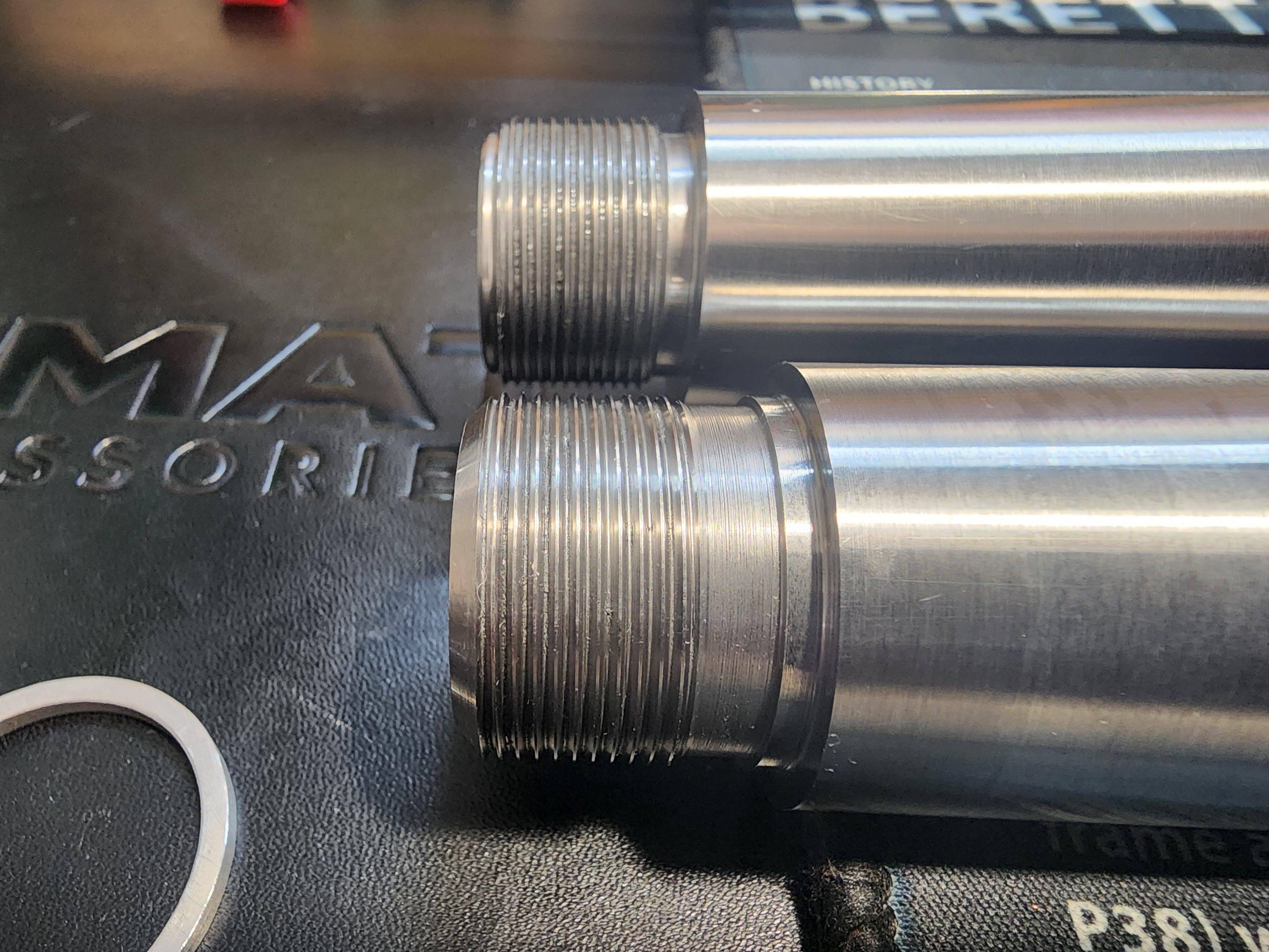

I dont have access to a surface grinder right now. So I made 2 on the lathe at work and then had a local shop grind them. I gave them a tolerance of +-.00025 and they are all over that. I made them out of 416 stainless and they blend into the barrel perfect.
For anyone that is wanting to do this, here are some pictures of the spacer and the relief cut i had to make on my proof barrel. It looks like proof leaves a register on the origin barrel for the recoil lug on the origin. If your origin barrel is like that u have to cut that register shorter then the .100 for the spacer and smaller then the minor diameter of the thread. Its pretty simple and will still work just fine if you want to put the barrel back on the origin. Also if u make a spacer make sure u make a small relief or radius on the barrel shoulder side, if u dont there will be a gap.
