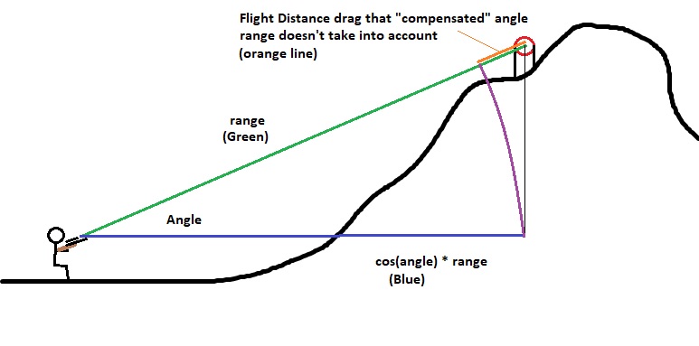

2) Shooting up hill/down hill using the compensated range your LRF gives you is wrong because of this picture below. Yes, the cosine angle compensation will account correctly for the gravity over the shot, but it will NOT account for the extra drag marked by the orange line, nor the extra time of flight.

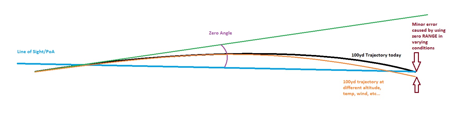

You can still use zero range (100yd zero, for example) with 4 DoF just the same as any other ballistic solver. However, with 4DoF you also have the extra option to use zero angle if you want to.
Note that the zero angle is the same in both sets of conditions, but the zero range is slightly different.
ETA: Green line is the bore axis
