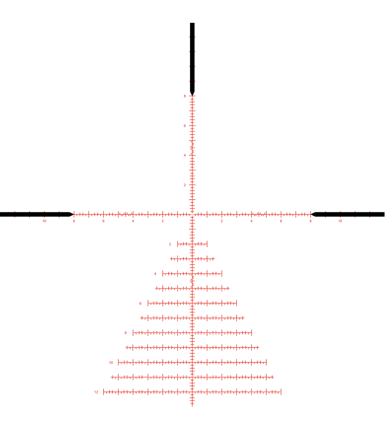

    Here’s a few pics of different tree reticles so you can see how the mpct2 is less obtrusive.
    Bottom line, I’ll be using mpct2 exclusively in the future.
    (Note, other reticles such as ebr2c and mr4 have dots in tree which are also not obtrusive, but mpct2 seems to be the least obtrusive in the “high end” market).

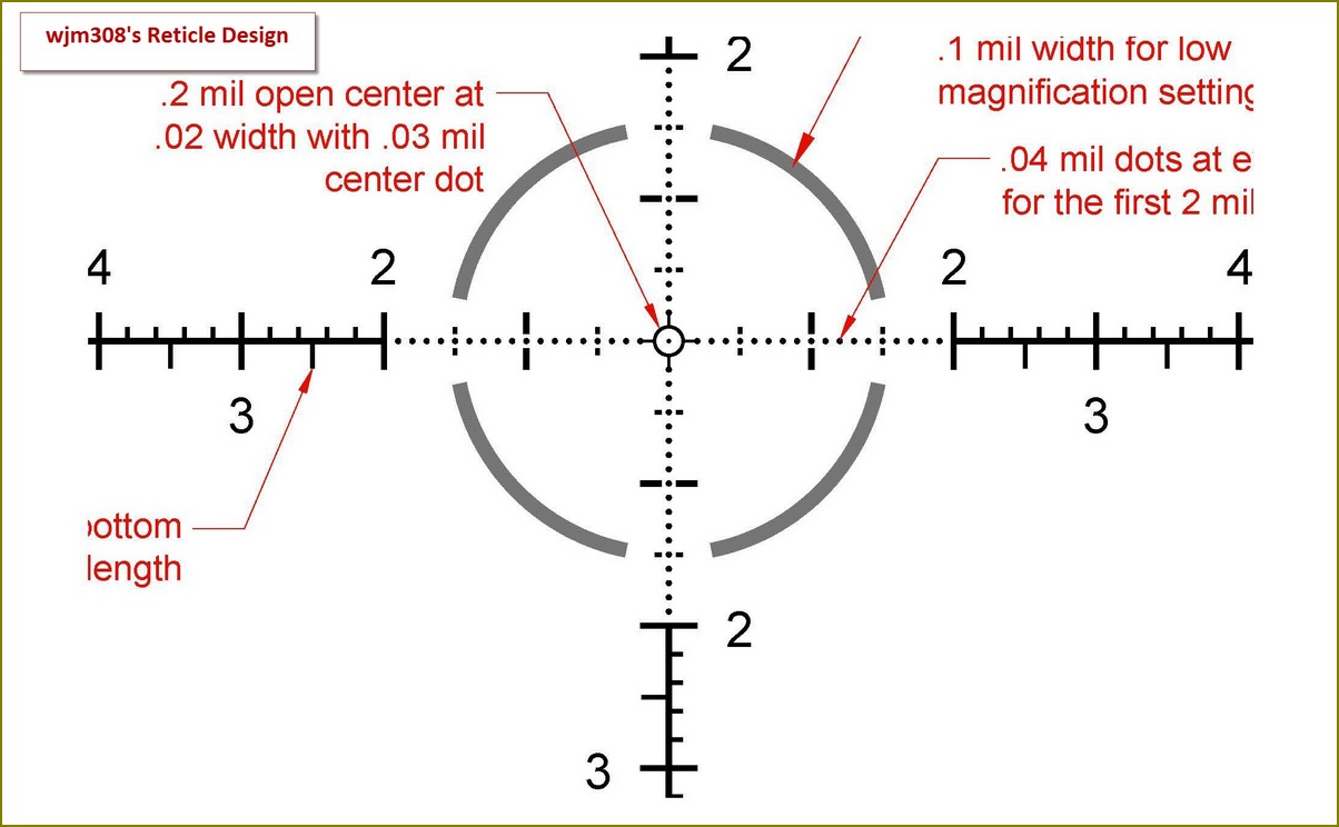

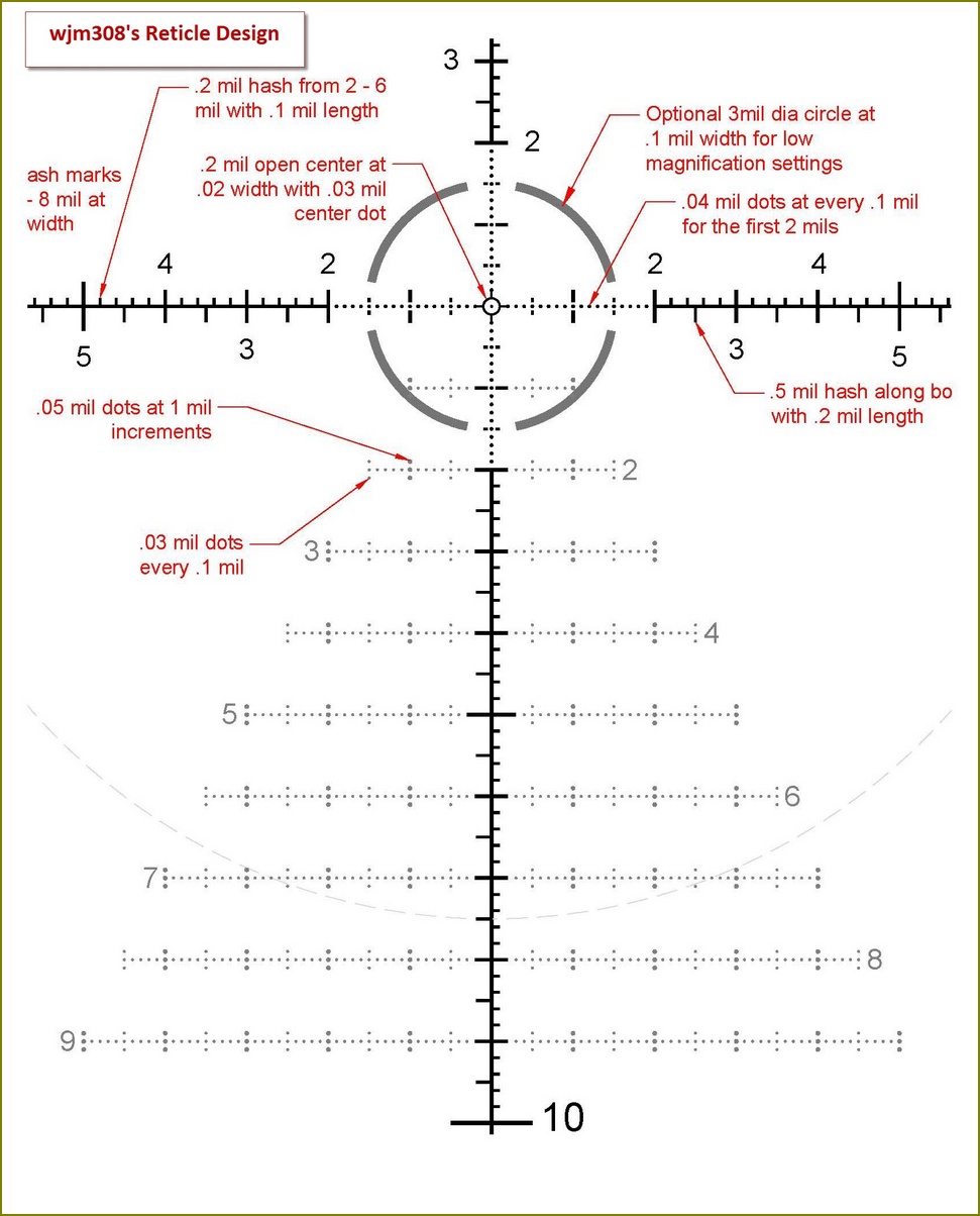

    After basically designing the perfect reticle for me (basically a skmr3 with .2 throughout), I noticed the perceived FOV with the mpct2 tree is larger.
    I have no math to back it up, but the way they designed the tree seems less cluttered to my eye.
    Here is a pic of a reticle I designed. My idea was to keep all the hashes consistent throughout the reticle.
    After having the mpct2, I can see how for whatever reason, it seems like I can see much more with the mpct2 design than my own.
    Reactions: gebhardt02
    The only thing I would have personally like to have seen with the mpct2 is the first mil on main windage to be the same as the rest of the windage. I don’t need the .5 and like the way the rest is set up past 1 mil.
    I’m sure customer feedback (and I’m betting some issue with it being too close to skmr design) had something to do with that.
    I did not catch that before when looking at the MPCT2 - that it starts at 2 mil instead of 1 mil like most every other tree out there, I can see how that would be a benefit for sure. I still like the dots of the MR4 better for the tree area instead of the solid lines the MPCT2 has, but experience trumps theory in how a reticle will actually look/work in real world situations. Thank you for sharing.
    DT, that is cool that you designed your own reticle that ended up being very similar to the MPCT2, as Bjay mentions so many center dots can get lost, would love to see another small circle around the center dot especially for quick shot situations, our eyes natural zoom in on concentric circles and this reticle I put together a few years ago - would love to see the small circle to help identify center when that dot gets lost. Based on your thoughts on the MPCT2 I think I would eliminate the 1 mil tree horizontal similarly.
    I like this a lot. Have you sent this out or shopped it around to manufactures?
    Thanks. I've tried a few, even spoke with ZCO early on, but most have their own ideas and competent reticle designers. I don't have the weight within the industry as someone like @koshkin does, I think ILya did get someone to use a reticle he designed and right now I can't remember who. I've spoken with Athlon and Tract and both showed initial interest but faded away, maybe I should talk with Horus, I know they tend to lean toward the "busier is better" approach, but with their connections to the military something more simplified might be nice, not sure if Finn Accuracy would have any interest either. I'm making a few more mods based on your comments and Bjay's and will post in a short while.
