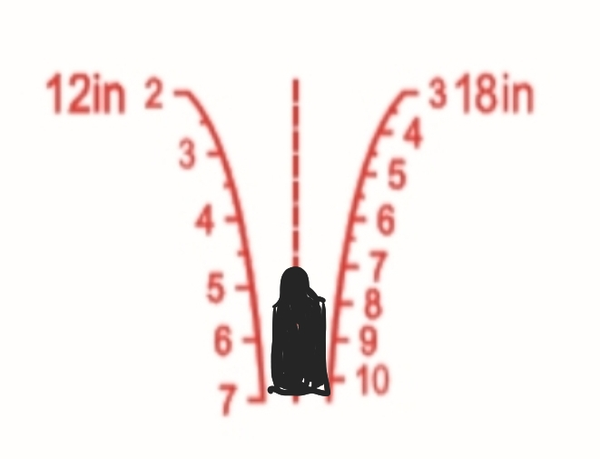

    Is there a good break down explanation like this (or video) of the "Fatal Funnel" thing? Thanks.
    Original explanation where I got my understanding from
    If the target is 12" wide this would equal 700 yards.
    If the target is 18" wide it would equal 1,000 yards.
    If you use the dashed line down the middle instead of the full width between the two outside scales then the scales becomes for 6" and 9" targets instead of 12 & 18 (because youre only using half of it)
    So this is a 12" wide target, its 400 yards away.
    This is an 18" wide target, its 500 yards away.
    This is a 6" wide target, its 600 yards away.
    This is a 9" wide target, its 800 yards away.
    So this is a 12" target, its 400 yards away.
    This is an 18" target, its 500 yards away.
    This is a 6" target, its 600 yards away.
    Well done sir, super simple explanation. I remember when the MPCT3 came out I had a mental block on this but this hasty explanation above is on point.
    The number one thing I've had to remember is to ensure the moment the lines are "touched" by the target, that is the rough distance. Keeping the rifle steady enough to measure that has been a training goal for me.
    Wow, that's really useful....and easy

    after seeing spife’s drawing of how the fatal funnel works, it definitely makes a lot more sense. Plus I like the gridded bottom half better than on the mpct2. Not to say the 2 is bad by any stretch, but the 3 seems better to my eyes.
