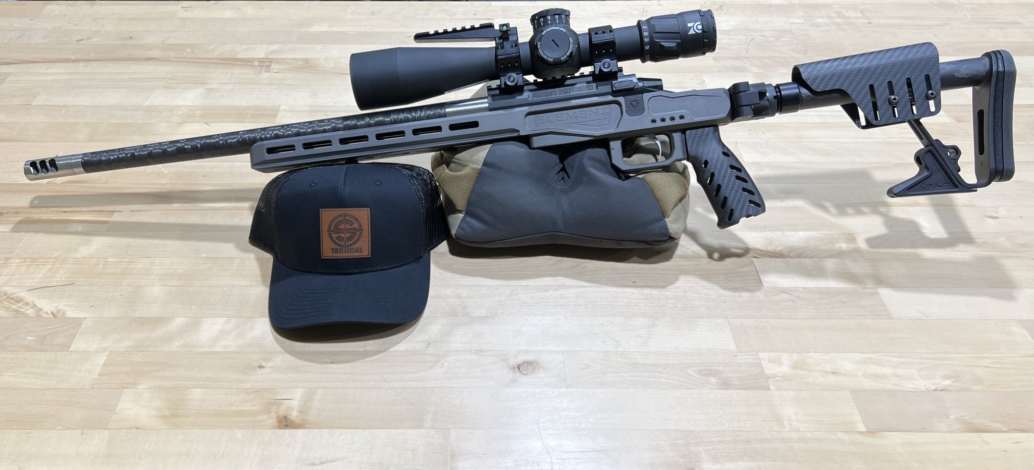

The above answers just solidifies most of our conversation :) Having this debate myself very recently for my in progress NRL Hunter(ish) 6.5CM build I went with the ZC527 M3X. Could I have waited another month and grabbed the ZC840 if I thought it was going to be a better fit? Absolutely! Will I snag a ZC840 on a future magnum ELR (2,000 yard plus) build? I will compare it to my ZC527 side by side and decide from there.
My work in progress and weighs 10 pounds 3 ounces with no magazine bipod. (The first pic is closer to the actual color)

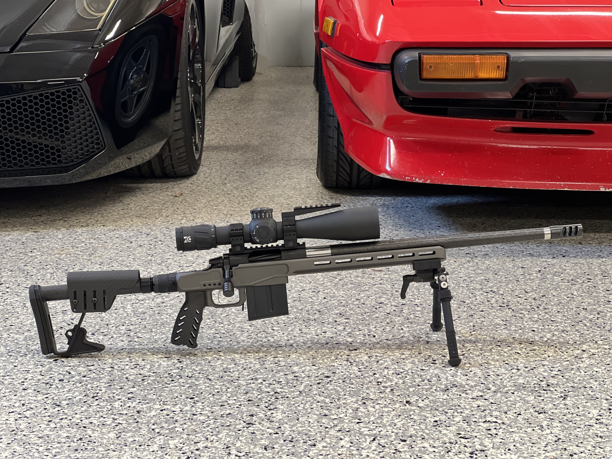

I went with the 527 3x NLE for my on order AT-X. The extra mag of the 840 didn't have a practical use for my application and 5-27 is a good fit for a short action where most shooting is done from 12x - 20x. I can't comment on OP's personal eyesight considerations. I've been happy with the ZCO so far (riding on other rifles) and don't regret not considering the 840 for this application.
Ordered from CS Tactical of course as well :cool:
