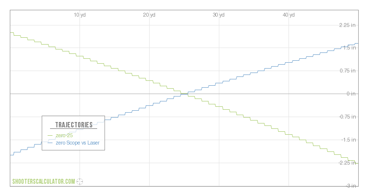

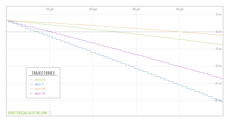

I would play with a ballistic calculator.
You can enter negative sight height for your under the barrel laser and see what the trajectory looks like.
Remember that your bullet ALWAYS DROPS, right out of the muzzle.
For close ranges, there isn't going to be much difference from one AR round to another.
For example,
Try -2 inches, 62 grains, 2500 to 2900fps, and either a 25yd or 40yard zero for the laser.
Then use those values and see what a 7 or 10 yd zero does out to 50 yds. :) :) :)
Scope on top (+2"), laser on bottom (-2") 25yd zero on both.

Then use those values and see what a 7 or 10 yd zero does out to 50 yds. :) :) :)View attachment 7219226
Scope on top (+2"), laser on bottom (-2") 25yd zero on both. View attachment 7219229

With the laser in the bottom and the scope on the top at 10 yards your POA will be 2” high for the optic and 1.5” low for the laser. That’s a lot to remember.

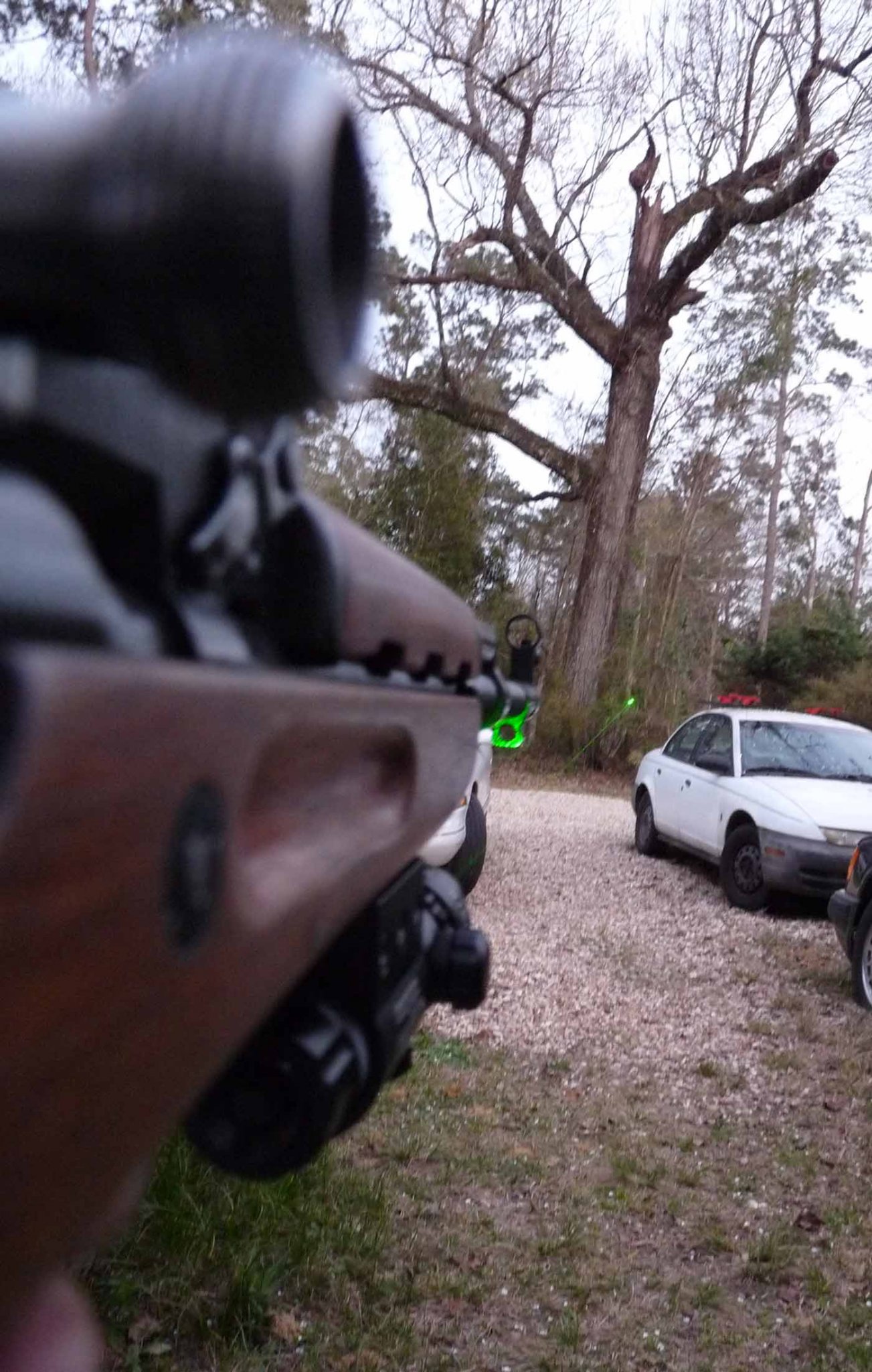

I have a green Laser on an SKS.
Daylight @ 25 yards and it works OK. I don't have to cheek down to use the open sights.
