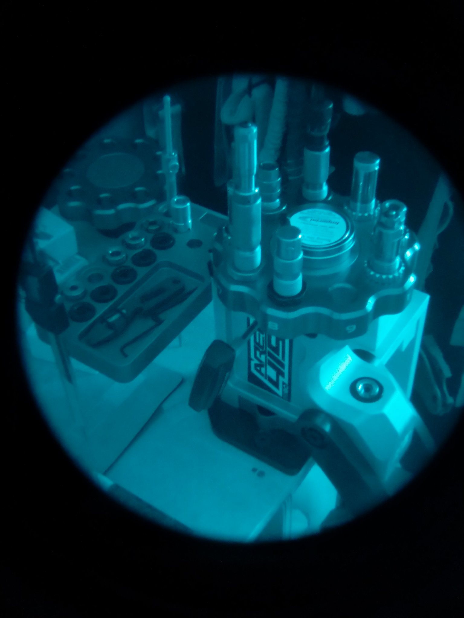

If you load multiple calibers it is 100% worth it. I load 6bra up to 375CT and there is never run out between rotating dies. And I can switch out turrets without having to move dies in like 30 seconds.
Plus it gives me peace of mind. I pull out the calipers every once in a while just to check and it is dead on. I would do that with my rock chucker and find run out occasionally.
I made some good ammo with my rock chucker, it just felt like it needed a little more attention with each process of reloading.
