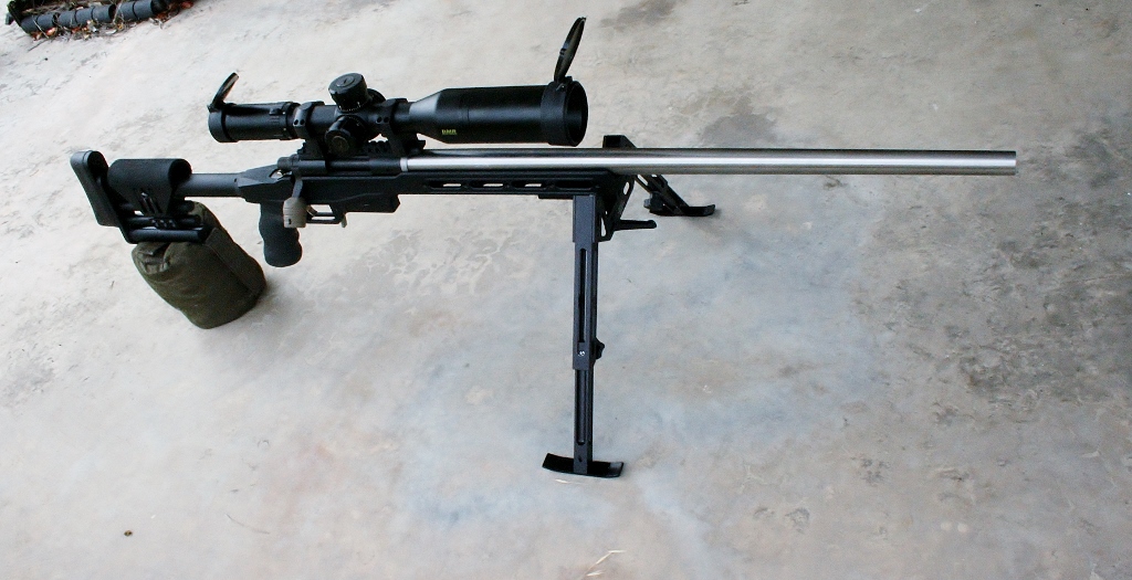

I am new at this getting my.308 rifle set up. My new LEUPOLD VX-6 7-42x56 should be in next month. Should I zero it at 25, 100, 200 yards? IMG_5071 (1024x525).jpg
