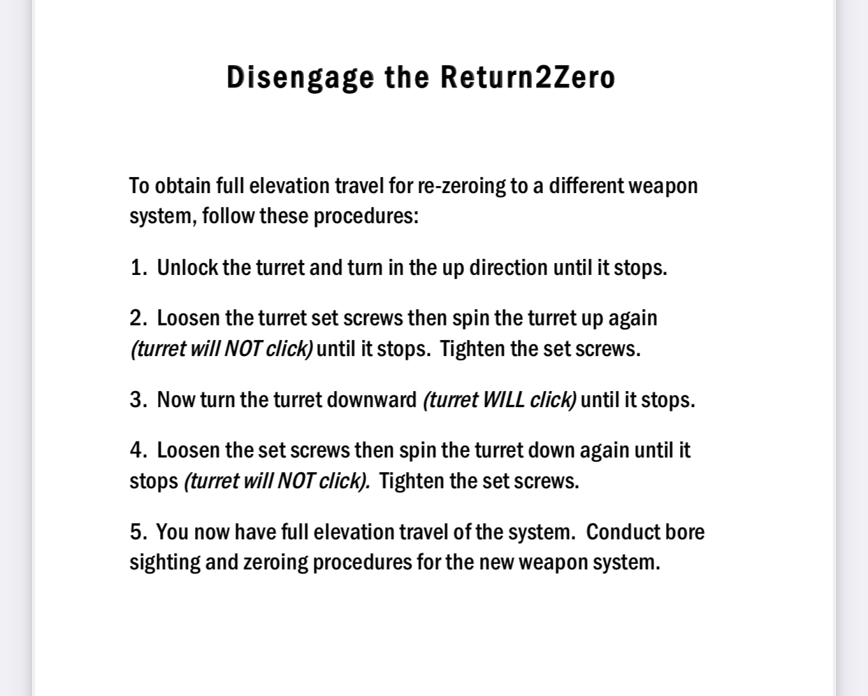

My new ZCO527 in MOA is mounted on my 375CT ELR rig which has a Picatinny rail of 55 MOA. The scope sits in a Sphur mount with 0 MOA.
Straight out of the box the elevation turret will go up from 0 (it is set at 0) to 117 MOA as per spec that being the max elevation on the scope. I shot the rifle at 100m with this setup expecting the point of impact to be sensibly higher than my point of aim but the shot was 10 moa below my point of aim .
Basically, this means that to zero my scope at 100 m I have to lose 10 moa on the turret and cancel out the 55MOA on the rail. How can I avoid losing all this elevation can I remove the turret and wind down the ZERO stop and reattach the turret as one does with NightForce and use the zero offset measurement as input in my ballistic calculator (my zero would then be at 800m for example)? I don't think this is possible as the scope elevation turret is already maxed out at 117MOA. Is this possible? is this scope unsuitable for ELR disciplines where one requires max elevation on the turret?
I was pretty sure I had no options available.... pity ZCO don't tell you this before you buy .
So to recap if I did not have the 55 plus moa picatinny on my gun I would need to dial 65 moa to zero at 100m ( BTW no ELR shooters ever zero at 100m )!!
I was planning on using it for ELR King of 2 Mile competitions but will have to revert to my ATACR which allows full use of elevation and will take me out to well over 2.5 miles with a NF wedge.
If I read that right one of us has bad understanding. It sounds to me like you need an additional 10 moa in the Mount to get you a 100 yard zero plus full elevation travel. Or a Spuhr 6002 which would put you 10 moa high @ 100 plus your total 117 moa.
Honestly I may be one not understanding. Please review.
Reactions: Huskydriver
I needed a 55 MOA rail +10MOA dialled on the scope to zero the rifle at 100M that leaves me with 107 MOA elevation on the scope still available this is inadequate for ELR above say 2 miles.
As the turret is not removable there is no way of adjusting my zero downwards leaving me with the full MOA 117 on the scope and an additional 55 moa provided by the rail. This is possible on my other scopes which are ATACRs. Obviously, my zero is now no longer at 100m but could be at say 800 m . This is the normal scope setup for ELR namely King of 2 Mile rifles and similar.
So when you dial the 10 moa up you’re subtracting from your 55 moa base. You need 20 moa more like the 6002 will give you. You’ve got more scope than you’re used to not less. That’s the way I see it.
I apologize if I’m still not understanding, I’ll let someone else chime in. Hopefully I will understand better.
Buy a 20 MOA mount and you have 117MOA again on the elevation turret, if you do zero set and adjust the zero stop to the scope.
There is NO scope on earth, that you can use all the elevation, if you do not have a rail that has X mount of cant and canted mount.
Very often rifle barrel is not timed to the action so, that bullet line is dead center to the scope line that is taken out of the box, but to the rifle and take a shot, also the ammo depend, speed etc.
Like let´s take a Tikka CTR, it has 0 MOA rail from factory.
I mount my ZCO scope to my rifle with ZCO Block mount that has 20 MOA.
Scope has 35MRAD elevation, that is peak to peak, and it is from the factory set in the half way, so up and down you can go then 17,5 MRAD.
Now that you think that you add 20 MOA mount to the scope, you will have 5.8 MRAD, and that is 23,3 MRAD, right??
But it wont go like that, you have the barrel line with the receiver, that depend how much you got the elevetion of the zero line, and canten mount/rail you can add it more.

Ok how do you reset the zero stop so I don't have to waste half or thereabouts of the scope's elevation?

it’s not 50% useable though. Read through the manual and reset the zero stop per that manual and you’ll find you can dial 107moa or whatever. It’s a very simple process. If you want the full travel of 118moa, you’re going to have to either get a 40moa rail and a 20moa mount or a 60moa rail.
Reactions: Secant
It’s not fixed at 50%, it’s likely shipped at 50%. It’s adjustable.
so you're saying a ZCO has 70mil total and they only let you use 35mil
117 MOA total if you zero at 100m and have a 0 MOA inclination picattinny rail on gun you get 50/60% available
I wish I could show you in person but really you only need to reset the zero stop at it’s mechanical zero to get full travel. Especially if you have 55moa of cant already.
That being said, I’ve seen some guys put their canted base backwards obviously not able to get their full travel, embarrassing but an easy fix
my brother in Christ…. That’s not how that works. Elevation in your mount or base gives you more travel in the optic to take advantage of the full adjustment range. IE my tangent has 28mils on the turret. I can only use 20.6mils with a 20moa base and a 100yd zero. If I wanted to use that other 8mils, I would need another approx 20moa in the mount and or base to allow for that.
When you zero’d the rifle at 100 yards, you come up 10moa, set the zero stop, and have 107moa useable elevation.
Also if your issue is that you want to squeeze every single bit of travel (I wouldn’t recommend it) but you can do the Burris Bushing rings and use the inserts so that you can have a zero at the mechanical bottom of your scope and then have all the 117 moa of travel. But if your issue is that you’re just short 10 moa of the 117 then it’s just silly. 10 moa is nothing on the long range game, just get a TARAC or other periscope attachment and get another 100+ moa
Reactions: spife7980
Thanks very much appreciated I will try this
