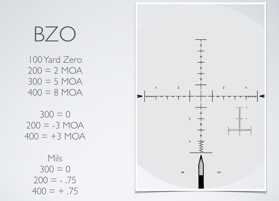

Generic numbers but close enough, what do we think that the first gap is in the center of the reticle on all 4 sides, bet that is pretty close to right.
I disagree with @Lowlight partly on this one. I do agree with him on the OPs case just not for most hunters as the need just isnt there for these tactical scopes.
For a set it and forget it duplex scope in the SFP zeroed for 200 - 300 yards will cover most all hunting needs.
If the hunting and using a scope with exposed turrets that are meant to be dialed then sighting in at 100 yards is probably ideal. This is what I do if I am hunting with one of my FFP scopes. I usually dial in .5mil and just leave it there. Point and shoot solves most every hunting shot I encounter. The few that are further then I can and do dial to make my hits. I could dial every shot or hold a number even for the closer shots but the two inch on target error at most makes absolutely no difference.
