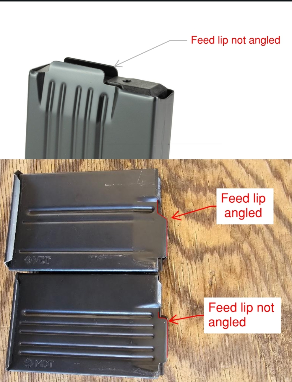

Make sure to get the 4 rib ones. They aren't on their website yet but you put that in the order notes. I ran the standard ones with my dasher and the round would come out early and the nose of the bullet would tip down and slightly bind. They would feed but needed some bolt finess. I swapped ti the 4 rib and they have been flawless out of the box
Thank you!!
