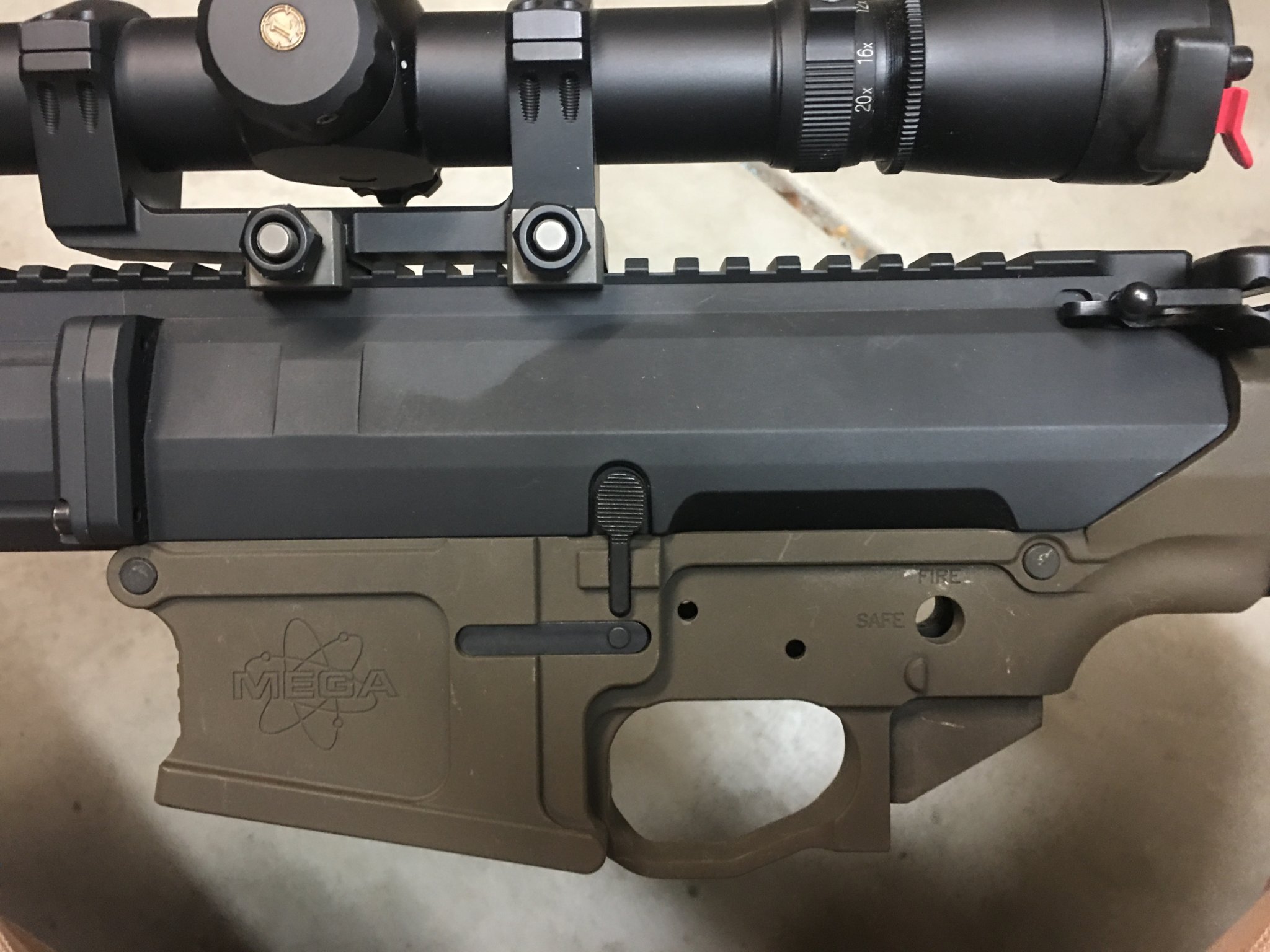

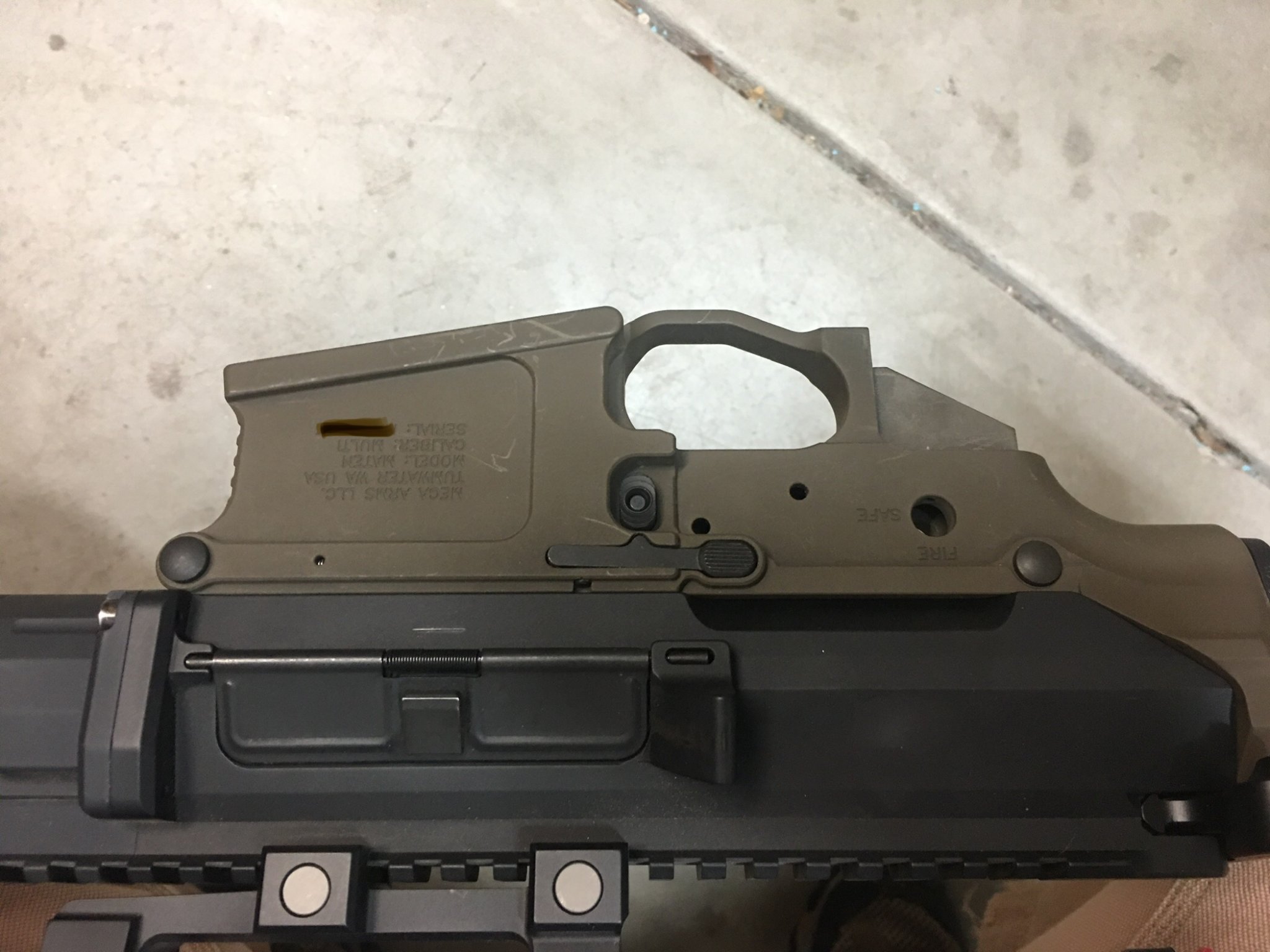

    Hi guys! I have an SBRed Zev Tech AR10 that I run a 12.5” 308 barrel out of. It is a blast to shoot, literally. I have the itch to build an upper with a 18” 6.5CM. Zev is a pain and won’t sell just stripped uppers, so does anyone know if the LMT’s, KACs, Centurion, etc. would fit? You can see the fit between the upper/lower in my photos below.
    Zev bought the Mega Maten line, so I would like any Mega lower could also be used as an example. They have the slant vs. curved DPMS lower to upper fit.

    LaRue UUK will fit on Mega MATEN lower.
    Tight fit, very tight.
    Armalite upper almost fits but pins won’t fully go home. I have a “B” series Armalite, you’d want the “A” series. I do not have an “A” series to fit check with.
