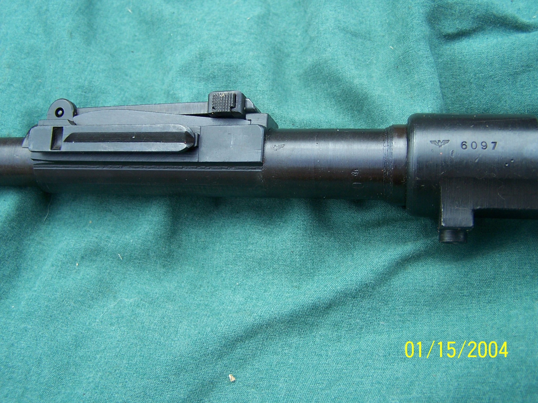

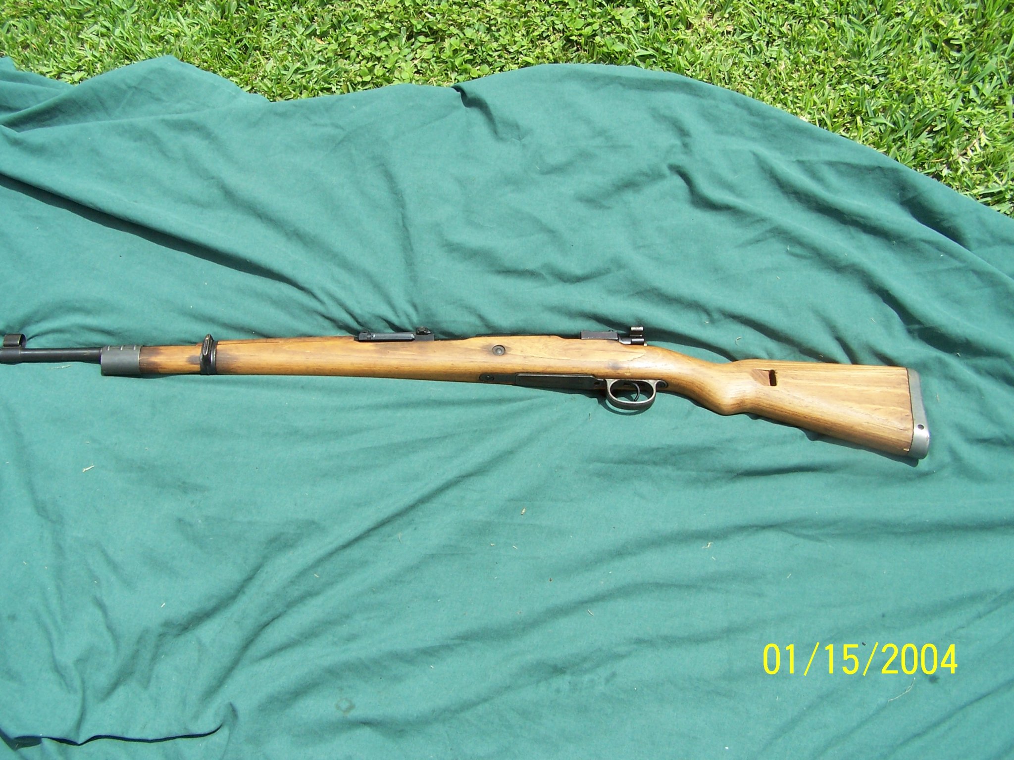

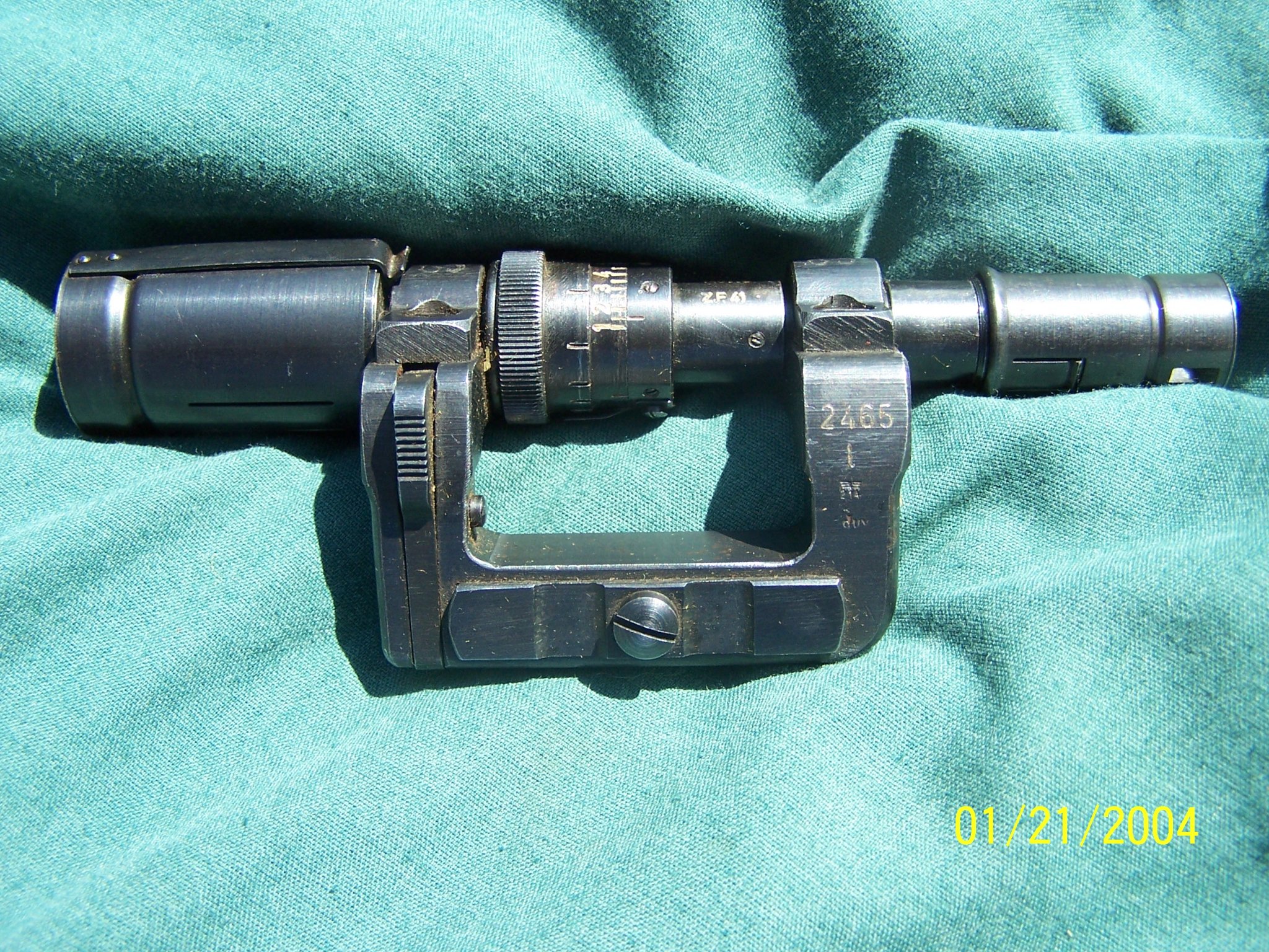

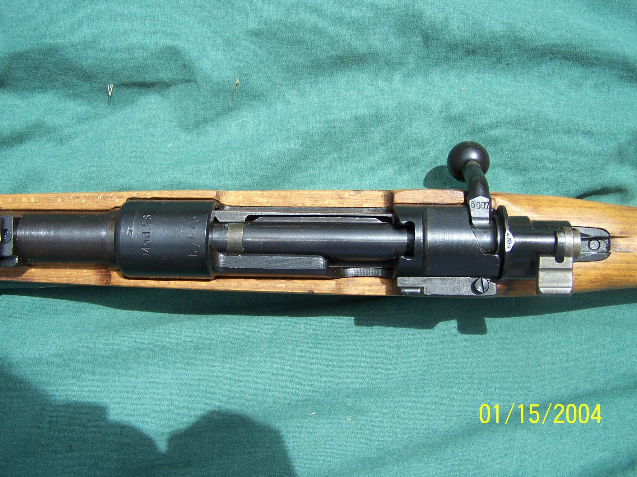

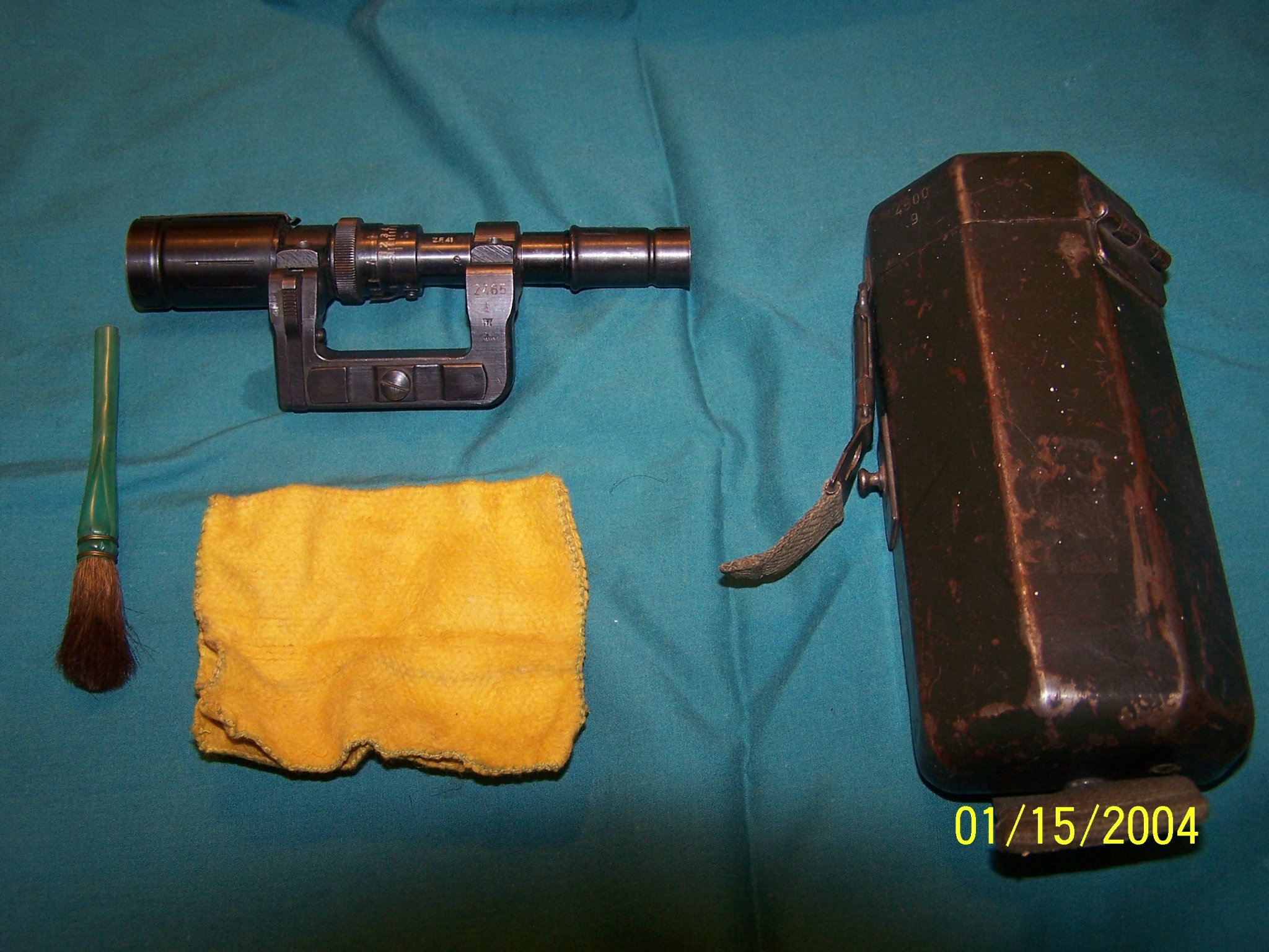

This BYF45 code rifle with ZF41 was an attempt by the Germans to extend the range of an above average marksman. Issue began in 1941. It was a dim, complex little scope with long eye relief that attached to a dovetail machined into a special rear sight.
The example shown is a vet bring back captured at the Mauser factory. It has an emergency derivative white glue laminate stock. ( normal stocks were glued with a phenolic red glue that was much stronger). It is also unusual as it is one of several guns known to have been struck with a broken firing proof on the left receiver ring. There are now many fakes on the market. Very few matching rigs exist. The numbered scope came in a numbered can with accessories. The brushes are very scarce. Pictures aren’t great it’s buried in the safe.

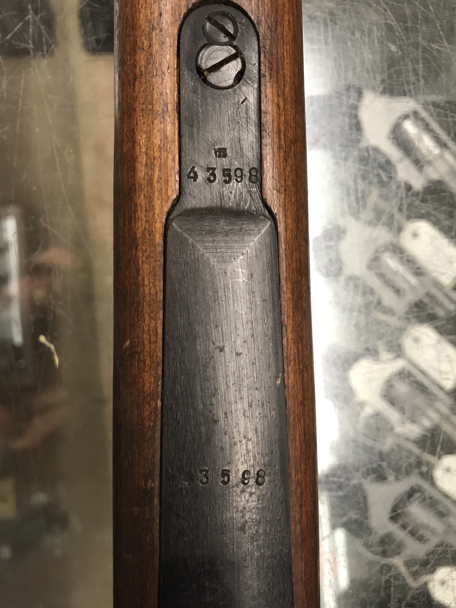

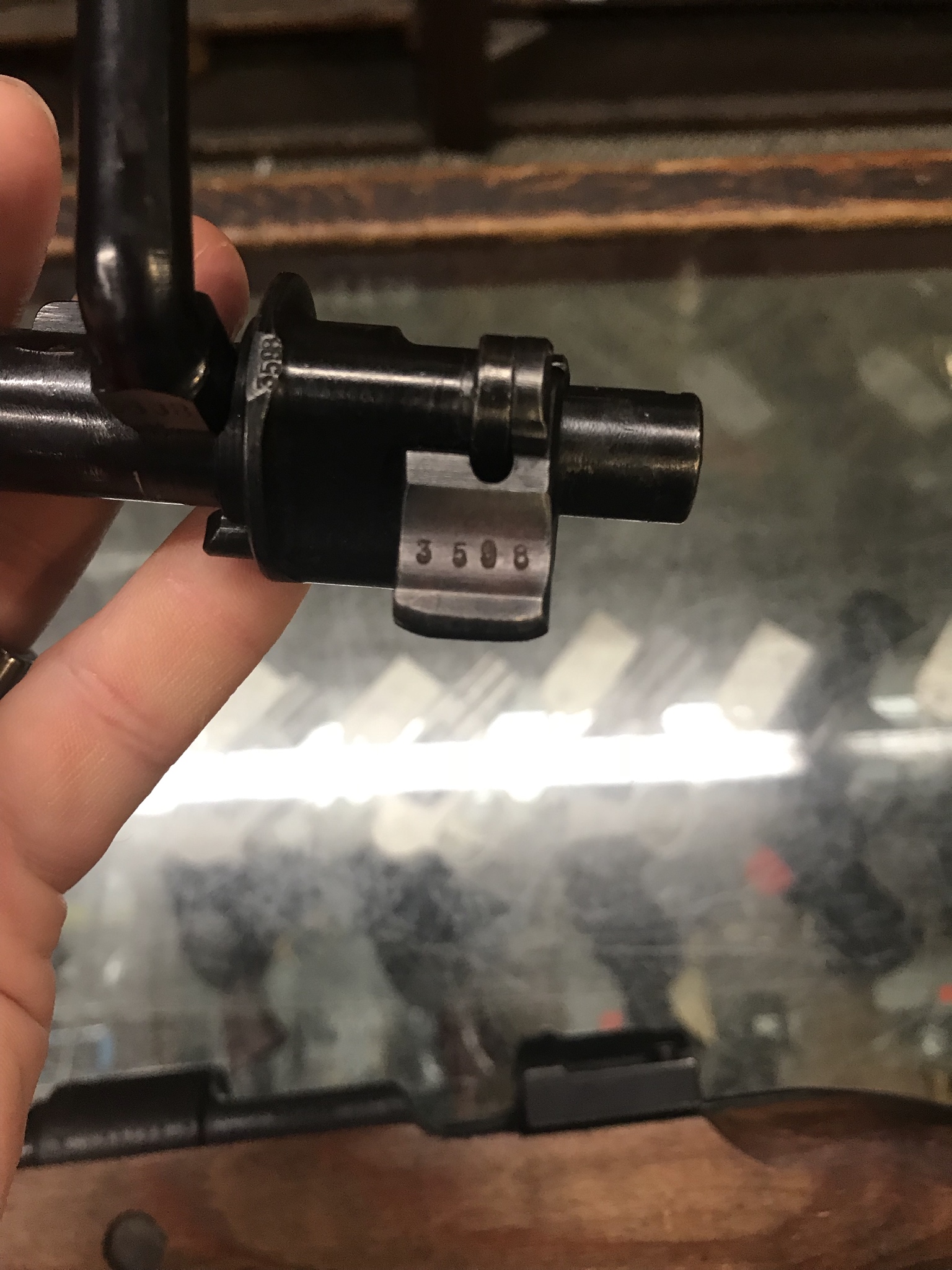

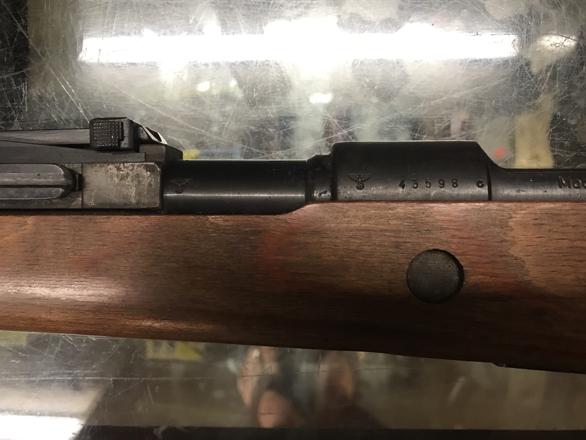

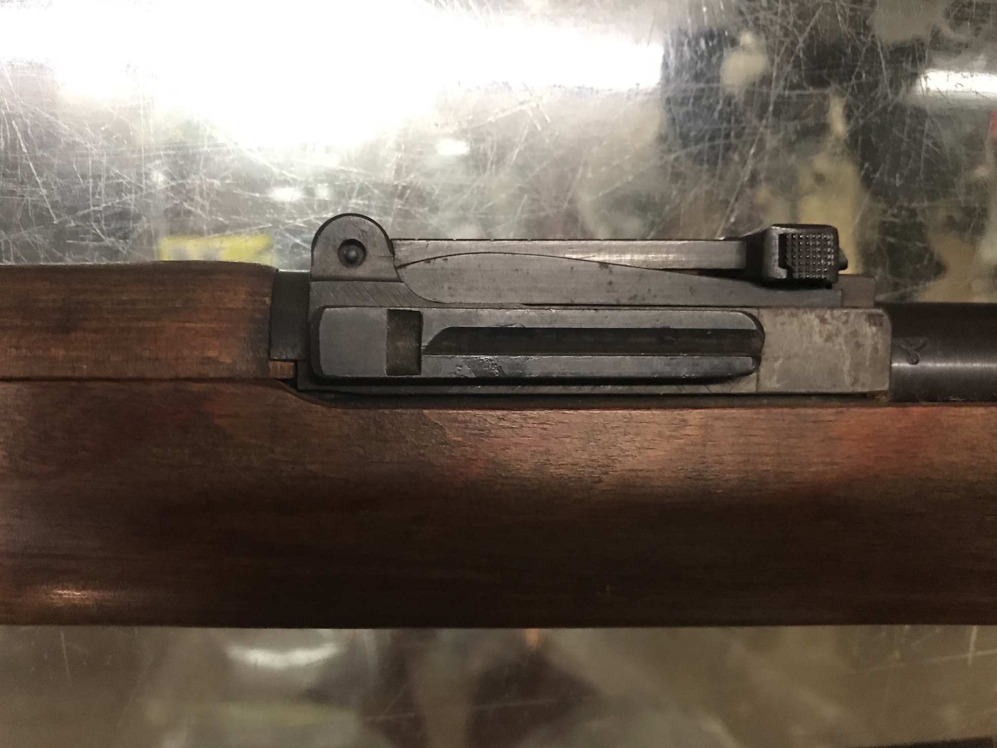

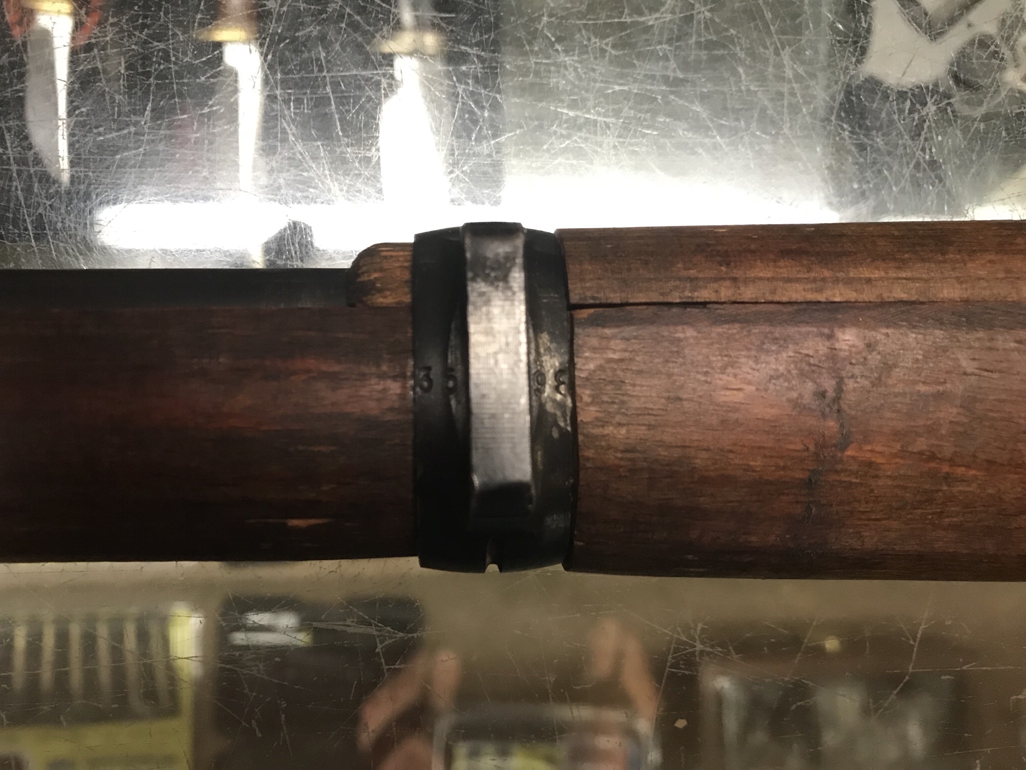

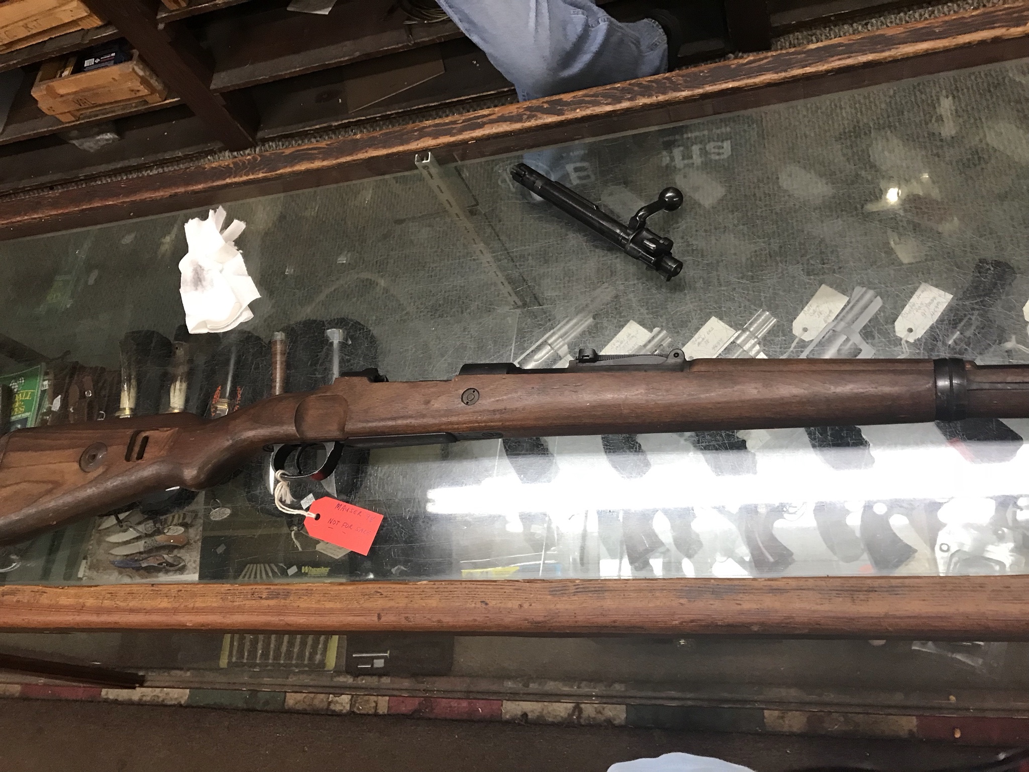

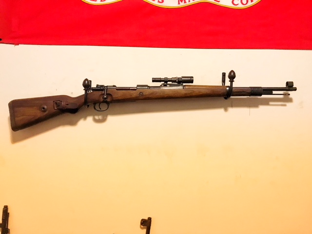

Here is a picture of my BYF44 ZF41. Amazingly I found this at one of my local hardware stores about a month or so ago. It's one of those old school hardware stores from like the 60's that's ran by good ol southern boys that sell guns as well that you just don't really find anymore. I was amazed to find it. After inspecting it, every component of the rifle was all matching and I did not hesitate to buy it. Unfortunately, it was scopeless but I found an unnumbered mount, can, and the scope for all a pretty good price. I have an original sling on the way. It is most likely a GI bringback as it has a duffel cut right behind the rear band but you can't tell. It's in great shape and a true survivor.

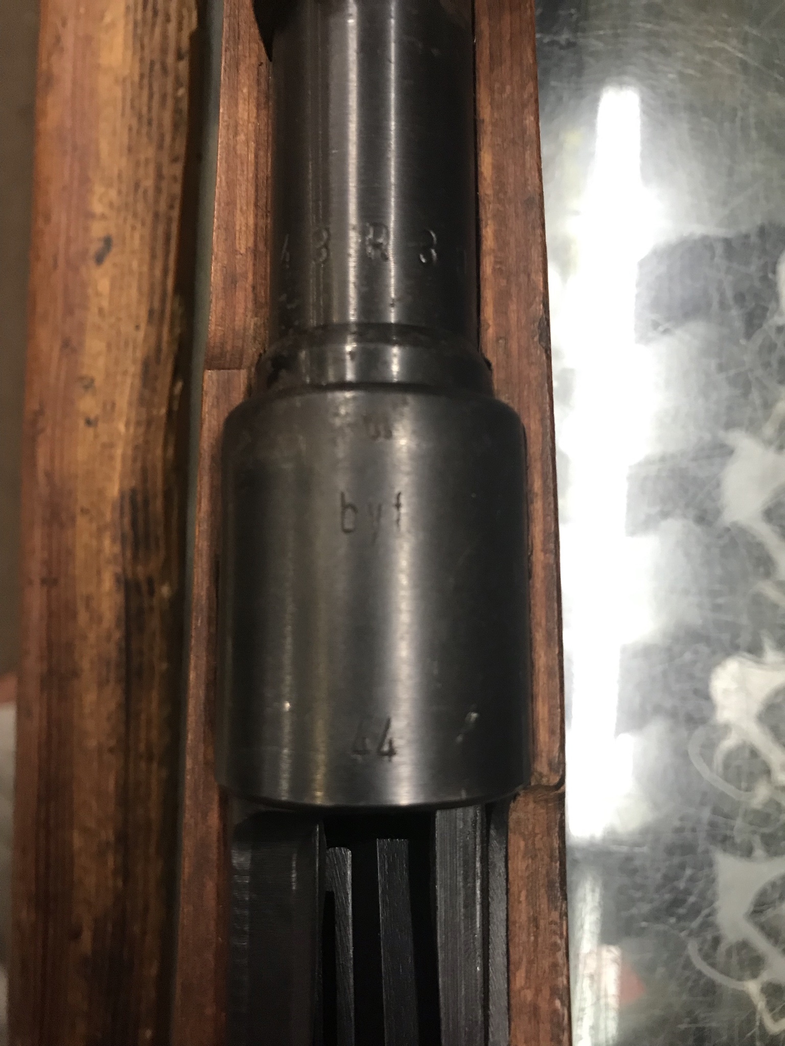

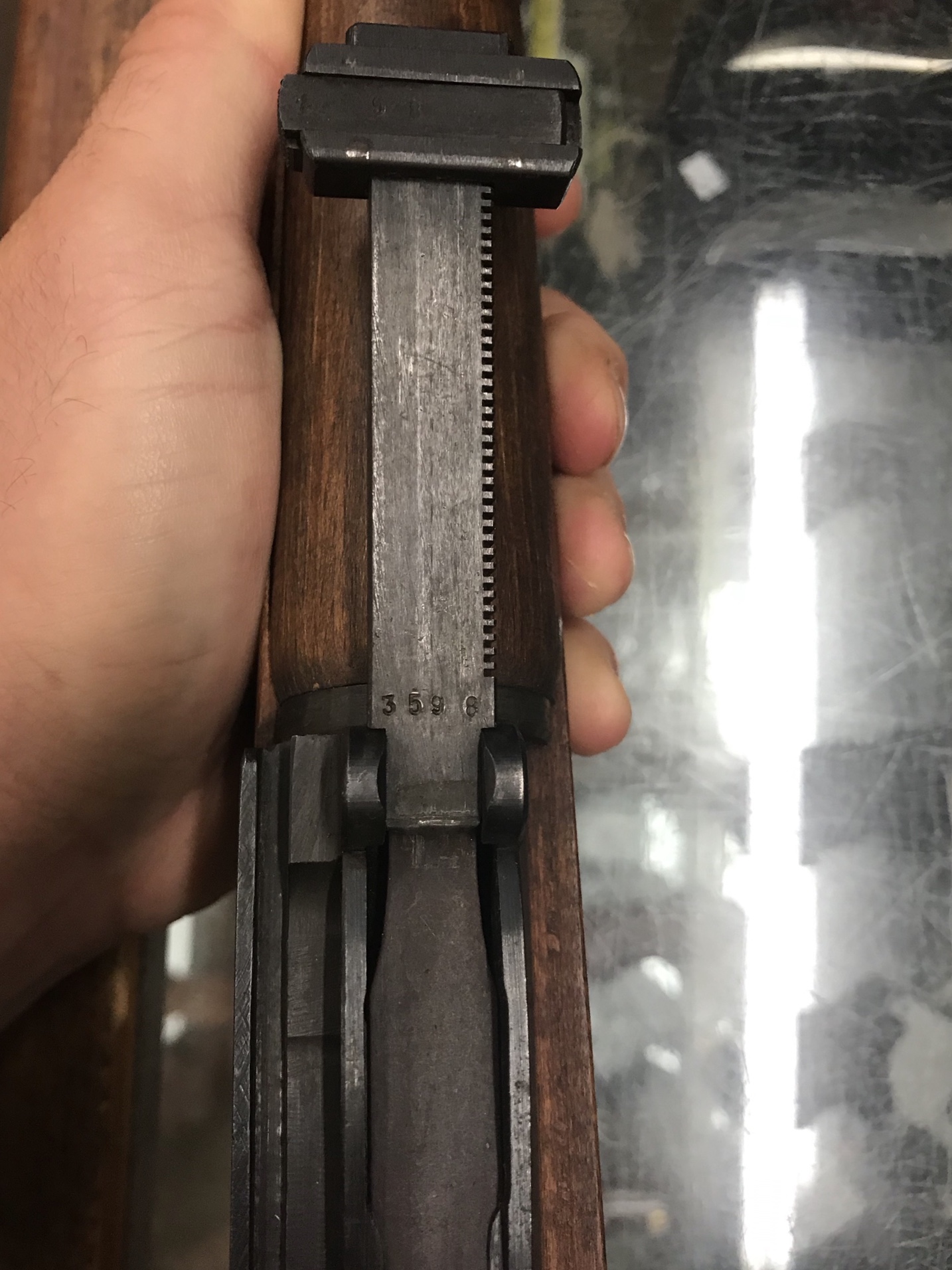

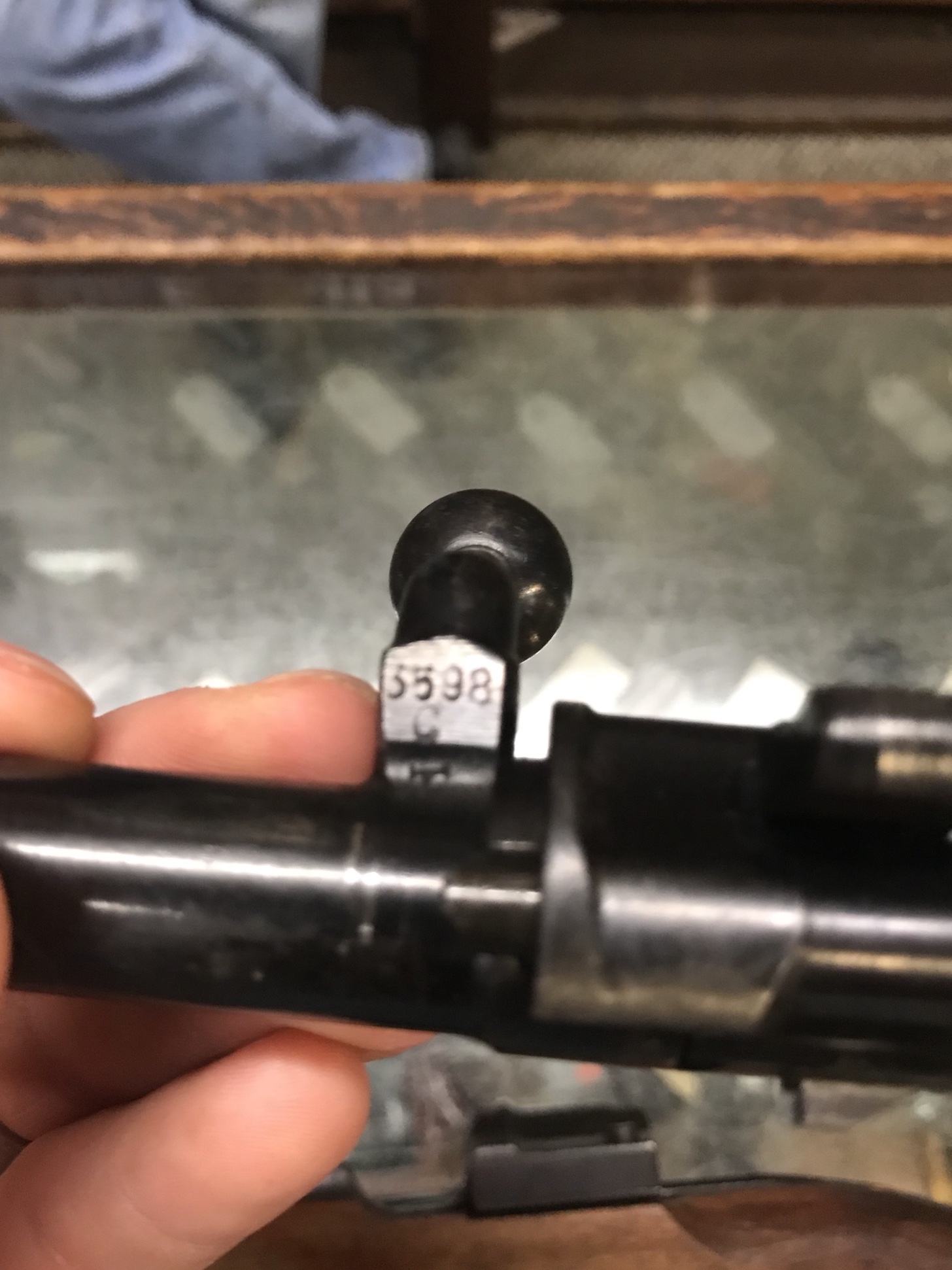

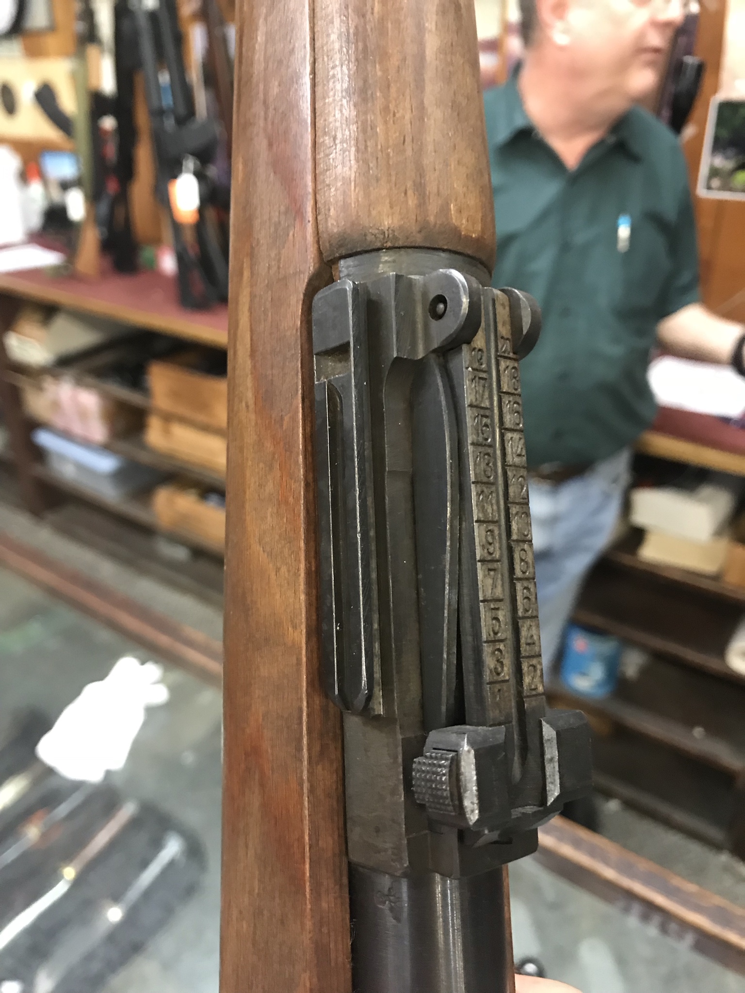

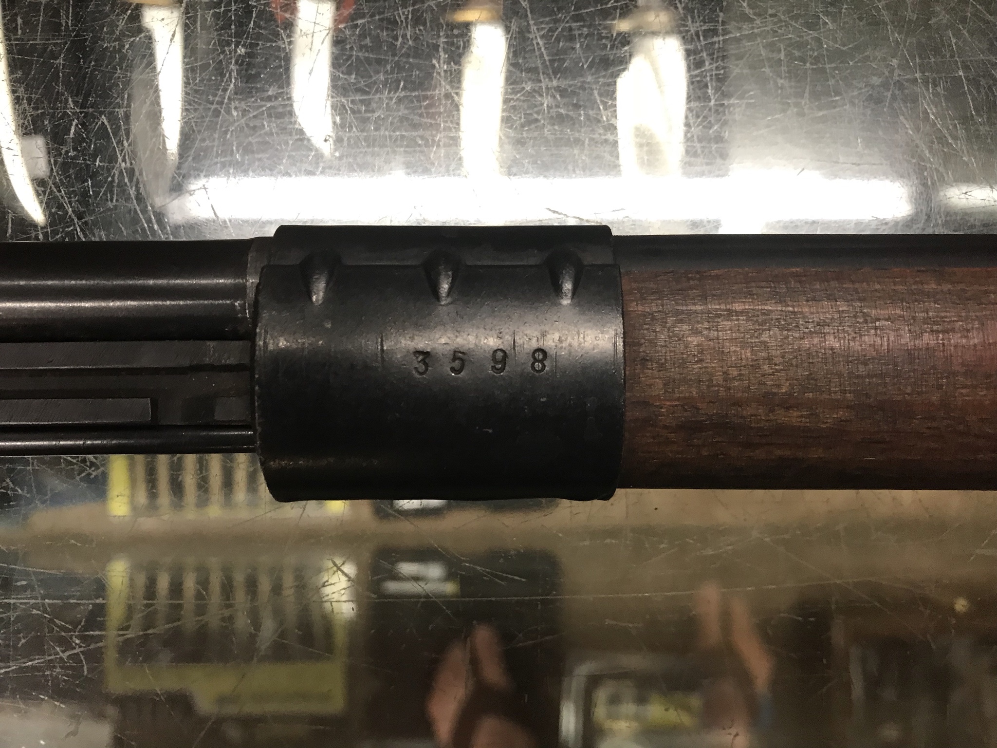

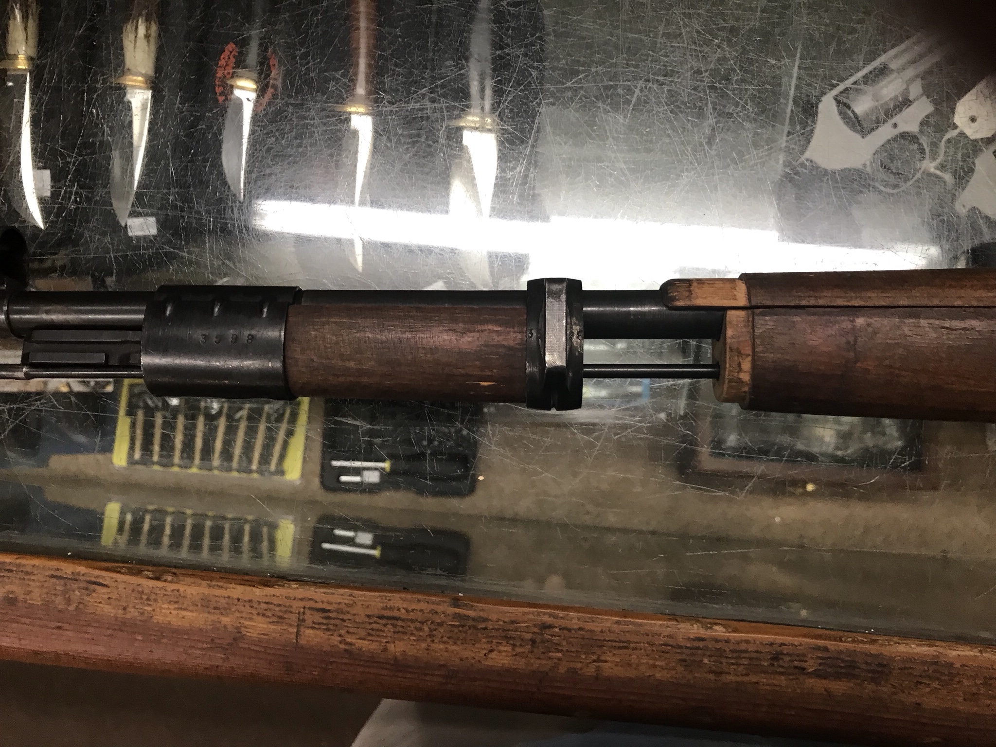

That is an unusual find for a hardware store! Can you show some more pictures like the receiver code? There were some rare makers like AX, AR. Please share what you can.congrads!

Yeah pretty awesome old hardware store. You don't find em like that anymore. I couldn't break the rifle down there at the shop but they assured me all matching and my family and them go way back so I knew if there was a problem I could come back. But...broke it down, everything matched. Stock, handguards, firing pin, sight (even the sliding part of the rear sight), even the trigger matched with "98." The scope base also has the correct waffen code for BYF (you can see it in the 2nd pic) and the stock has the proper cuts for a factory ZF41 so you know it definitely isn't some bubba job. All in all, I walked out of the shop with it for $1450. Spent about another 800 and found an unnumbered can, unnumbered mount, and a scope with crystal clear glass and its done. I do have an original sling on the way.

I was about to ask how much you got it for, then read this post. For that rifle in that condition is a pretty good buy. Most thought it was top dollar a few years ago, but it won't be long and it'll be pennies on the dollar. The rare ones are even rarer now as most are in collections. And, the ones we all saw stuffed into cardboard barrels selling for anywhere from $29.99-129.99 are all gone. A lot of gems in those piles. Just not many knew it.
Anyhow, nice find! Glad you were in a position to get it. If you get a chance, we'd love to see it on the range and some groups out of it!

That is a very nice example. Looks almost unused. Nothing fishy. These guns are highly faked as are the scopes , mounts and even cans. The scopes are complex and dim . Reproduction adjusting tools are available on eBay for the scopes.
If you have a scope and wish to zero it to the rifle I can tell you how! Good luck
I will add this on just in case I don’t get back for a while...
to adjust the ZF-41,remove the front sight shade if present. The objective has a slot on the front on each side. Using the back of a butter knife, loosten the front objective lock ring about a 1/4 turn CCR. Twist the sleeve on the objective barrel to expose the screw holes. Remove the screws to reveal the adjuster rings. They are eccentric adjusters and can be rotated using finish nails of the correct diameter. One for up and down, the other from side to side. Using the factory iron sights at a known distance, and rifle placed in a suitable stand. Match the center post in the scope to the iron sight by moving the adjuster rings. Slowly tighten the front objective ring and verify alignment with iron sights.
That was 1/4 turn CCW. This procedure is similar to bore sighting and assumes your iron sights are close. You can fine tune with live fire. Many original scopes have lenses that have turned very cloudy. There is no practical way to clean these. This tiny scope contains 12 lenses, some of which are glued together. The glue turns opaque rendering them useless . The repop scopes may at least be clear while new and adjust the same way.

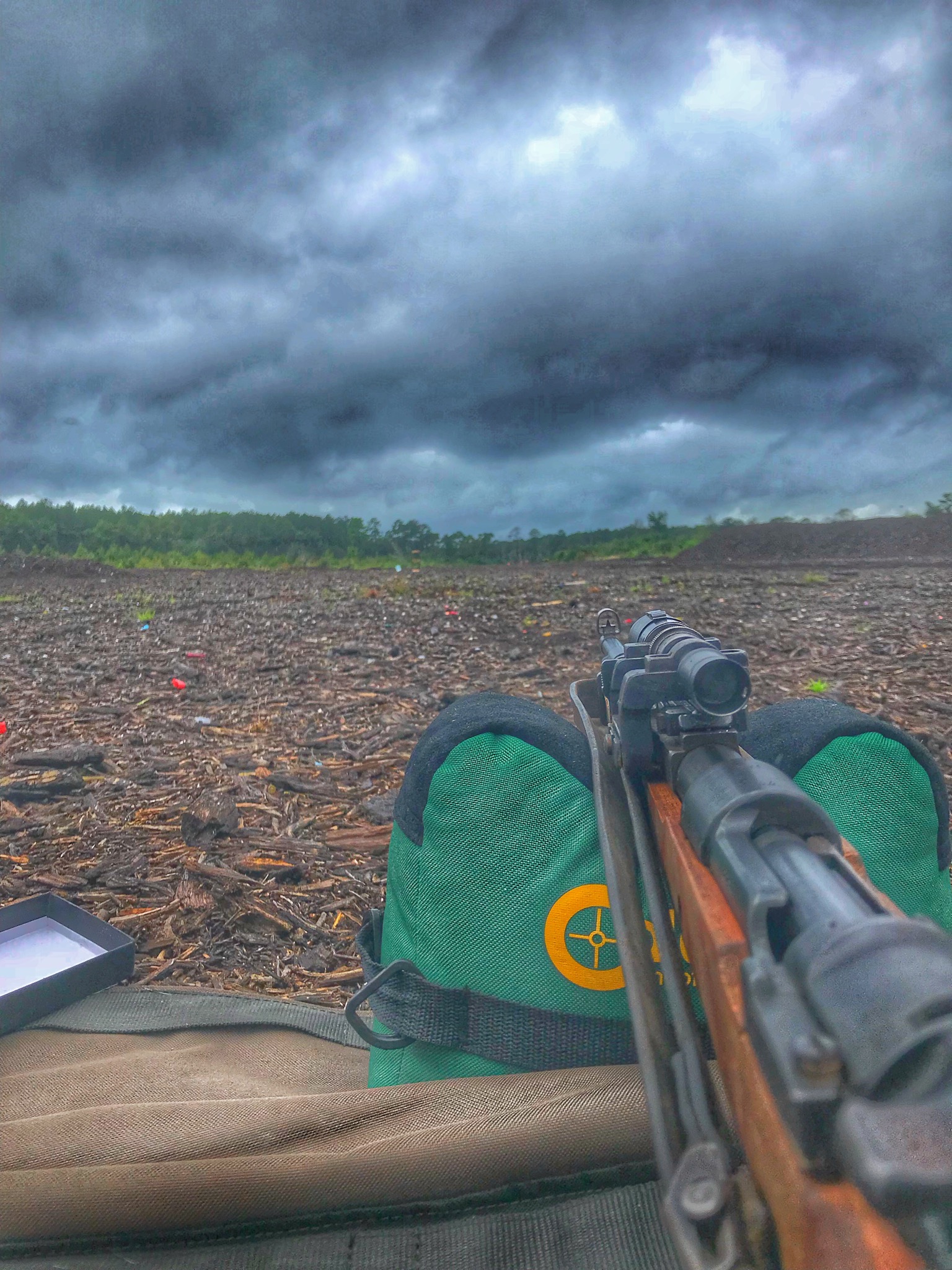

All, I finally got the rifle sighted in. Yes it was a pain in the ass. But finally got it done. I was ringing steel consistently at 200 and 300 yards no problems. A lot of people say the ZF41 is crap. I disagree. It made target acquisition much faster and easier.

This begs the question as to how good the training was on these rifles before they got issued?
I've heard a number of good shooters say they shoot fine. I've shot them, and they shot well. Scout length scopes aren't my thing, but with some shooting them, you can learn to do well with them.
