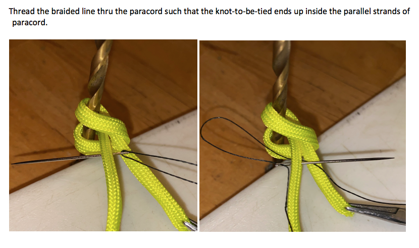

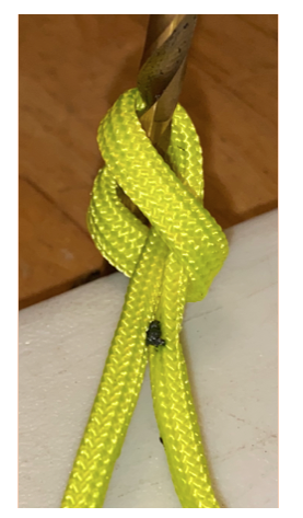

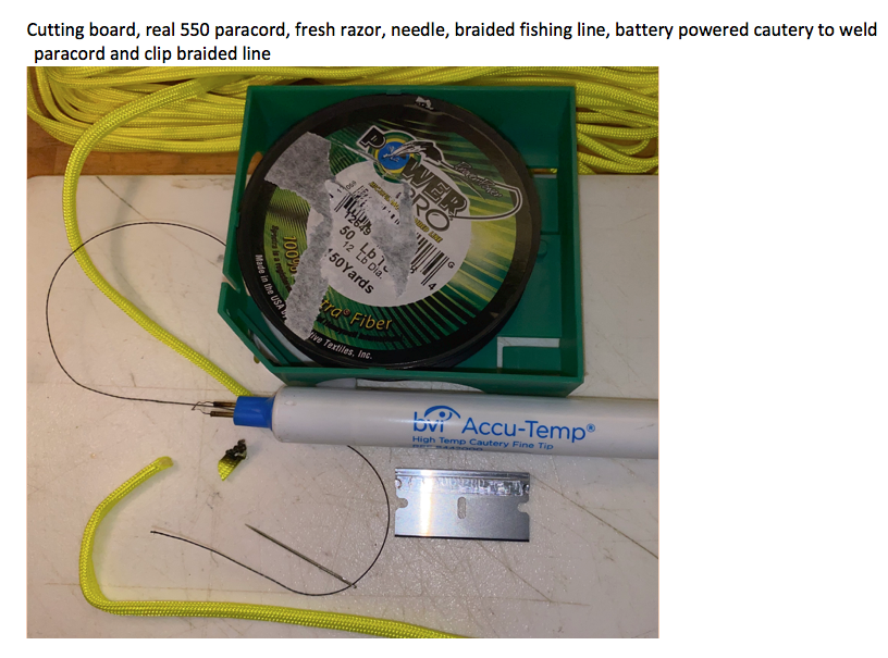

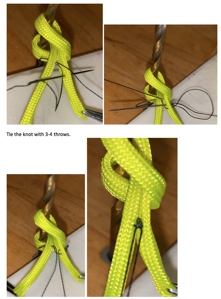

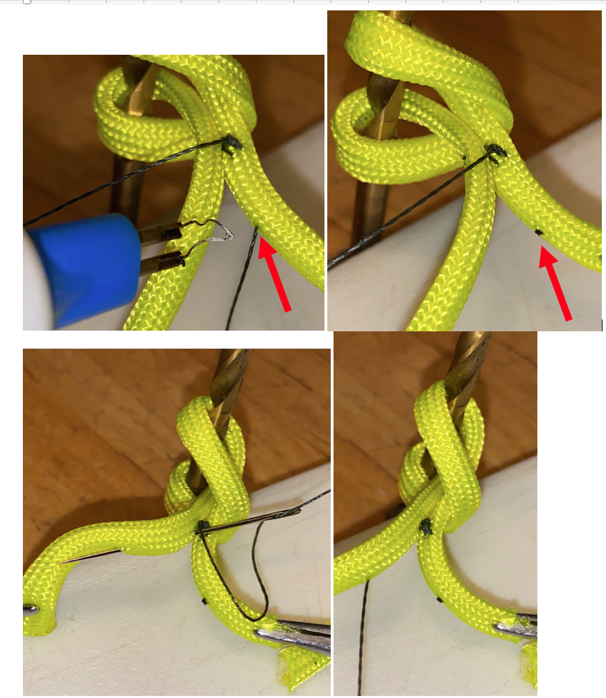

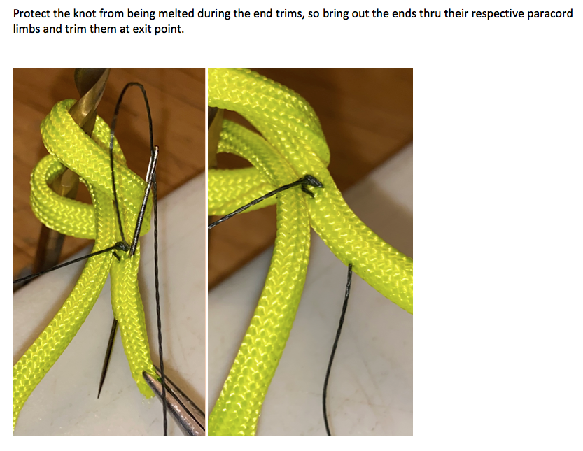

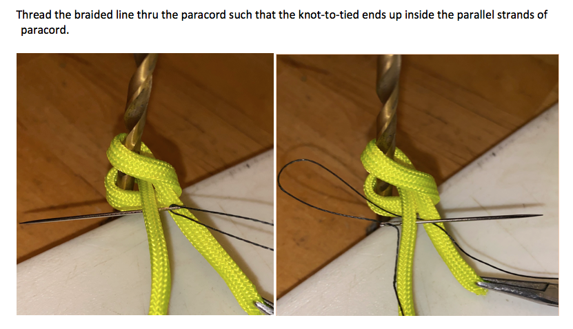

    I use the 550 as well, alot on packs, scope bags, drag bags, soft rifle cases yadah yadah. I like to fix the paracord strands so there is not a unsightly bulky knot as well as they always stay even and prevent the knot loop from changing size, particularly on sling set ups where there is little room to actually tie a small knot that will hold. The battery powered cautery can precisely divide the braided fishing line and weld the free ends of the paracord without leaving any flame marks that occur with a flame source. I will now burden the audience at large with how I do mine to keep the pulls nice and tidy appearing.

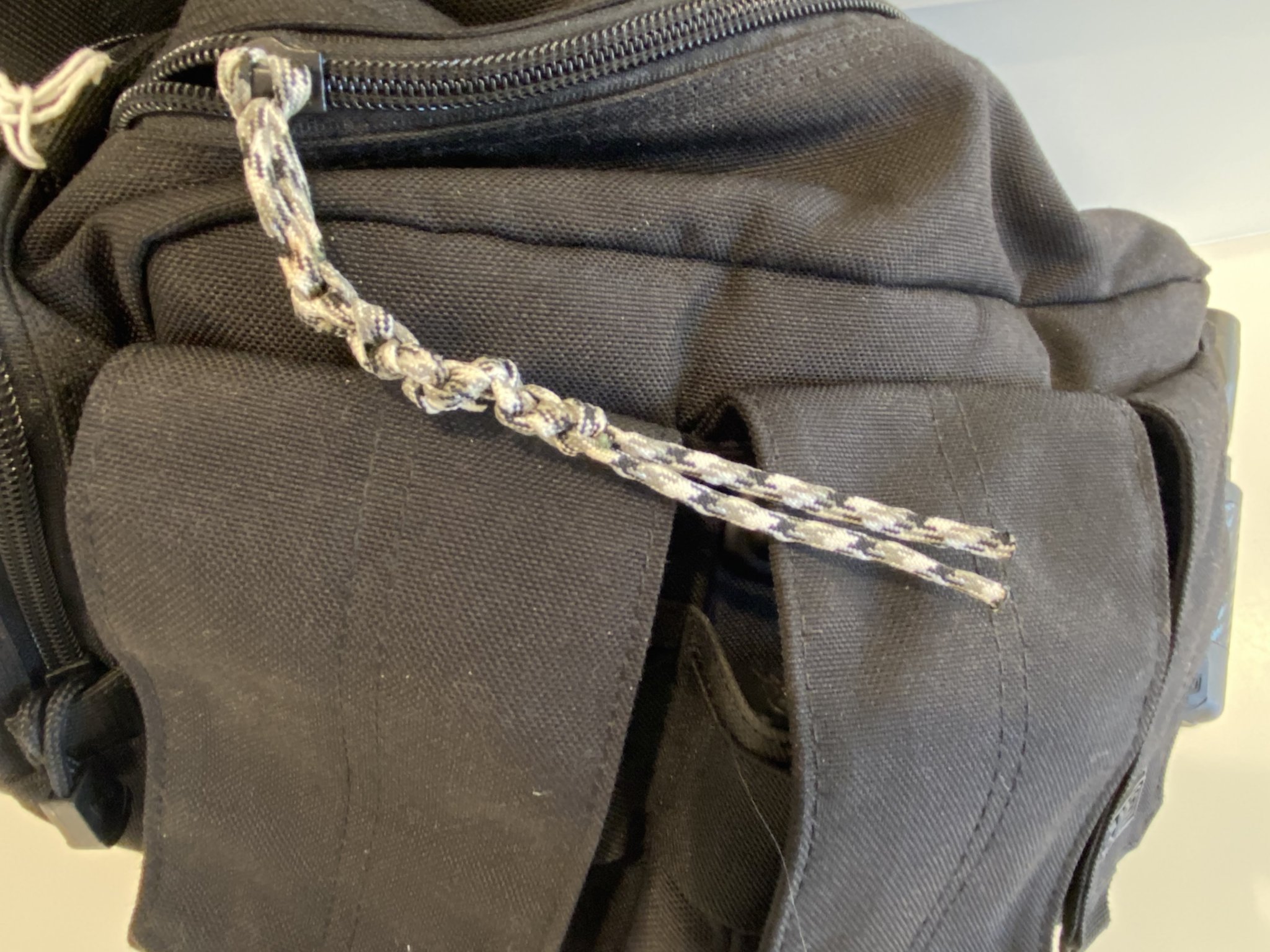

    Also , as a general rule for me when fabricating the pulls I leave the ends free i.e. don't create a loop that can snag on everything Murphy's Law says it can.

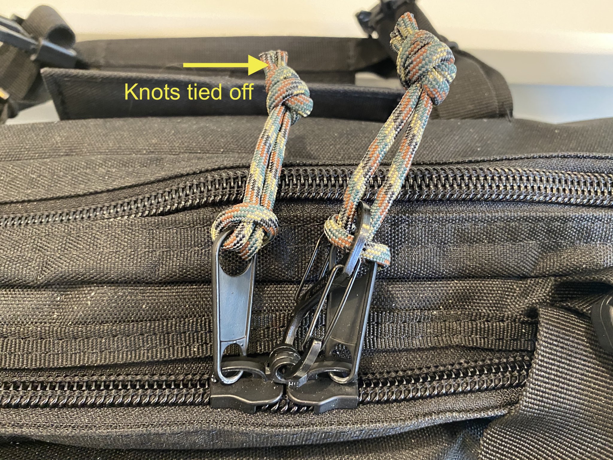

    I have had half a dozen of the aftermarket pulls fail me also, just to paracord now. Always. Cut off any pulls they come with and replace, often just because of color! I don't need to be so camouflaged I can't unzip my bag. So, contrasting camo color. I do similar for many bags, replacing clips with color or style alike ones so I don't clip the pack together wrong, can find the proper strap in low-light, etc. Like this:
    Um... I don't seem to have a photo of a redone zipper, somehow.
    All my bags, etc are covered in enough other snags, I do a loop on the end also, so I can hook it with a finger to open when cold, tired, stuck, etc.
    Knots alone are fine. Anything will do, all the way to single floppy loops, but I like tying into the pull. Mine look like the Knots Tied Off photo above.

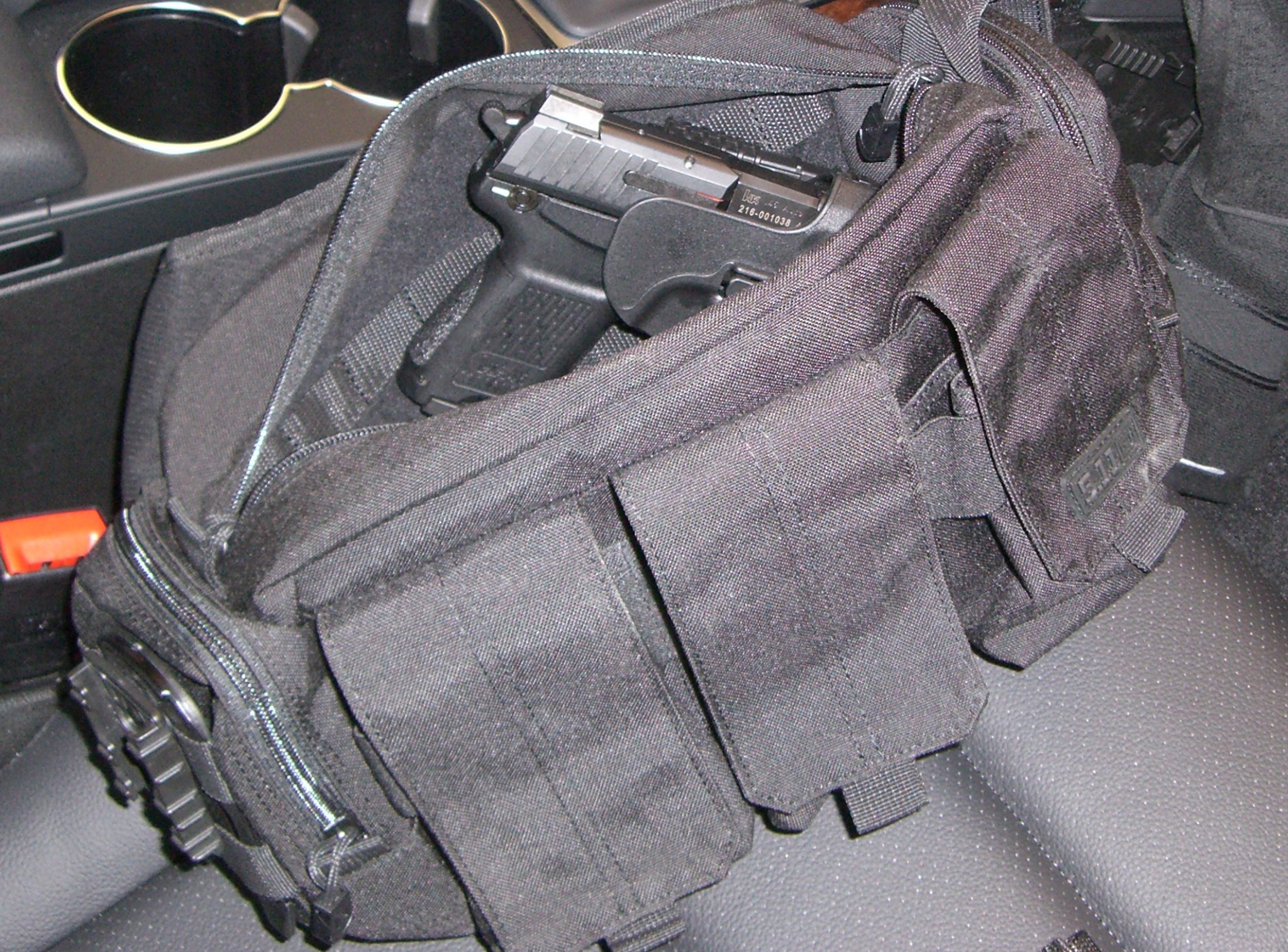

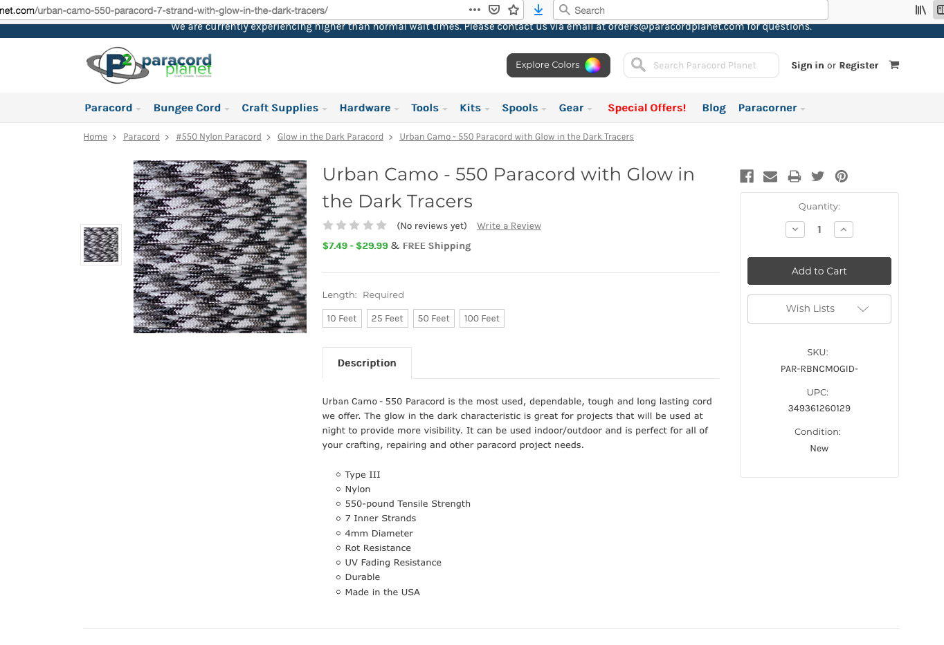

    Speaking of low light (no relation) conditions I used some of this 550 paracord on a small arms soft pack to better identify the zipper pulls when the
    interior lights of the vehicle have been suspended. It actually works pretty well.
