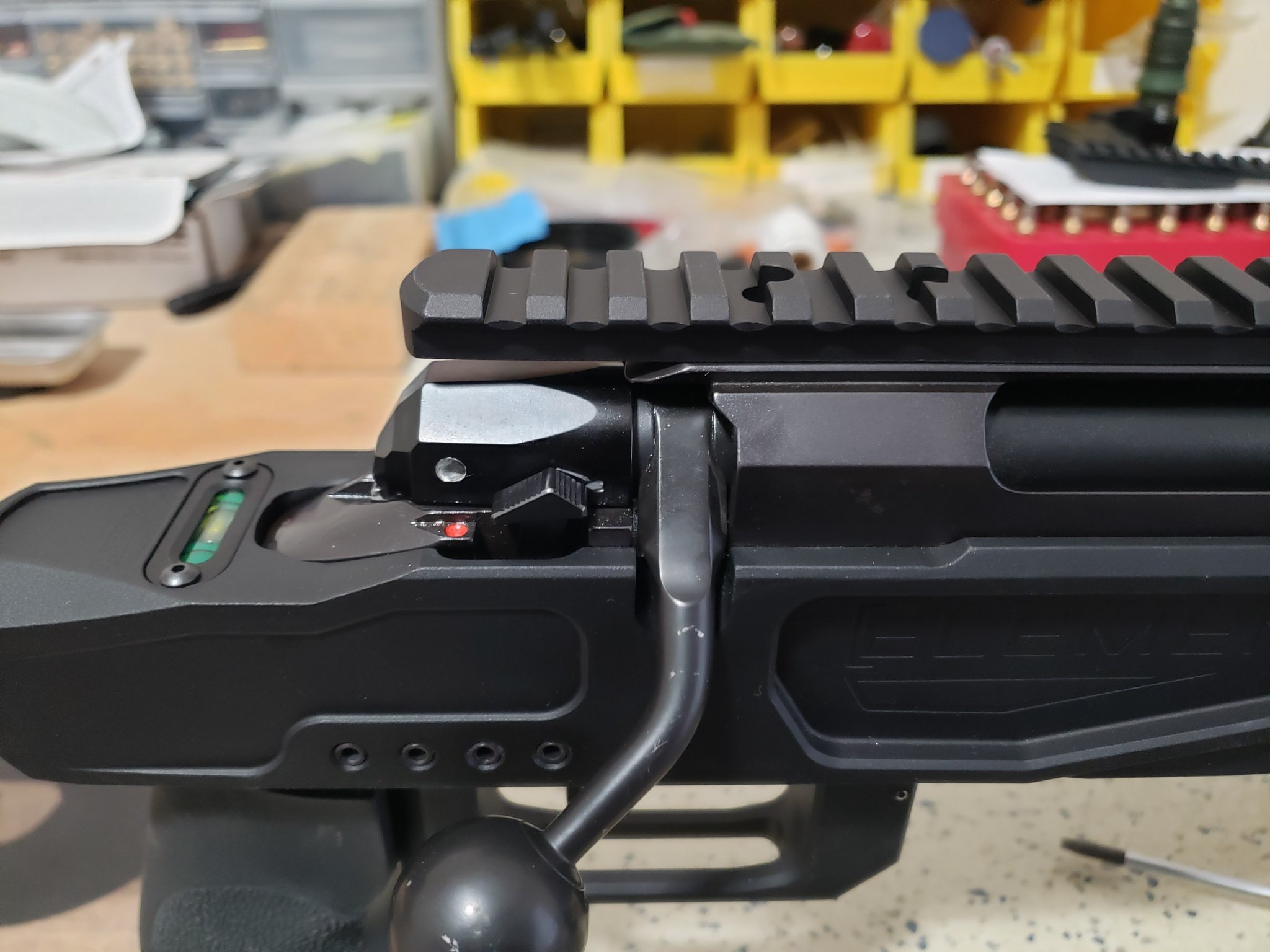

Buy the cheap EGW Tikka scope rail (without recoil pins) and mount it backwards. It will get your optic further back. Even further back than the Mountain Tactical thermal rail.
