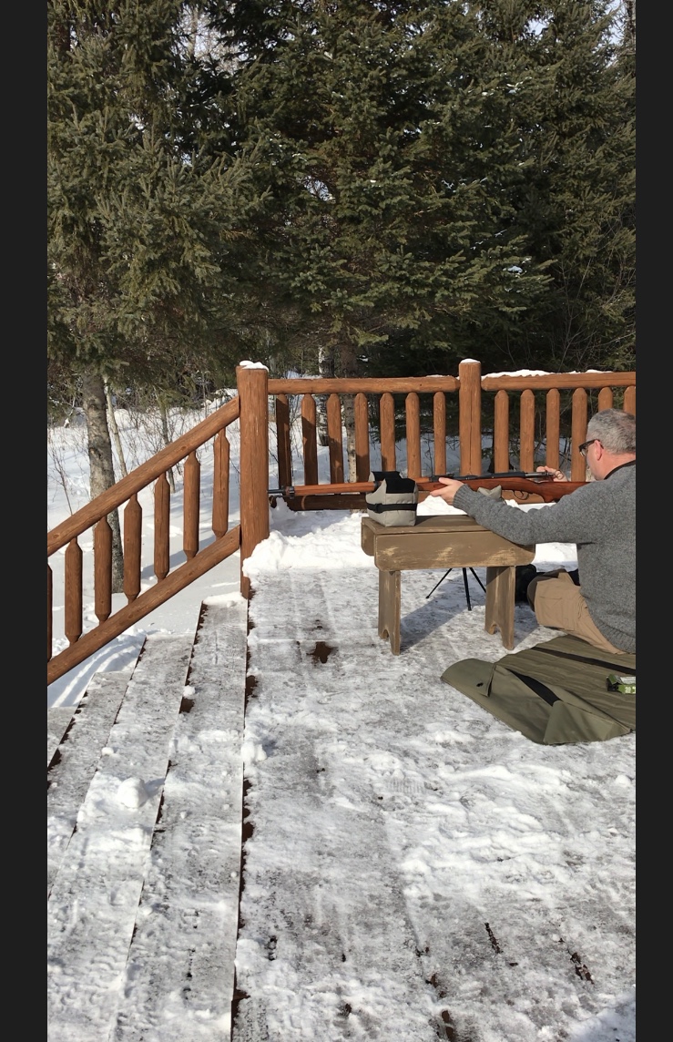

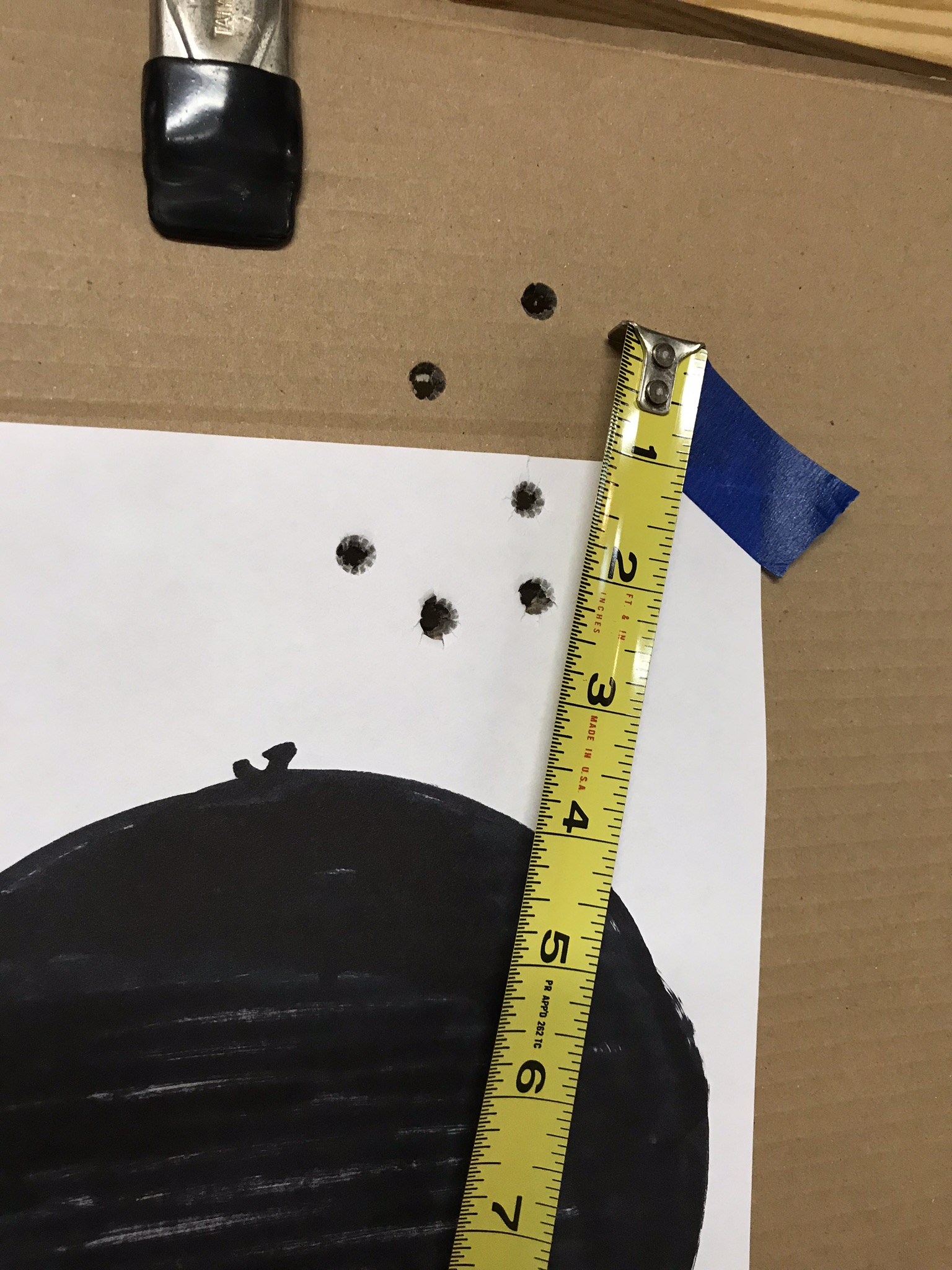

Will take the G11 out tomorrow. Only factory ammo available was Herter’s/PPU 165gr BTSP. At least I can function check. Good news is the shop also had some R17 which I never use for .308. Picked some up. I have quite a supply of the Remington 165gr PSPCL you mention, also a large quantity of the 175SMK which is what I feed the .308. Dies and cases next week, along with your sight if things go well tomorrow on the short range. The bore is spectacular for a 102 year old gun. Gun is a #419XXX which appears to be 1916-ish. A tag was under the stock from a gent in Zurich.

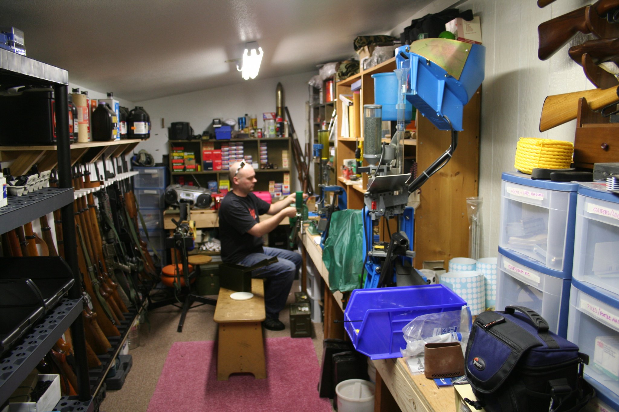

This is the reloading room at Swiss Products. I think there are 5 or 6 presses. Can't remember, but the one most used for accuracy and long distance shooting is the Forster.

Well that was a hoot and a big success! Off-the-porch 100yd range. A couple rounds for functional checks and initial case inspection, then it was on to the steel. No issues making a palm sized group on the plate without much even trying. Last 6 were onto paper to see how it did. A tad under 3”. Not bad since I was sitting on a wet deck, not the best rest, and 56yr old eyes. Next step is to do some case measuring, some throat measuring and order that diopter sight! I’ll give you guys a ring next week to assure I got all the proper bits ordered up.
I have a .308 and a .300 that are my stress relief. Enjoy the optics and precision that goes along with it. Dinging steel way out there with iron sights is next on my list.
Well, get in the %&#@) prone with a couple sandbags under the front and a good Tab rear bag. Lay a blankie down first so's you don't freeze to the deck and then have a go at it.
Still nice shootin'!:)
Lol. Yea, turning into a wuss as I age. Come to think of it, I do have some moving blakets stashed in the back of the truck. ? I got all those goodies for the scoped guns. Just didnt bring them along. Hell, I wasnt even sure I was going to find any ammo on the drive north. It was a satisfactory go IMHO. Detail strip and cleaning, then get serious with it. Its a wonderful little rifle.
I had just removed a good 2 1/2-3’ of ice and snow off that deck so I could plop my aged @$$ on there and shoot. Hadn’t been up there since before the Holidays. The wife would have just shook her head and gone about her business... Did I mention I had to snowshoe the plates and target stand out there too? Uphill. Both ways.
Anxious to nail down a load for this. I think it will work quite nice.

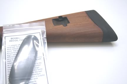

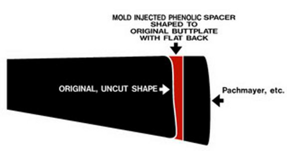

The Butt Pad Adapter follows the original contour of the stock and allows for the use of a recoil pad. The original purpose was to make LOP (length of pull) better for longer American arms. The Swiss, as a people in that 1800's to 1900"s era were of a shorter stature than the average American, so we gave it the option of a 1" to 2" LOP advantage.
