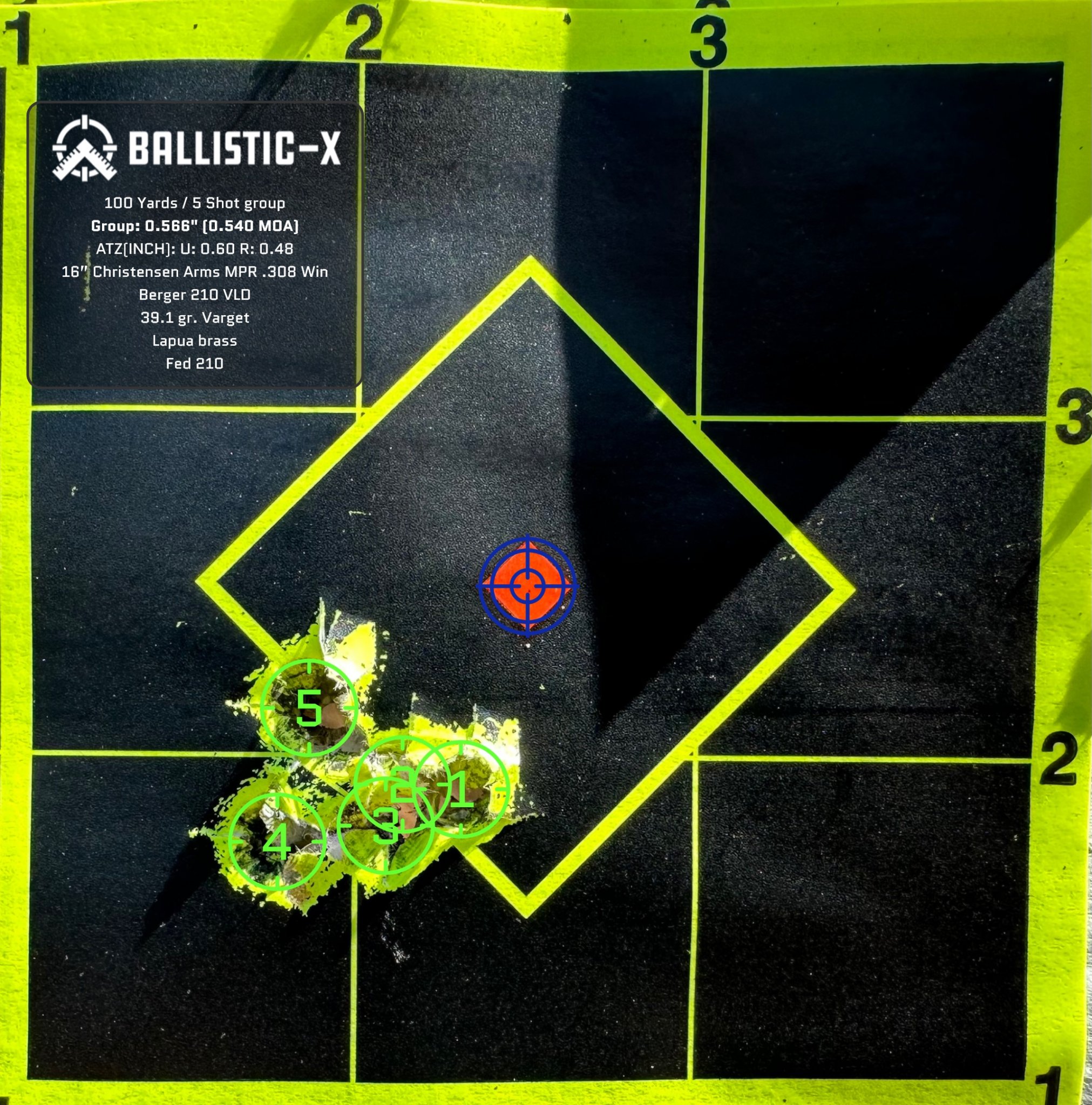

Get some Lapua Palma (SRP) .308 Win brass, and some Varget, and a CCI 400 primer, and you'll be set. I load for 39 grains of Varget and seat them to where they fit and feed in the mag, and they run great.
My 16" Christensen Arms MPR .308 with a 1:10 twist loves them, too...
Ballistic-X-Export-2023-04-30 15:54:56.390625.jpg
