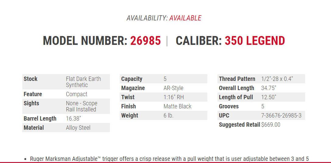

All 350 Legends come threaded 1/2-28 and that's a .355 bore so I wouldn't think doing a 1/2-28 on a .243 would hurt anything other than not matching the adapters that come with bigger bore cans .
Reactions: WB300
That’s funny, my 350 legend was 5/8-24?
Reactions: powdahound76

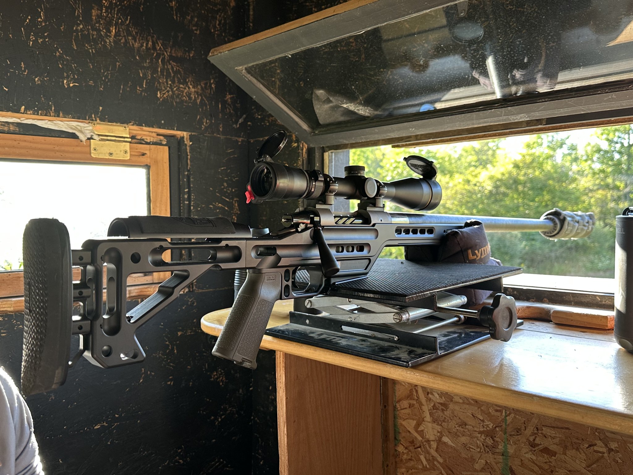

There is also the possibility of a face mount muzzle brake.
Thunderbeast cb brake on my Tikka T3x lite. Muzzle diameter of 0.616". Threaded 9/16 under but uses face of muzzle as shoulder. Installed and threaded by Thunderbeast.

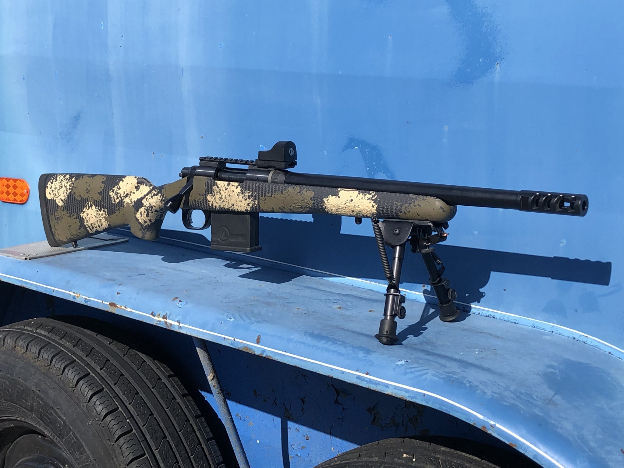

Funny thing is my grandsons 350 is 5/8-24, just the way I threaded it . I didn't say 1/2-28 threads were the way to go just making a point some factory guns come with 1/2-28 threads so the wall thickness must be safe.View attachment 8248164
The issue is that you posted "All 350 Legends come threaded 1/2-28", which is factually incorrect, even for off-the-shelf factory barrels.
